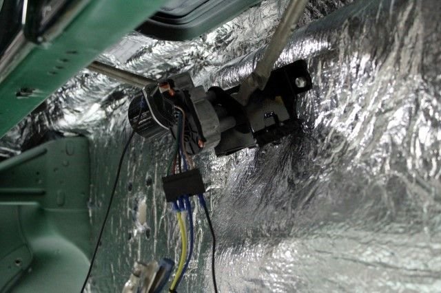

Firewall and up under the dash all done
Battery cover
kick panels are fitted in but not glued yet, I still need to drill some holes in the door post and door for my wire looms..
I also installed the Newport Wiper motor and linkage to the wiper pivots and gave them a test run..
