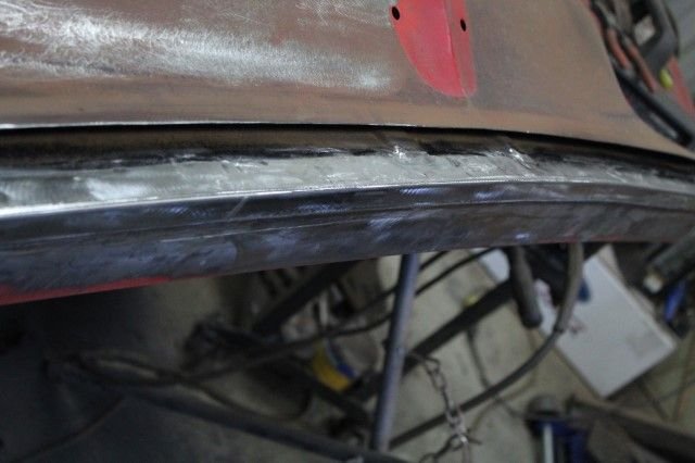

From: northwestern Ontario
The front lip of the hood was see through almost from corner to corner, I was late bringing the camera out to the shop but the outer skin was cut of to expose the rust through that was underneath. Here shows where I started to cut it out.
I bent this piece up and used my shrinker to shape this for the patch under the hoods outer skin.
Began welding it in one spot at a time.
Once all the welds were done I grinded it all down to clean it up.
This is where I left off yesterday, not quite finished but this morning I finished filling in the welds.
Cleaned up the welds and I'm about to fill the emblem holes next.
