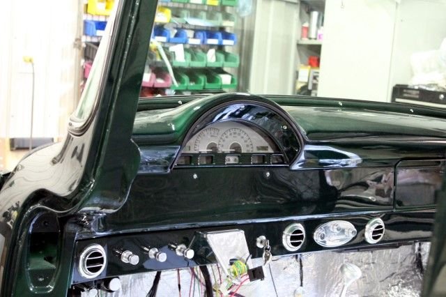

I've been doing the wiring on the truck lately so not much to post other than my gauges..

Old Jan 3, 2017 | 01:27 AM
  #285
Bader BuQais's Avatar
Bader BuQais
Joined: Jan 2015
Posts: 70
From: Bahrain
Wow the gauges looks awesome, where did you find them in km/h I couldn't find any
