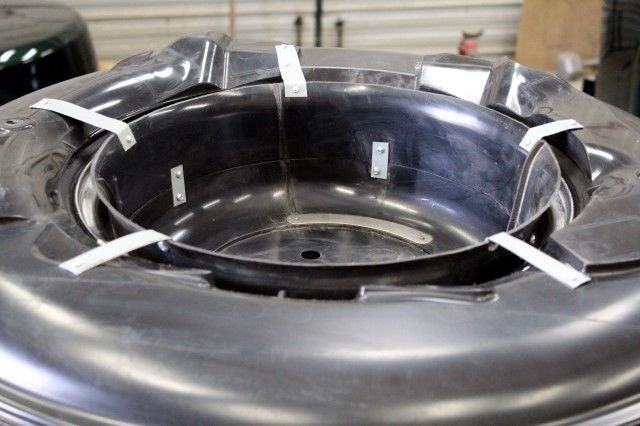

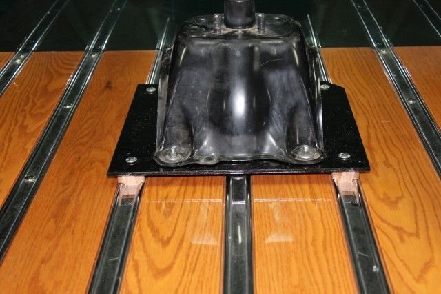

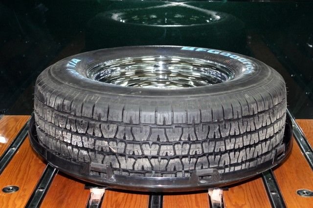

A couple years ago I picked up this tire carrier/cover from a Toyota Rav4 in hopes of using it for this project. It was made to fit a much deeper offset and bigger rim than the 15's I'm installing on the truck. I had to cut out the center to adjust for depth, if it didn't work out I was only out $30 ..
I just used pop rivets and metal straps to hold it in place

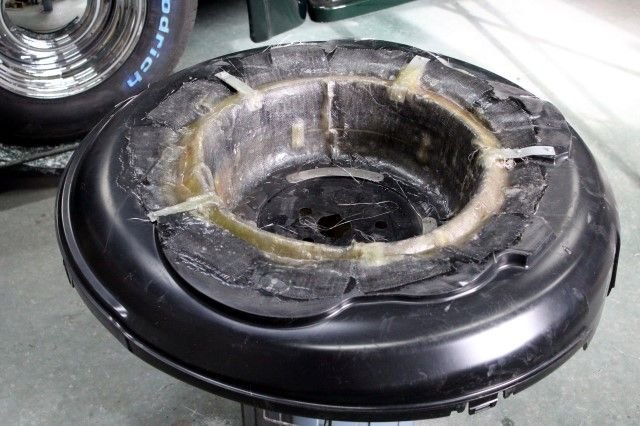

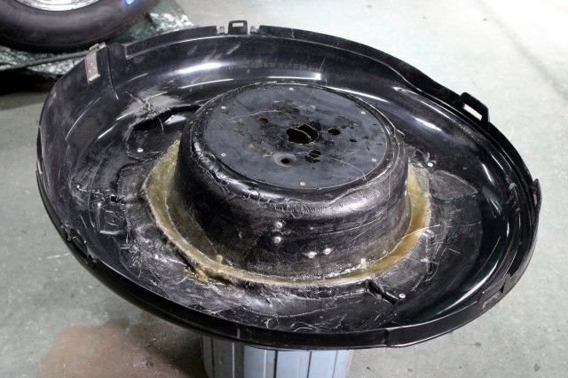

Then ruffed it up and applied fiberglass matting , I wasn't too concerned how pretty it looked , no one will see it..
Sprayed a bit of paint on it anyways

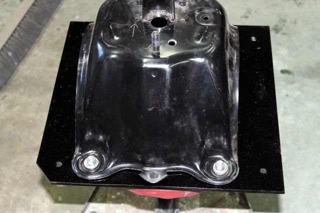

the plate I used is a bit heavier than it needed to be but all I had laying around. I drilled the holes to correspond with the holes in the bed strips and mounted the carrier bracket to it and cut 2 oak strips to set in the bed strips to hold the plate away from the bed wood.
Used some longer bolts to fasten it down to the bed floor
installed the nuts to hold it down securely

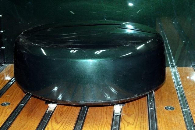

Then snapped the cover in place..
Now I'm waiting for my tonneau cover to arrive which should be the last thing to install..
Then ruffed it up and applied fiberglass matting , I was too concerned how pretty it looked , no one will see it..
...Hell... That's one hellofa 'retrofit'... Nicely done...!!

That's great idea, and it came out real nice!
