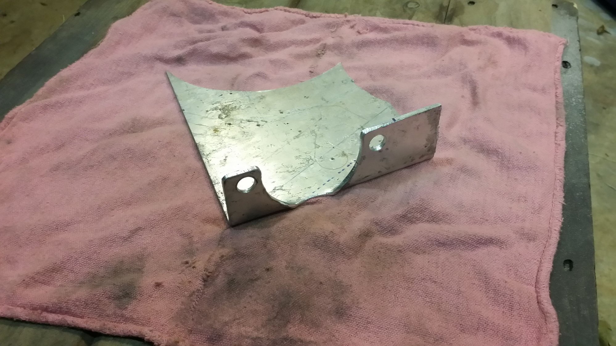

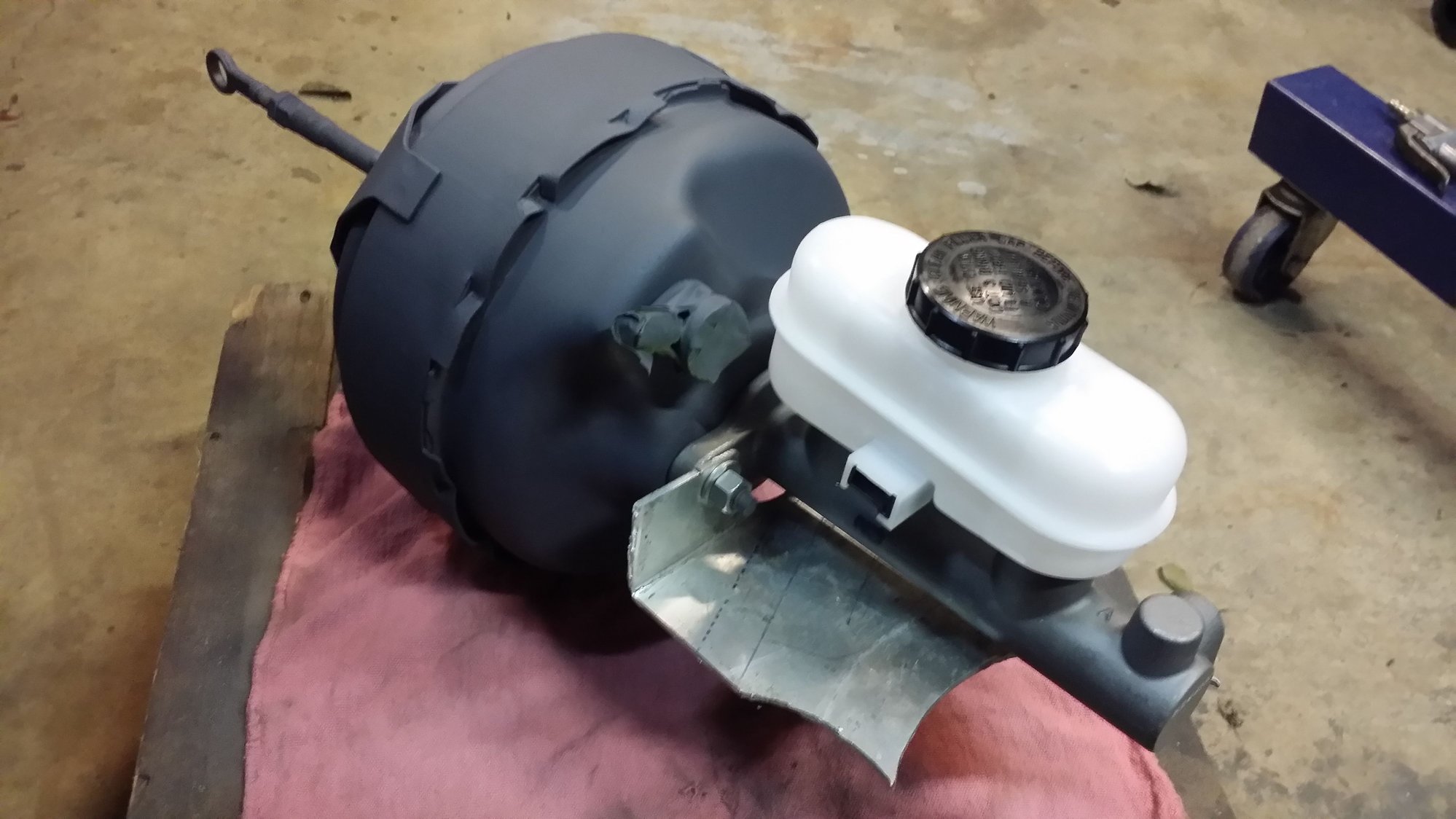

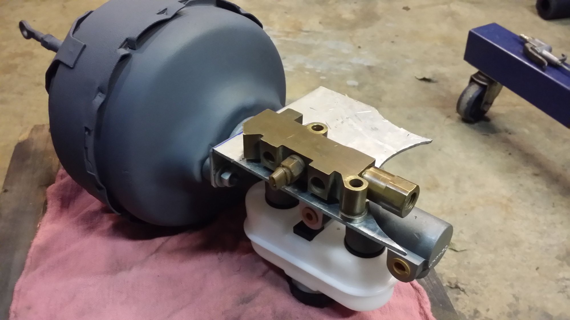

Messing Around with a Brake Valve Mounting Bracket
The F350 booster and the '95 Explorer MC arrived, to go on the '72 F100 I'm working on (for another guy).
I was originally going to make a brake valve mounting bracket to put the valve on top of the steering gear box (like I did on my '69 F100) but, the washer reservoir on the '72 is too close to the steering gear box and is in the way.

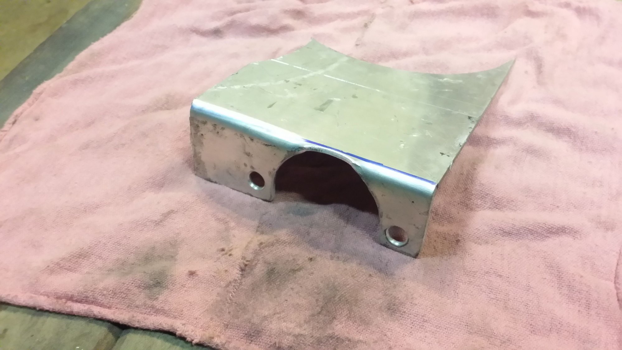

Here, I'm using a rough cut piece of 1/8" thick aluminum plate (same piece I made the bracket from for my truck).
I'll have to finish cutting the plate to fit the valve and smoothing out the cuts but, it's a start. (the brake valve in the photo is just for mock up purposes).

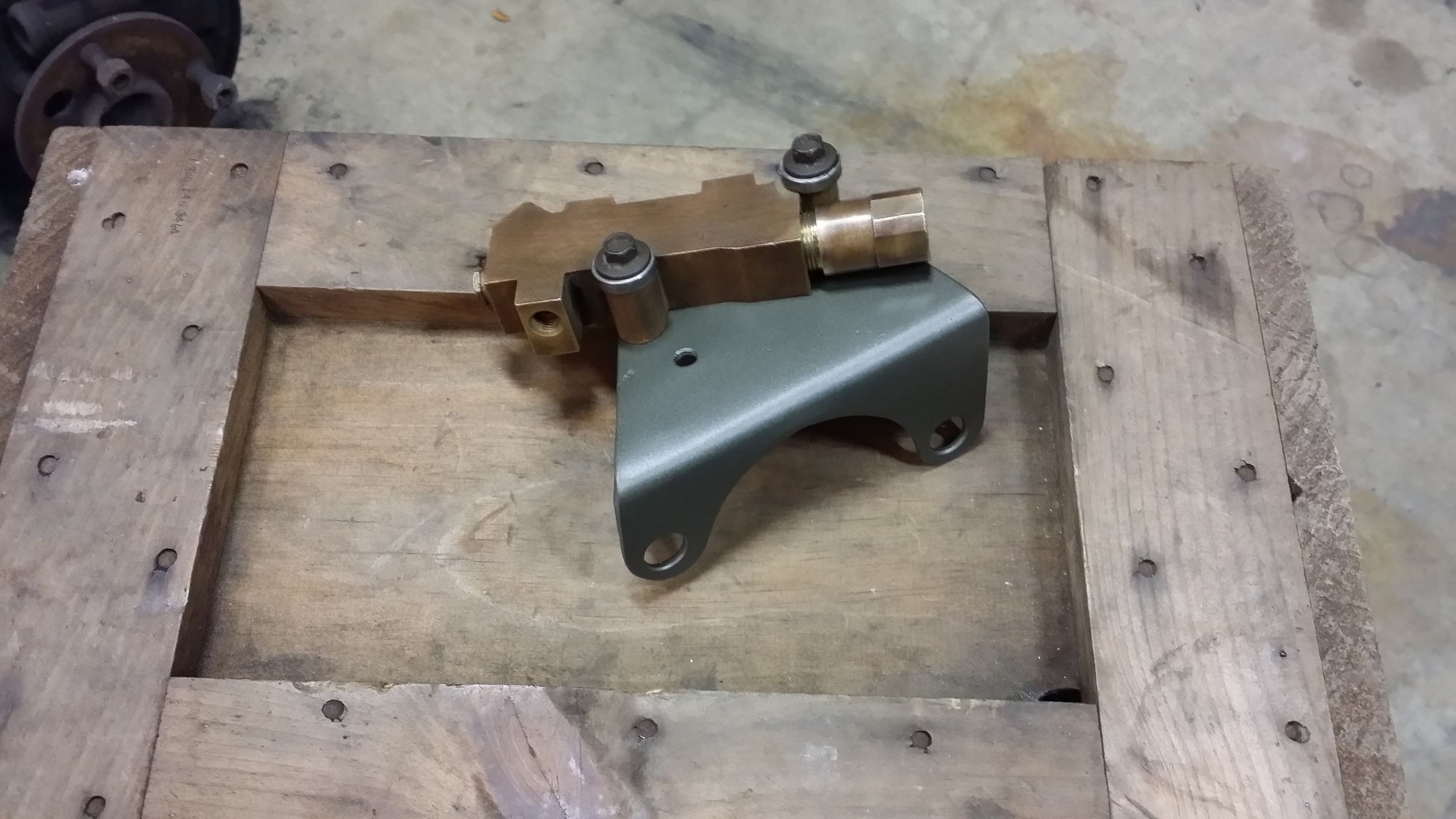

This is the bracket I made (from the same aluminum plate material) to make the valve mounting bracket for my truck. --it was simply made with a drill, hand file, Greenlee Knockout, a counter-sink bit and a hacksaw --no precision equipment.

Very nice work Ultra... indeed. You chose the F350 booster, and I am wondering if they work better than the stock? I am asking because, my '68 F250 4x4 stops, but not like my '93 F250 4x4.. I have been crediting the disc brakes on the '93, vs the old drum brakes on the '68. Can you recommend anything to improve my brakes on the Highboy? Back in the day, I just assumed that drum brakes were the technology available, and that was that.. To compensate, I just drive a little slower, and brake a little sooner, as most people did back in the Day.. Now, even here in Baja, people seem to drive like an ant mound disturbed... I guess that I am getting old, 'cuz just yesterday, we went to Cabo, and the traffic reminded me of being in India, with a serious attention deficit disorder. I would like better brakes ...... somehow.

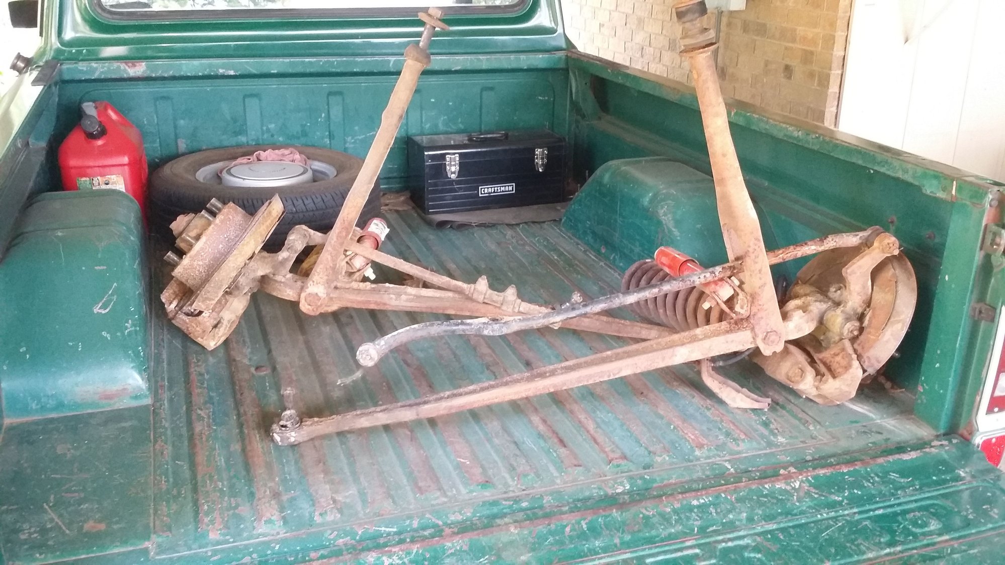

The factory Bendix dual diaphragm booster will have nearly twice the surface apply area of the stock single diaphragm brake booster. Naturally, more booster surface area equals greater output for the amount of force applied to the brake pedal.
At the time your truck was built, most all other vehicles on the road at that time also had 4-wheel drums. Everyone was pretty much on the same level playing field. Today, most all vehicles come with power 4-wheel disc brakes. Very few modern vehicles come with rear drums and none with font drums. This puts you at a disadvantage in competing with other vehicles that can stop faster and in a shorter distance than you.
A vehicle with front discs tends to track straighter when the brakes are applied (far less prone to darting to one side or the other) and brake modulation (linear brake application) is far better with discs than with drums.
Probably your best approach, if switching to front discs, would be to source the parts from a '73-'79 F250. Depending on the GVW of the Dentside F250 donor truck, the front brakes could have single piston front calipers or, it could have the larger twin piston Dayton front calipers.
Example of a Dentside front discs/suspension I pulled from a '78 F250 with the twin piston Dayton front calipers.
