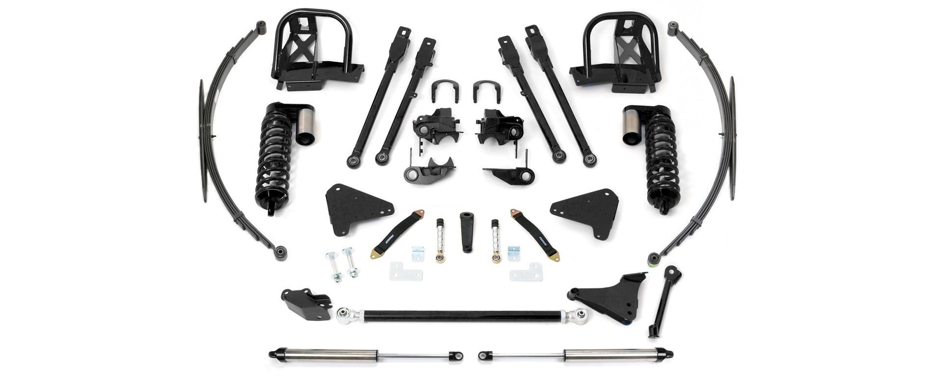

Time to make it rain Matt..... here are some awesome ways I can spend your money
Ready made kit:
8 Dirt Logic 4.0 Coilovers w/ Rear Dirt Logic Shocks & Long Travel Leaf Springs - 2000-04 Ford F250/F350 4WD
Or combine these:

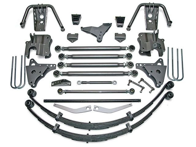

https://full-traction.com/detail.php...&p=1528&n=NULL
And some Coilovers....

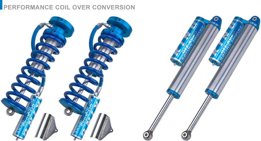

King Shocks Direct bolt-on performance shock kits for Ford trucks from King Shocks « King Off-Road OEM Bolt-On Shocks : kingshocks.com
Finished product....
With all of this being said, I may need a few minutes alone with post...

Lol hold on let me get some ones, that sucks about the 05 coils i thought i was on to a cheap coil conversion.
What is the advantage of coil overs? If its a significant upgrade i may consider it lol, i am converting to 08 rear leafs so i only need to do the front end now. Those are nice kits however and thehbare shiny...i like shiny.
Holy lord jesus those are expensive!! I just looked at prices lol.
Still though what's the advantage of a coilover vs say my leafs?

Its the build quality, rebuildablility, and adjustability. They use King coil overs in buggies and trophy/baja trucks for good reason. I am not sure about them on a SD, you may have to find some reviews but I imagine they would give a significant ride improvement. Especially since these are set up for SD from the factory.
I'd love to have it on mine, but it is pretty expensive and I like the simplicity of leafs.
Here is some more info: 6" & 8" full traction coilover suspension kit?? - Ford Powerstroke Diesel Forum
Ford Super Duty Coilover Conversion - Four Wheeler
From 4 Wheeler Article:
We anticipated a significant improvement over the stock ride. However, in particular we greatly underestimated the enhancement this kit provides on pavement. Especially going around corners, this kit is leap-years ahead of the stock setup. We'd even say it's better than that of the new '05-and-up coil-sprung Super Dutys. Much to the delight of our donor truck's owner, this kit performs awesome in the dirt as well. Going over small roller whoops at speed is now way too much fun, and the speeds at which you still feel safe and comfortable at are actually very dangerous without a cage. The steering feels more responsive than ever, and the wheels have a more predictable return-to-center feel than before. All in all, we give this kit two thumbs way up.
