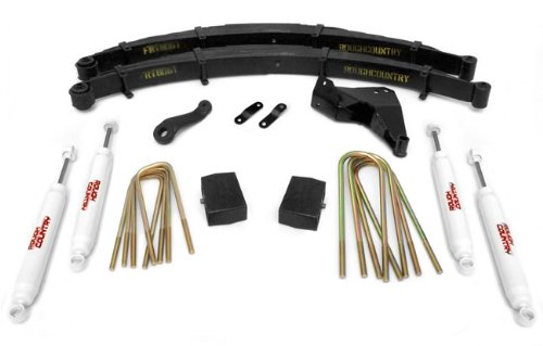

^^Speaking of which...
(20x9)
(6")

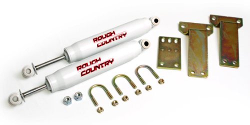

(Dual stabilizer for the 37's)

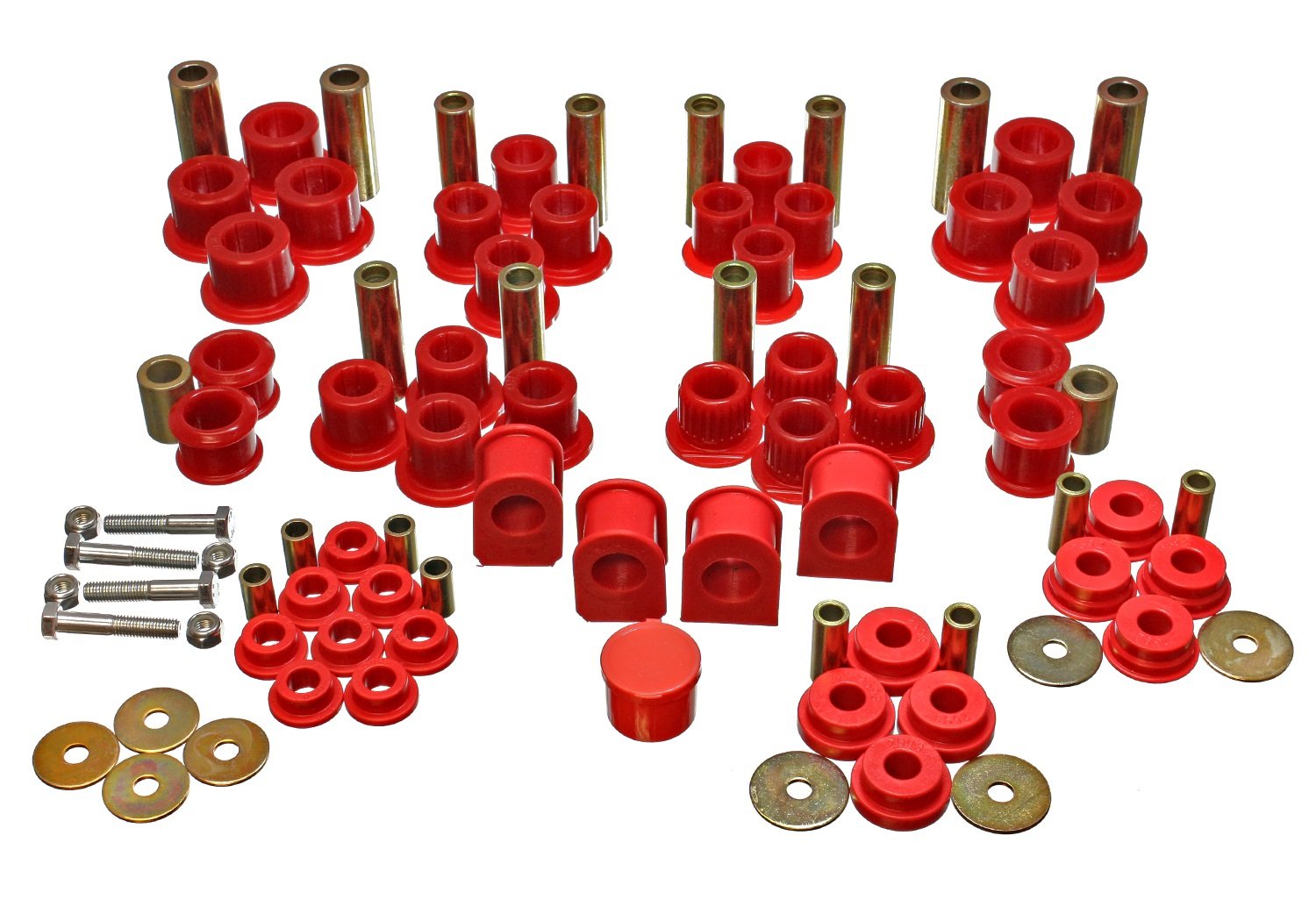

(Who doesn't love Energy?)
I also got red dust boots for the shocks. I have a red/black theme going on.
...and all bodywork and a fresh new paint job also in the works. I'll be in Indiana at the end of May and I think I'm gonna pick up a rust-free bed from a member here. Cutting out the cab corner and welding in a new one in the interim. Also gonna shave the emblems and weld in all the holes. I was thinking the 'International' lettering strip, but I'm undecided. I like the clean no-emblem look.
