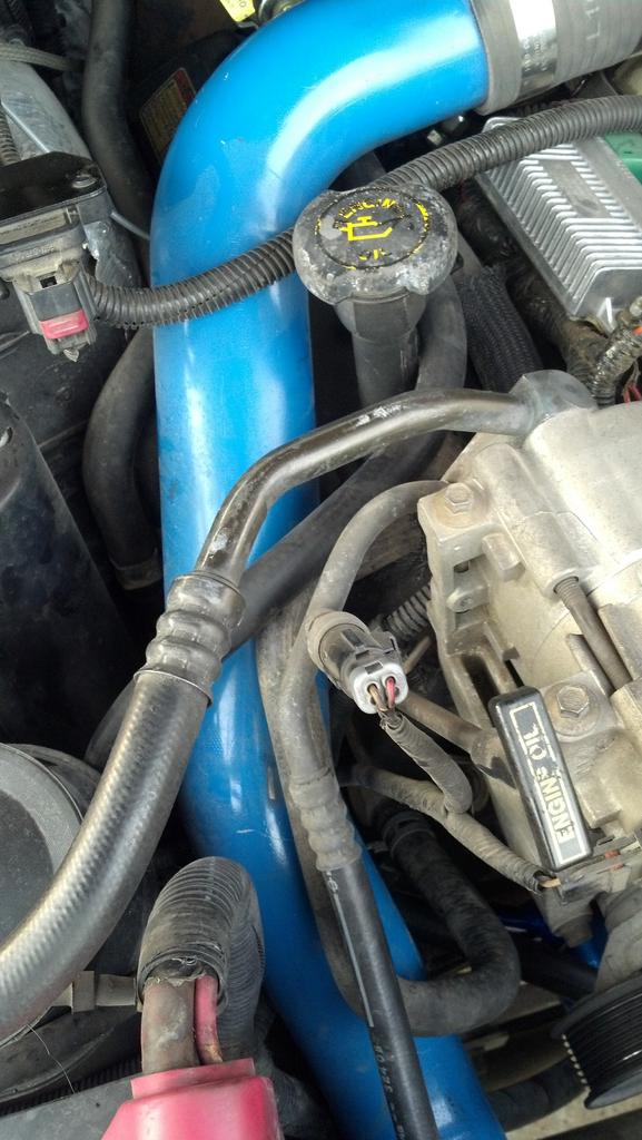

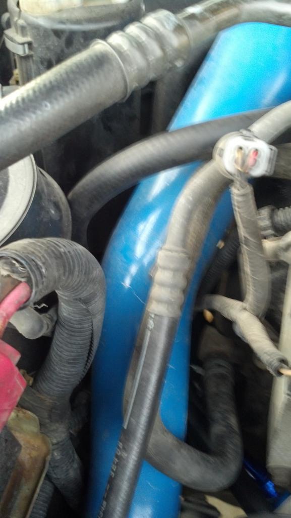

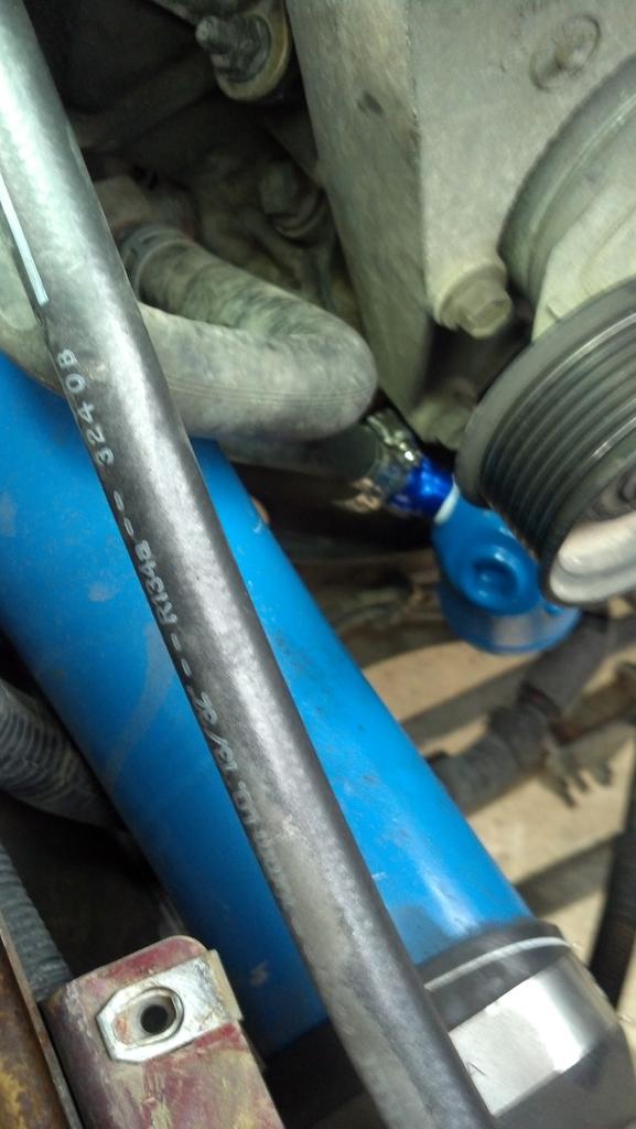

biggdirty7.3's Avatar
biggdirty7.3
Joined: May 2016
Posts: 321
Originally Posted by Nicmike
Here are some photos of the re-routing of the heater hose from the top of the old pump to the side of the new pump. The length of hose required is 3.5ft.
Tie in here at passenger side valve cover.
Attachment 65390
The "max A/C assist" valve over the passenger side valve cover.
Attachment 65391
Run the hose like this:
Attachment 65392
Attachment 65393
Attachment 65394
Love the blue . Where can I get one of those max ac things
Old Jul 4, 2016 | 08:53 AM
  #192
Sous's Avatar
Sous
FTE Leadership Emeritus
Joined: May 2014
Posts: 27,352
Likes: 5,946
From: Lake Hartwell, GA
FTE Emeritus
Max A/C assist from Diesel Site.
http://www.dieselsite.com/maxacassis...4-200373l.aspx
Many have had good luck or experiences with this piece, I did not. I think there may be a vacuum leak in the device itself as it will not close the valve when applying vacuum to it.
There are 2 other options that are just as suitable.
This is a similar version of the Max A/C assist made by Ford that came in the Ranger and seems to work in just about every occassion it has been used.
https://www.amazon.com/dp/B000C5DZQE...I15DJOGWO5K6DB
A third and manual option is to put in a valve with barb fittings on each end in the hose system.
http://cimg8.ibsrv.net/gimg/www.ford...1a64ed74d7.png
