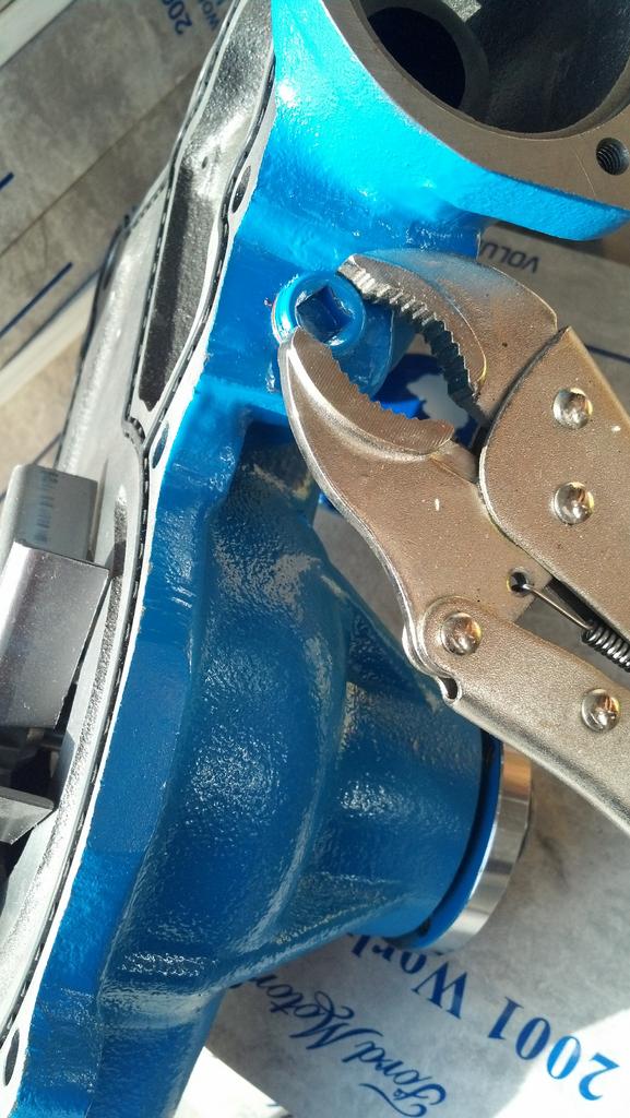

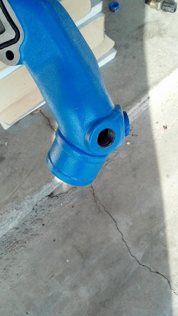

Here is the prep for the new pump. Remove the two plugs shown in the photos and then put in the temp sensor and the 45* fitting for the heater hose re-route. The gasket that came with the pump is the new type with cleats all the way around it. They fit tight into the groove and hold the gasket in without using little dabs of silicone. Also, in the bottom photo, the fitting for the heater hose needs to be pointing to 4 oclock...not 530 like it is in the photo. I adjusted it after it was on the truck. Once on the truck, it should be pointing right at the passenger side battery.
I spent significant time cleaning the front cover up before installing the new IH pump. I used a razor blade to scrape off the old gasket, then I used a wire brush and finally I used 600 grit wet sanding paper to polish the surface flat and clean.

You can see the plug that is still on there next to the one I took off. It is for the degas hose reroute on the OBS trucks. 99-03 will NOT use that one.
