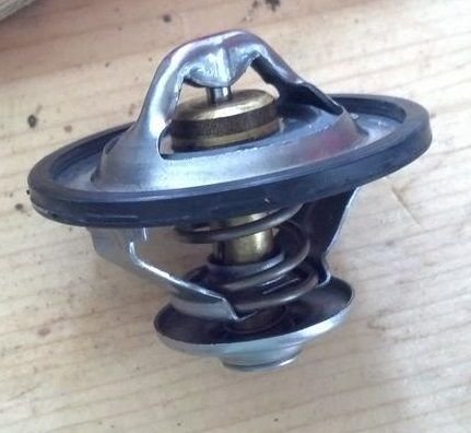

Also, a photo of the t-stat that is specifically made for this pump. Notice the gasket fits around the circumference of the t-stat and seals from both top and bottom....not just the top like the others.
Mike, in this post you show the tstat you used, is this the 205° Stant 14252 in your list, and the pdf published by F250? I bought the 195° Stant 14259 for my application (as 195° is the OE temp for our trucks), and it did not come with any gasket. Not a big concern, as the IH pump came with a regular gasket, just curious.

Thermostat in that pic was from International. I believe it is a 195. Very pricey wrenching it from their hands...

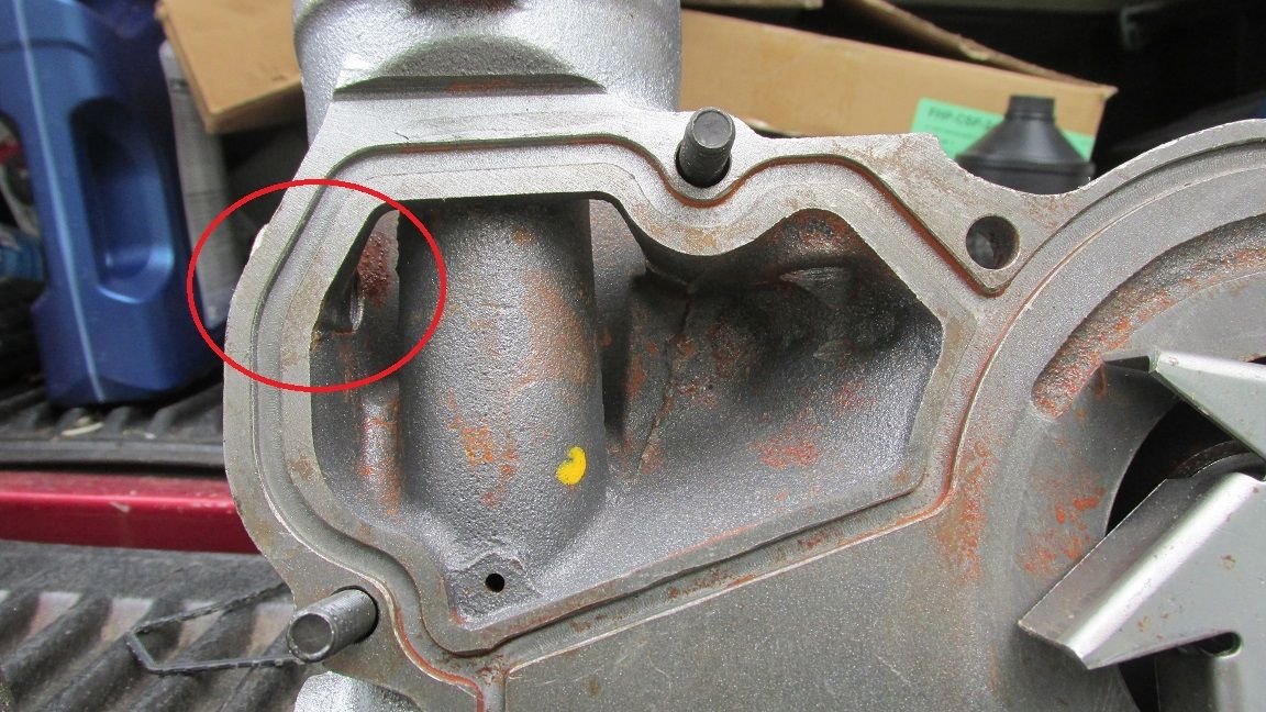

From: Dade City, FL
Sorry for the necro bump, but for you guys who have done this mod, is there a place to plumb in for an aftermarket coolant temp sender? I suppose I could use the stock sender location, but then the gauge on the dash wouldn't work and that sort of stuff bugs me. My Isspro sender is currently plugged into the base of my DieselSite coolant filter kit which would obviously be going away.
Thanks.
Old May 4, 2018 | 11:40 AM
  #210
SaintITC's Avatar
SaintITC
Joined: Jul 2003
Posts: 1,614
Likes: 22
From: Springfield, PA
Yes, there is another spot for a temp sender of the same size. You can see it in the top photo in Carl2591's previous post; old and new on the tailgate. Just below the T-stat.
Edit: better pic, circled area is where a second sender could go.
