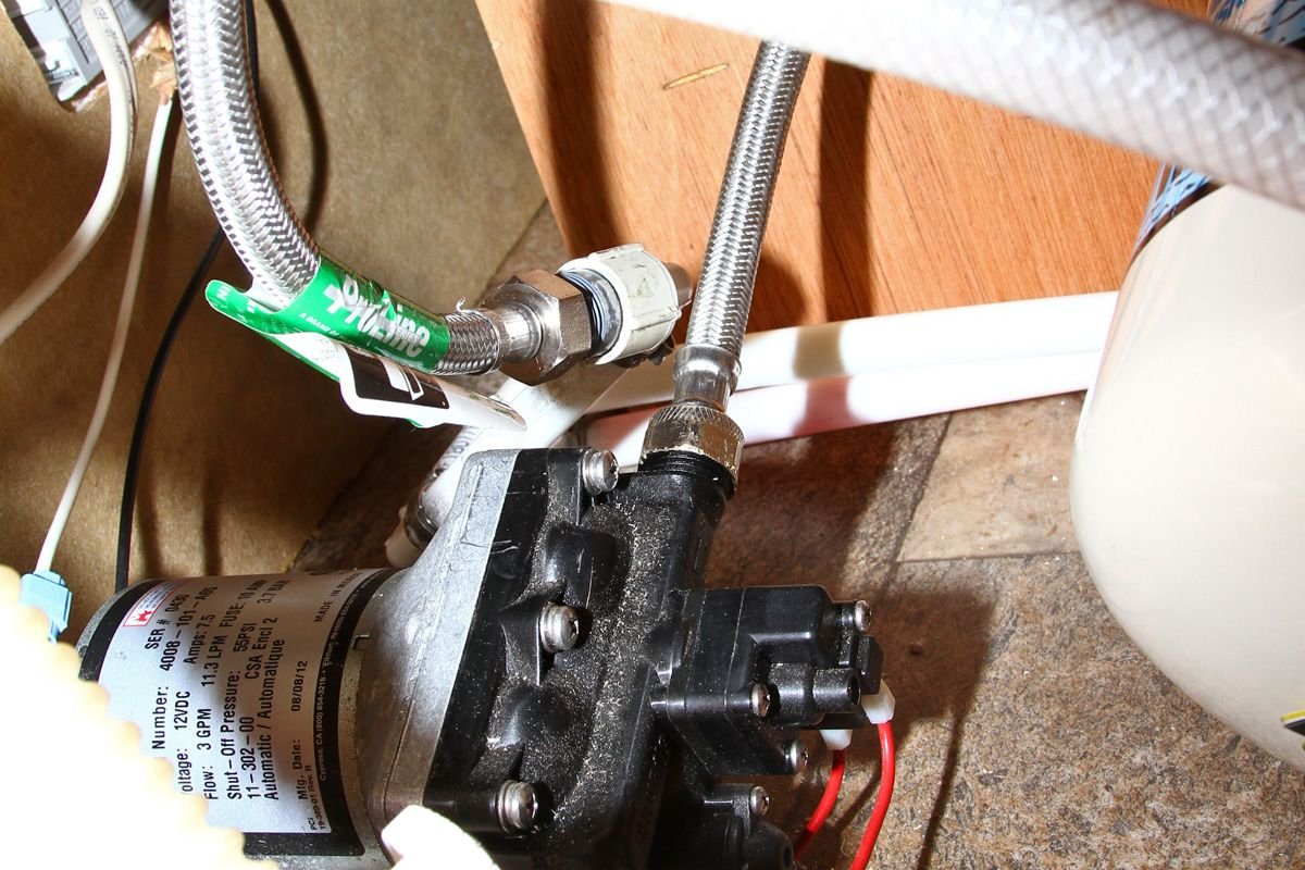

I'm not exactly sure where I bought mine, but something like this. Just make sure it's made for potable water, most of the heating system tanks aren't potable.
Watts DET-5 2.1 G Potable Water Expansion Tank for 50-Gallon Water Heaters - Thermal Expansion Tank - Amazon.com Watts DET-5 2.1 G Potable Water Expansion Tank for 50-Gallon Water Heaters - Thermal Expansion Tank - Amazon.com
I disconnect it when I winterize. I'll get some better pictures, but the gist of it is just put it in line between the pump outlet and the first connection to the trailer pipes.

Here's a better pic of the tank plumbing. The pump is easily accessible on mine and there is space for the tank right there. As Andy mentioned above, you can plumb it into the cold water side anywhere you want in the system and it will do the same thing.

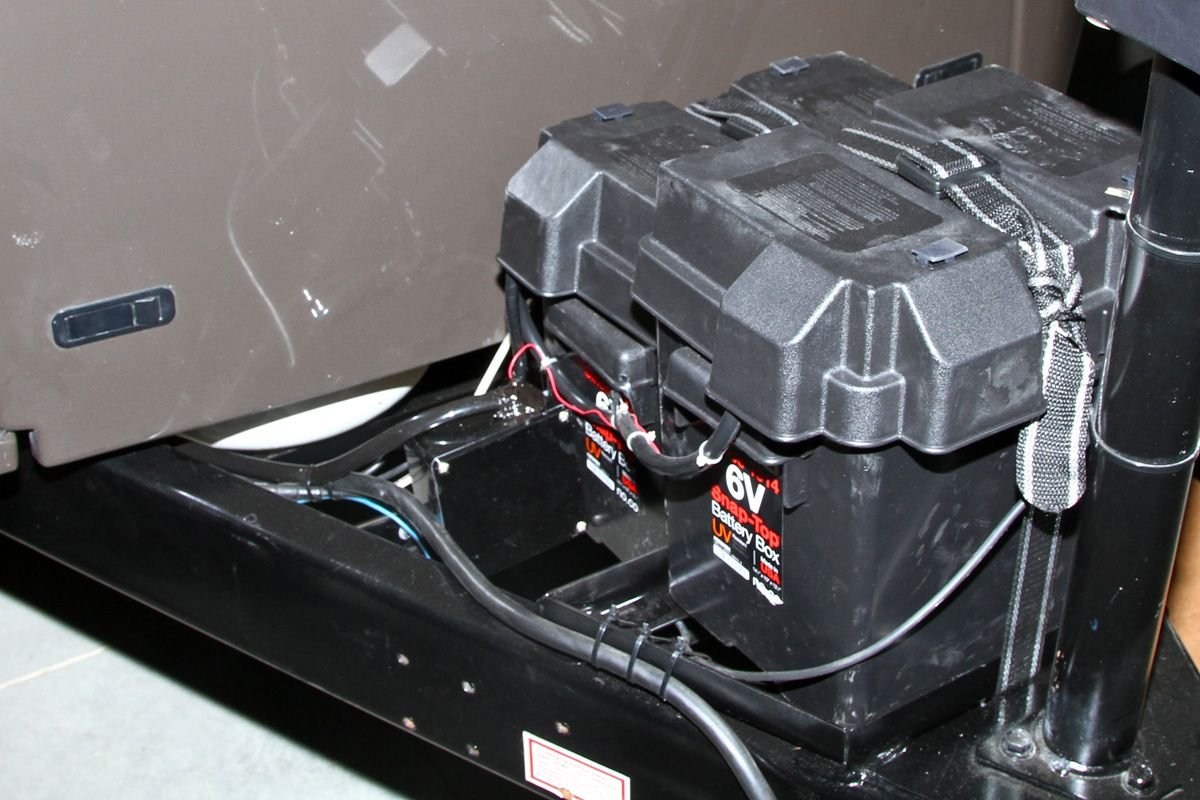

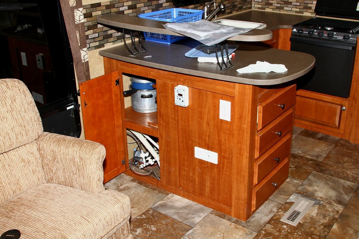

Installed a new toy for the camper, a Trimetric 2030 meter. It keeps track of how much juice goes in and out of the batteries. Useless if you are plugged in all the time, but it will be nice to have when we are camping off batteries only.
Everything runs through a shunt and the meter reads off that.
Shunt needs to be close to the batteries, the meter can go wherever. Instructions didn't say anything about protecting the shunt, but I put it in a plastic electrical box and painted it black
The wiring (not shown) ran along the frame outside of the enclosed area underneath and then up through the floor in a convenient spot. I went for the path of least resistance and put it where I could install it without too much fuss even though the standard battery monitor system is in a different spot.
In easy mode it shows voltage, amperage draw, and percent of battery left. With more button pushing, you can see total amp hour draw since last charged, when it was charged, how much it was charged, etc etc.https://www.ford-trucks.com/forums/i...2/blahblah.gif
I still need to play around with it some, but I have learned a few things so far.
The trailer draws .1 amp just sitting there, gas detector I assume. The fridge on gas draws .5 amp. Main slide motor pulls 9 amps, stab jacks pull only 1.5 amps, of course those are very momentary loads. Radio .5 amp. Furnace about 6.5 amps. The standard incandescent bulbs draw 1.4 amps each. The new LED bulbs a bit over .2, I can turn on 6 to get the same draw as 1 of the old bulbs. With every light on in the trailer, it was drawing 9 amps with the new LED bulbs. Tried the TV on my old crappy inverter and while it was playing a DVD it was drawing 6.8 amps. In 3 minutes the inverter overload alarm went off, so I need something else to run that. Since I've never had a TV in my camper before, I won't miss it. With the truck plugged in, it was charging at 9 amps at idle. Not a very good test as the batteries were charged to begin with, but I'll get some more useful info from that once I've used it a few times.
