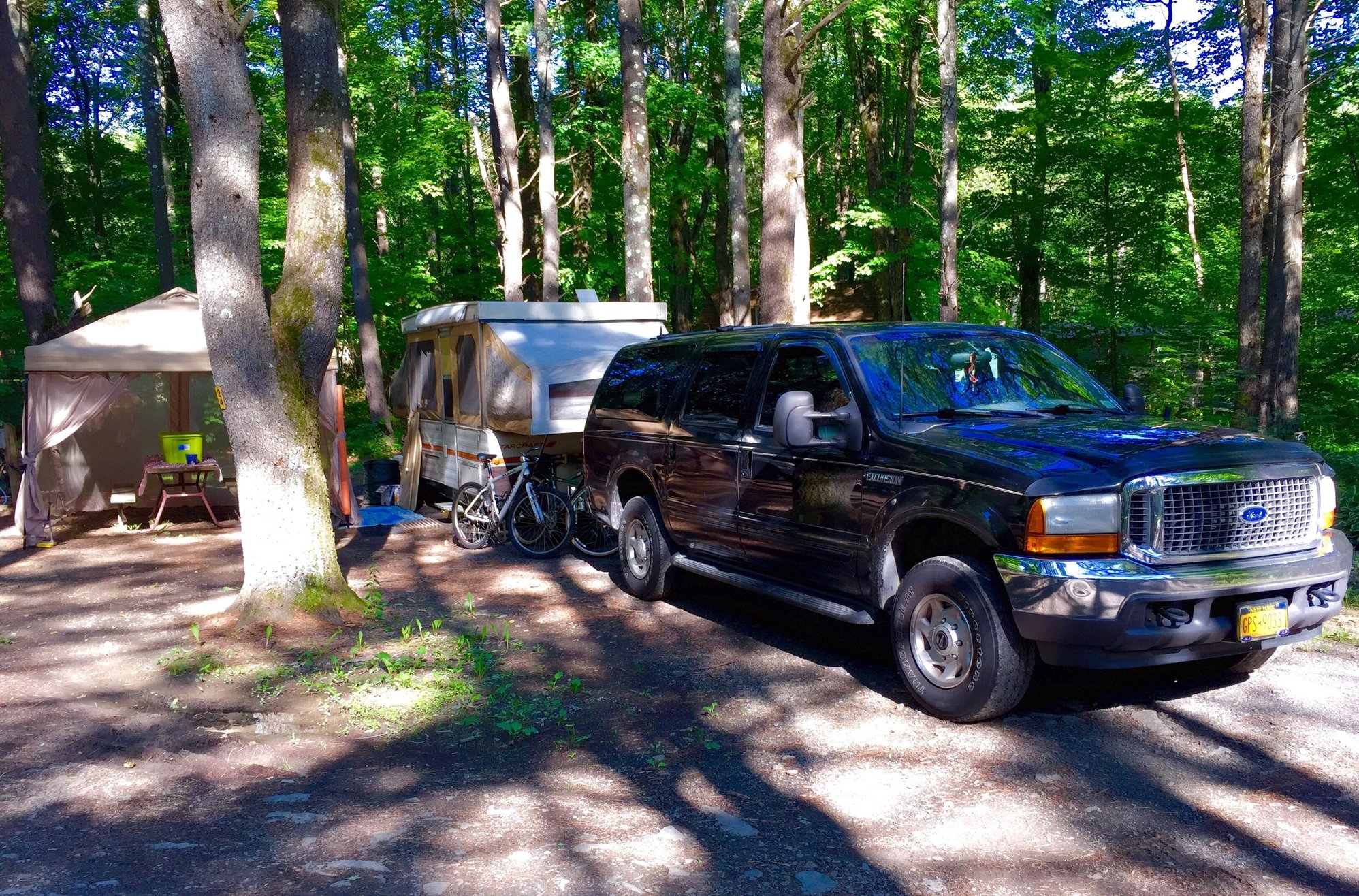

1979 Camping Luxury pulled by 2000 Ford Power!
1979 Starcraft Galaxy 8, almost all stock with the exception of adding a refrigerator instead of the "ice box" and adding a tiny water pump instead of the "hand pump" in the sink!
2000 Ford Excursion 6.8v10 equipped for Law Enforcement and S&R needs...
Today in Saugerties NY
