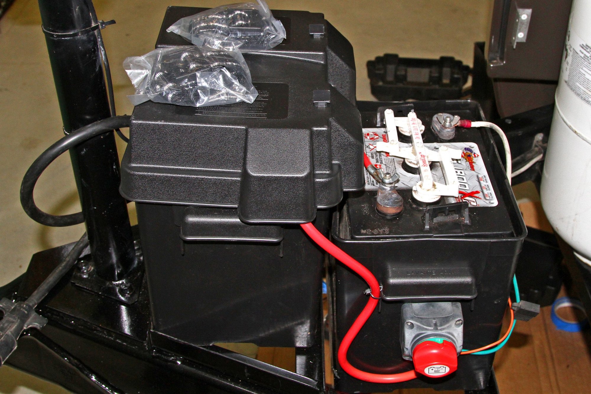

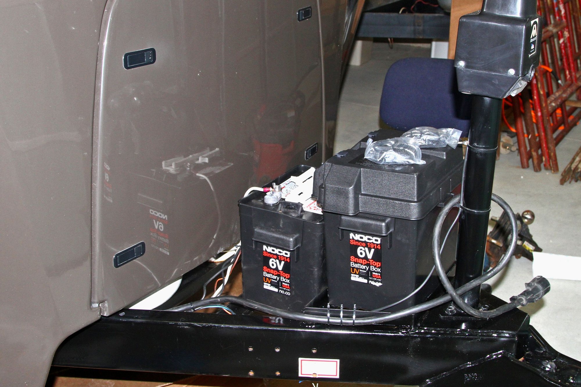

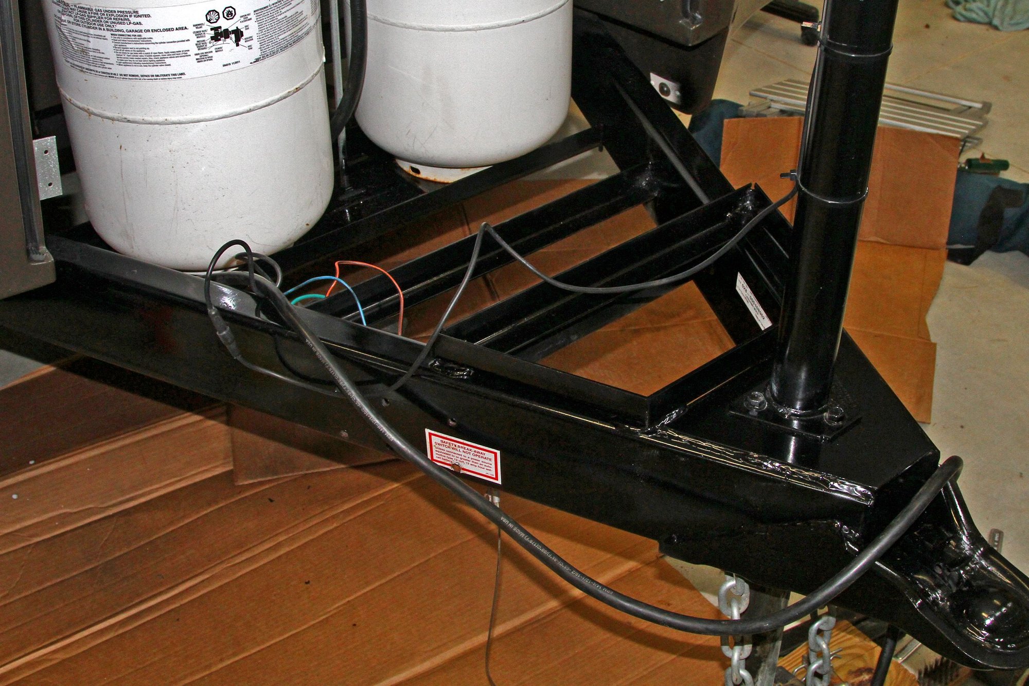

We transferred the camping stuff from the old to the new trailer last week. Last couple days I was working on moving my golf cart batteries onto the new one. The paint job on the tongue was pretty shoddy from the factory, a little rust on the propane rack and battery racks, plus WD bar marks in a different spot. Cleaned that up and painted it yesterday, installed the batteries today. I need to pick up a longer cable to go between batteries before the covers will fit, they were side by side on the old one, plus the old boxes were too short anyway. Here's the gist of it.
Even waxed the propane cabinet area. Painted the old trailer tongue today. Tomorrow I need to take the expansion tank out of the old trailer and figure out what fittings I need and put it in the new one. Getting anxious to sell the old trailer, it's looking a lot like a lift to me these days!
Those stickers on the new battery boxes are not cooperating in coming off. Should I try a hair dryer to peel them off?

On the decals ....... I peel as much off by hand as I can, then soften / wash off the goo with a rag and a solvent like mineral spirits or enamel reducer. I try to stay away from laquer thinner as it can eat some plastics.

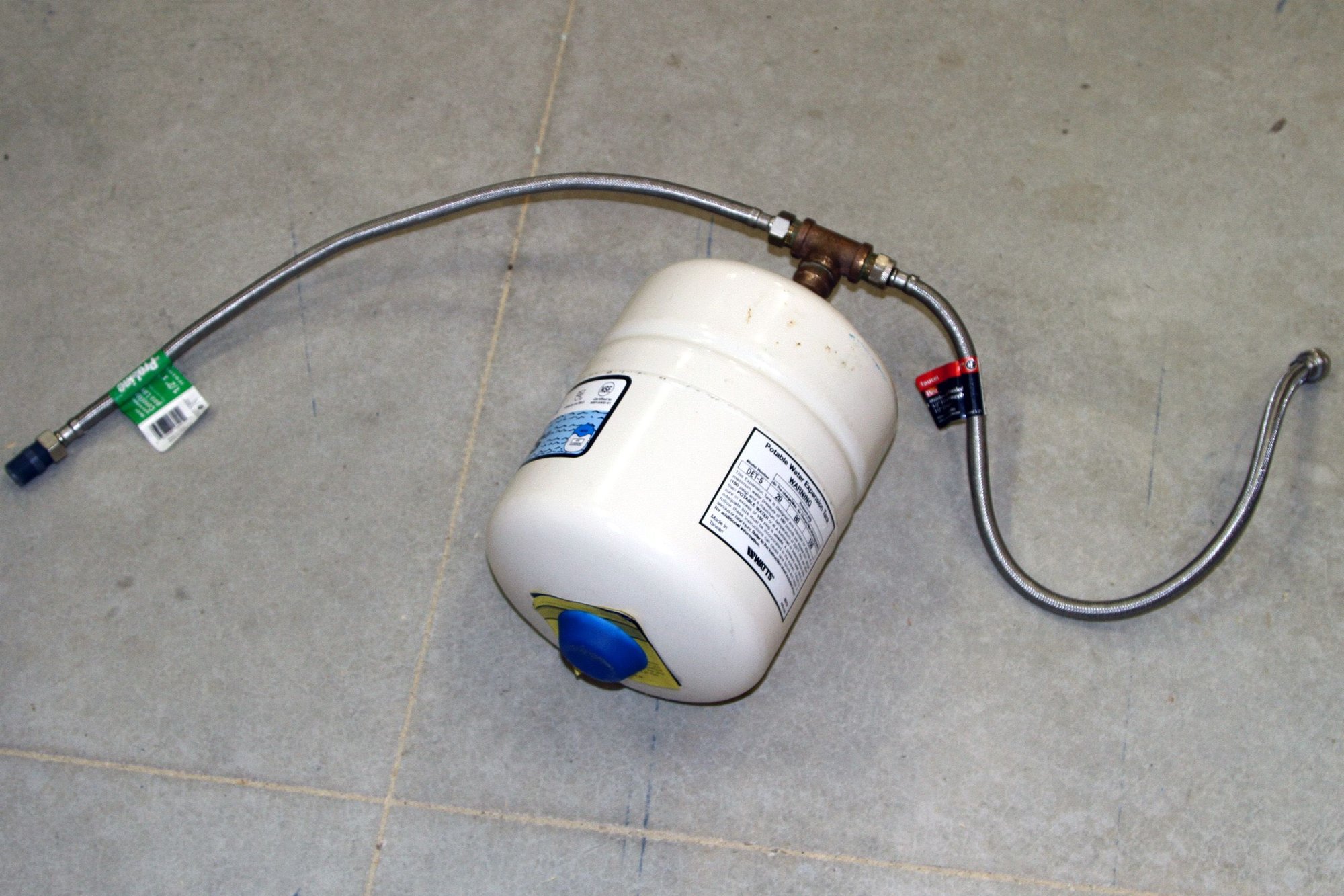

Got my expansion tank changed over to the new rig. I really like this mod. We rarely camp someplace with full hookups, run off the pump most of the time. This stores up a gallon or so of water under pressure so you can have the pump off and still have enough water pressure to wash hands or use the toilet or whatever. Also seems to make the pump quieter.
Easy to hook into the system, just a couple hoses and a Tee off the tank. One hose goes to the pump outlet, the other goes through the union and hooks to the water line that came off the pump outlet. Pictures is lame, but inside the circle is the hookup. Off the shelf potable water expansion tank and standard 1/2" lines.

That's a fantastic idea. Nothing like hearing a brrrrrrp brrrrrrp in the middle of the night with the touch of a faucet / toilet flush.

I think I will do the expansion tank deal like Eric posted. The strait plumbing has been bothering me for awhile now, so hard to get a nice trickle flow with the plump kicking on and off constantly.
