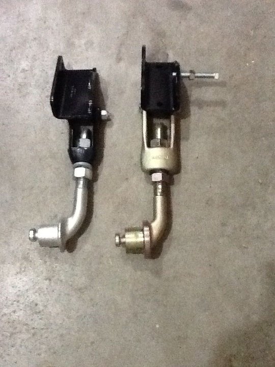

What one of these is the newer version? Both were ordered using the same part number, one from Amazon, the other from the RV dealer.

In my opinion, and based on what I have worked with, the black arm and silver cam is the latest version. If you look closely, there is more offset to the arm where it bolts on toward the inside of the frame, and the arm (which is also thinner) "should" have much less chance of contacting a bar. The silver cam also has more offset to the outside helping further.
As I mentioned before, measure the width of the cam surface where the bar rides. The silver should be slightly wider, letting the bar slide with less binding.
I believe that there was a middle version which was also gold, but the cam surface was wider. Yours looks like my older, original set, which are going on 10 yrs old. As I mentioned, the 1200# round bars wouldn't slide without major binding. Now using the black later style with no problems.
Reese (Cequent) has made many changes to the DC, probably due to the interference issues that many have had. They are also now made in China (OMG!), but I haven't seen any major quality differences in the 2 styles. Again, with a top mounted coupler and trunnion bars, you have to make every effort to prevent bar to arm interference. Head angle, lifted ball if necc, more links hanging the bars.
Don't know if you visit rvnet or not, but in the towing section there is a lot of info on install and past posts on this very occurrence. Hope you get it worked out, the DC is a very capable sway control hitch, but is very fussy in set-up, as you are finding.

I'm convinced I'll figure it out with everyones help on here. I don't give up easy, I had to find a HPOP leak on my 6.0 a month after buying it and I had never worked on a diesel before. It may take me a while, but I'll get it. The latest set of cams to go on is the silver set on the left in the picture, apparently my order from Amazon was a old set. I will tilt the head down another notch and get 6 links instead of 5 for this weekend. The new riser ball comes early next week and I'll get that on, after that I'm sure everything will have to be readjusted to compensate. Again thank you to everyone on here.
Is there a point when I'm too tight on the trunnion bars? I'm assuming if I can pull it up with one hand on the breaker bar it's not too tight?

Steve, you'll need to go through the measurements again, even weights again to finalize the chain/bar angles. 1" riser ball, tip the head down as necc, and the newer arms should give you the clearances necc. Then find the proper # of links for weight transfer to the tow vehicle or wheel wheel heights. Hooking up is much easier if you use the jack to lift both units up til it is reasonably easy to swing up the chain hangers (as just mentioned). You'll most likely need to do this. I could use the bar to swing my 1000# set-up most of the time, now with the 1200# system, I have to use the jack most of the time!!
Another opinion, sometimes switching the arm brackets side to side (so the pivot bolt is to the front) will angle the arms and cams down more and give a bit more clearance. But I'm betting the offset differences between the two versions will give you the necc clearance to keep this from happening agin'

But, I am confused!! What part are you going after!! Did you have trouble with the later black/silver set?? If so, I never saw any pics of anything but the gold stuff. Did you bend a silver arm also?? If so, that's a first in my book, and obviously you had really bad interference.
If all you need is a gold cam, I have another used pair of them laying around. They are the early ones, so you would need to measure the width of the cam to see if they are the same.

Originally, 7 months ago, the trailer was purchased and the dealer installed the silver colored units. It was set up incorrectly from the start and I did not know better. The system only had 3 links and wreaked havoc on the cams, popped the self taps, and knocked the emergency brake off the bottom if the frame. I ordered replacements off Amazon and ended up with the gold colored units, apparently the older style. I installed them with rivet nuts and ended up bending one when it bound up, from what I believe was a loose river nut. I torqued it to proper specs, but I don't think it had crushed down all the way. The dealer has now admitted it was set up incorrectly and sent me a new set of cans that I am installing with a new higher ball.

Gotcha, makes sense to me now!! I never saw the first comments till I just searched. I think with the new stuff again you'll be ok. Too bad you had to go through the "school of hard knocks" to get here!!
Keep you chin and attitude up, you'll get it worked out. Any big questions, ask, or pm me.
