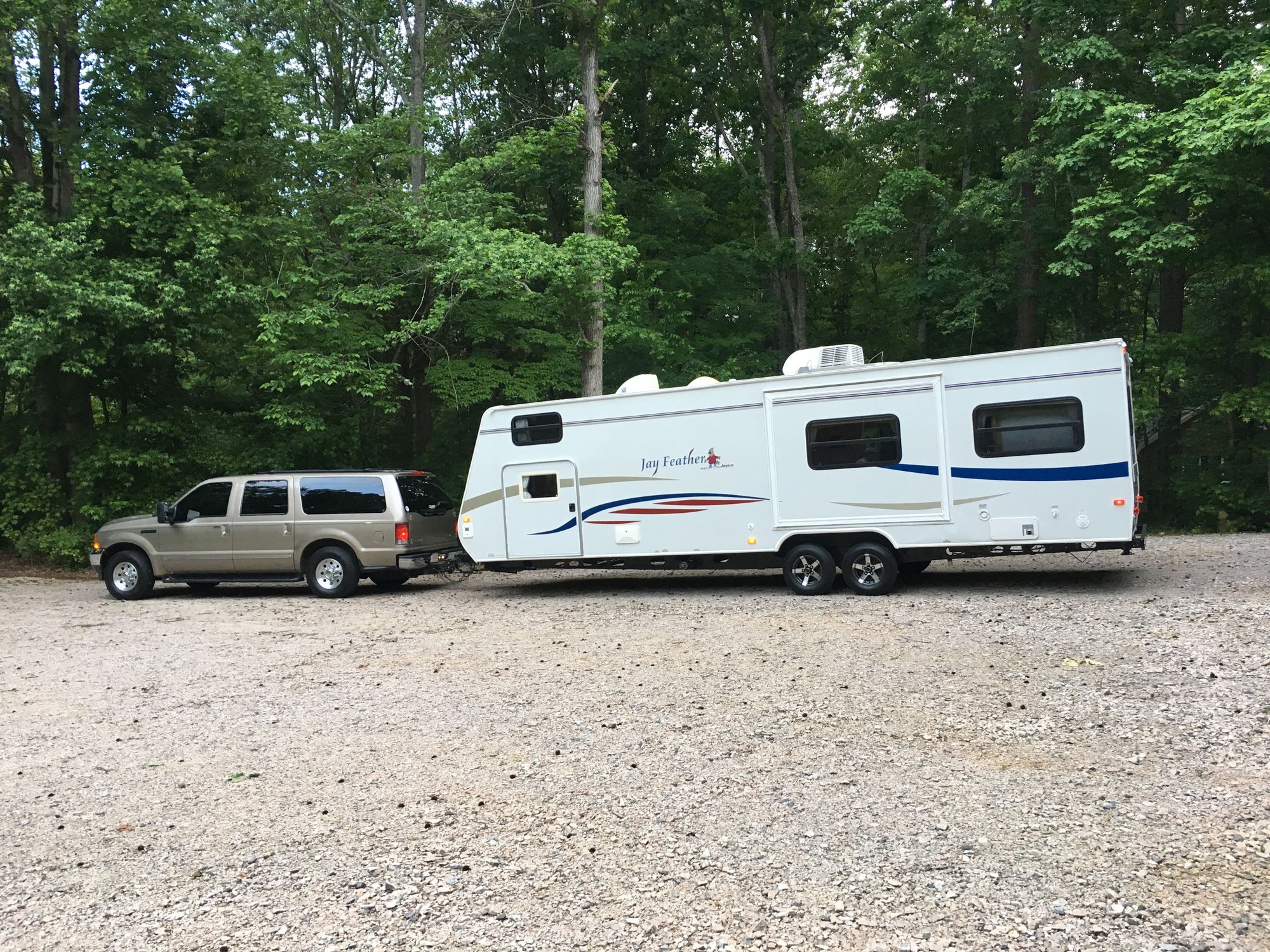

After doing some upgrades including, '08 power fold tow mirrors, 5-Star tune, Rear Active Suspension, new plugs, boots and springs and a trans temp gauge I was ready to go pick up my new trailer from my parent's house as they were storing it while I prepared the truck and parking spot for it at my house.
Here are some pics of the Ex with its new toy :-)

Nice looking setup Redbird!

They both look great Redbird, we love our Jayco!
Is the TT a little too nose down or is it just the picture and or where you are parked?

I think it is a combo of both. I need to get to the scales and get a thorough check on all the weights, but the trailer was also on a slight decline while the truck was on relatively flat ground where it was parked.
What's the general procedure to check tongue weight and setup the weight distribution correctly? When hitch gin it this time I tried to put the chains one link tighter than I previously used them at, but I couldn't get the next link high enough to get it on the trailer latch. Not sure if maybe these bars are not quite strong enough. i think the PO said that they were 600-800 bars and seeing as the trailer only weighs 5500lb I cannot imagine that I would need 800-1000 bars.
Help from the experienced would be appreciated.

For hitch setup I always use the TT's GVWR to calculate things like spring bar ratings vs using any advertised "dry" weights as they are typically lighter than reality and don't account for options and your clothes, food, gear and beer. I like to shoot for 15% of the GVWR as the planning tongue weight, that way you will always have ample capacity on the spring bars and all other hardware.
Do you raise the front of the TT and rear of the EX with the trailer tongue jack to snap up the chain brackets, makes it much easier to do.

I did try using the tongue jack to raise both, but maybe I just didn't go far enough.
