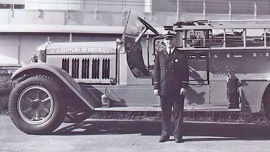

Here is a photo of him standing next to one of the brand new American La France engines at the fair:

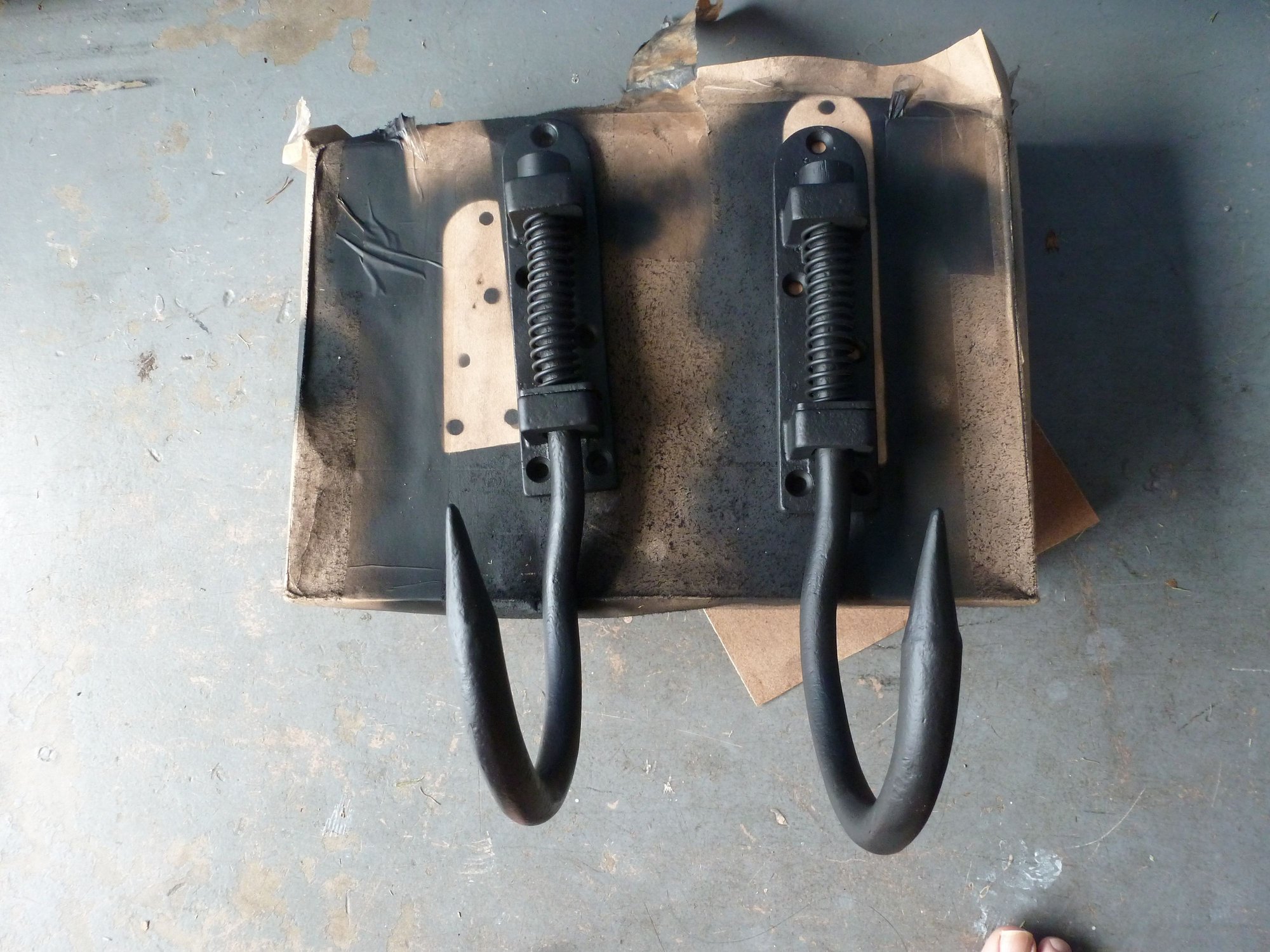

A little update! Found some time to work on the roof ladder I have for the truck. I need 2 and was given one a while back. Its in poor condition and I hope to replace it when I find another one. I bead blasted the hooks and gave them a coat of fresh paint. The ladder just got a coat of varnish. Now comes the tricky part! How did they mount it! I don't have a real good picture of how they did it. As you can see from the pics below there was some type of bar they kept the ladder from sliding out. I will assume it hinges on the top?? Could there of been some sort of railing on the floor that the ladder slid into to keep it from moving around. When we took the truck apart the ladder floor had already been removed so I don't know the original configuration. Does anyone have any suggestions? They would be greatly appreciated!
There was another ladder on eBay not long ago but it was a little pricy and the man was in California and would not ship it. Here is the link:
http://www.ebay.com/itm/281403674438?_trksid=p2055119.m1438.l2649&ssPageName=STRK%3AMEBIDX%3AIT
I started another book. I know the second one hasn't been printed yet! It is on the Century of Progress Fire Department ...same one that I was able to get my grandfather's badges. In my first book on the Patrol, I included a chapter about the department. I want to expand the chapter and add additional information like the log book and other pictures that I didn't use.

Forgot to post pics of the ladder & hooks. Here they are:

Have you fit the ladder in there? I would bet they didn't worry too much about it banging side to side. The locking rod looks to be spring loaded on the bottom. I was thinking that maybe there was a hole at the top and bottom and the spring kept it in place. But I would bet it attached at the top. It would be too easy to lose the piece at a fire if it wasn't attached.
How long have you had that top picture? Seeing the rails reminded me of the discussions we had on yours being bent. I know at one time you pondered whether you should leave them bent or straighten them.
