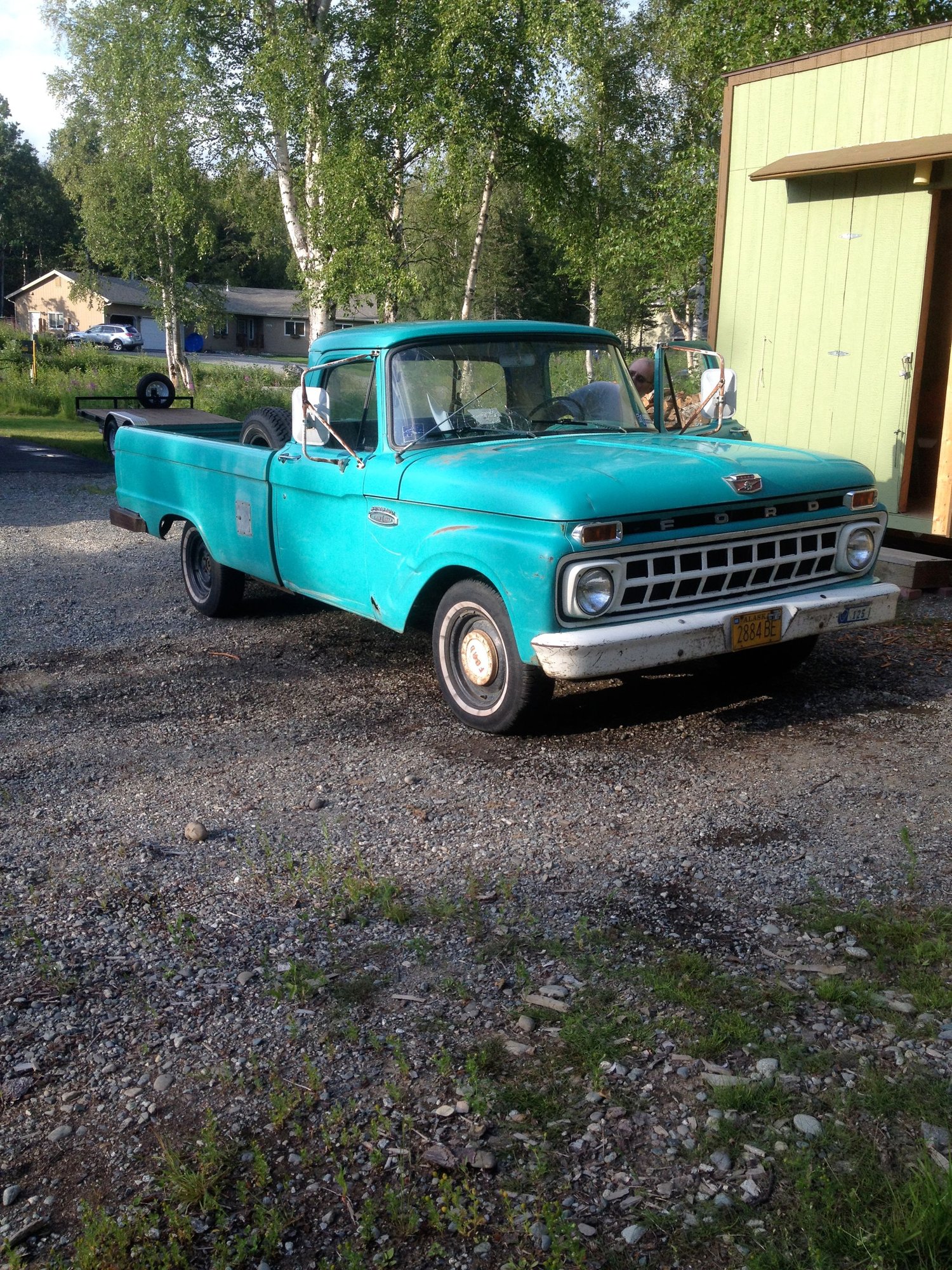

Noobie here with a decode request
Hi,
I recently bought a 1965 F100 from the original owner.
She's been in Alaska her whole life and I plan to bring it back as close to new as I can afford to do. I love looking at it but I got her to drive. So the restoration work will have to be done during our long dark winters.
Thought I would get you guys to tell me what you can about her. Far as I can tell, everything is original except the transmission. The owner said he had the 3 speed tree shift replaced with a 4 speed floor shift when the truck was only about a yr old. The 4 speed seems to perform nicely but I would like to get the column shift to put back in it....partly for the kick of shifting on the column but mostly so that when my wife and little boy ride with me, the person in the middle isnt having their knees cracked by the shifter. Any advice on the subject of transmission swapping would be greatly appreciated.
Anyway my VIN is: F10JK687585
Color: B
WB: 129
Body: L81
Trans: A
Axle: C2
DSO: 744159
