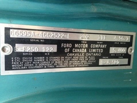

VIN Decoding,,, Please
Would one of you be willing to tell me what you can about my "new" purchase please?
Thanks
Sheldon
Thanks
Sheldon
I don't know of any FTE member that can decode this Rating Plate and the codes stamped thereon, as it's Canadian only, not the same as US trucks.
You might try mercurypickups.com

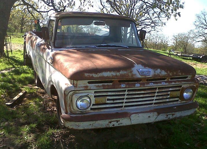

This truck was given to me by my Grandpa over 25 years ago. Can you tell me more about it from the VIN #?
F10JK411463
Thanks,
Old Sep 11, 2014 | 03:22 PM
  #313
NumberDummy's Avatar
NumberDummy
Ford Parts Specialist
Posts: 88,826
Likes: 785
From: Simi Valley, CA
Originally Posted by 16colt
Welcome to FTE
F10 = F100 2WD
J = 223 1V I-6
K = Kansas City MO Assembly Plant.
411463 = 1963, assembled May 1963.
114" Wheelbase.
T = Sandshell Beige.
F100 2WD, 5,000 lbs. GVWR
66A = Uni Standard Cab Pickup.
A = Ford type 3.03 3 Speed Manual all Syncromesh Transmission.
12 = Ford 9" Rear Axle / 3.89-1 / No Limited Slip / 3,300 lbs. Rear Axle Capacity.
5,000 lbs. Gross Vehicle Weight Rating.
114 net HP @ 3,600 RPM
65 = Oklahoma City OK Ford District Sales Office, where the original selling dealer ordered the truck from.

Here is a picture of it.
Soon to be rebuilt and back on the road
