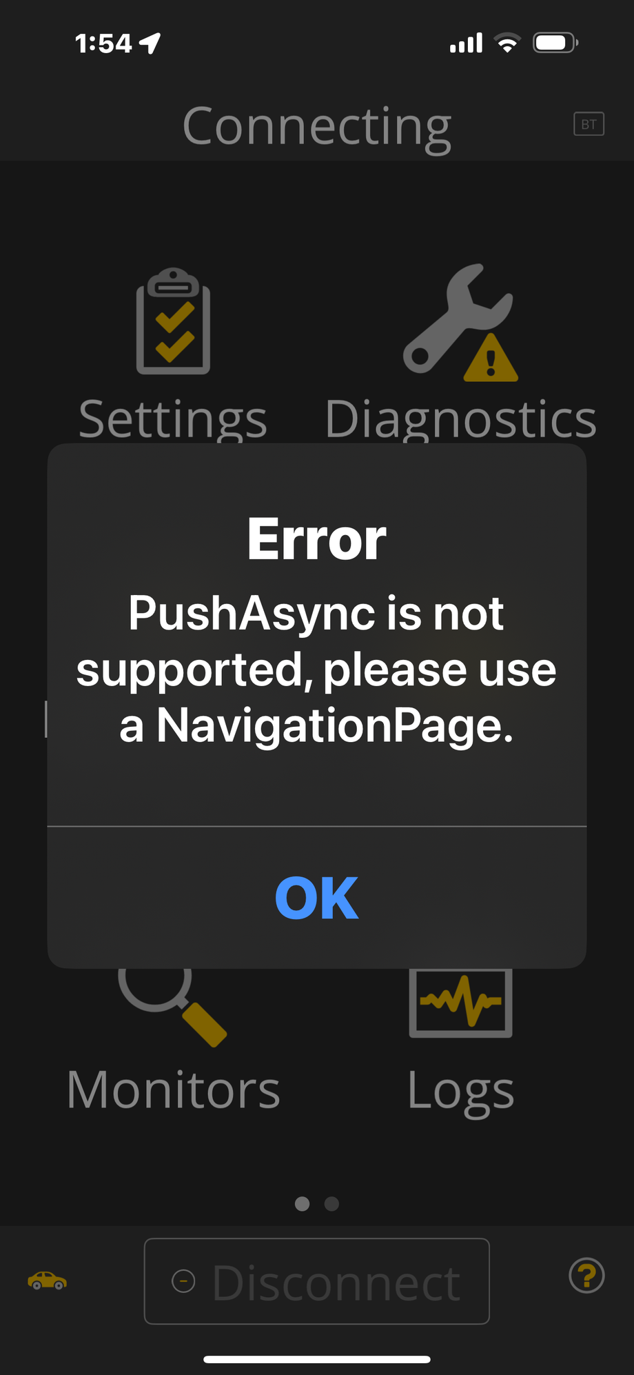

There’s something wrong maybe ecu the OBDLINK is linked to iPhone but in the link page it won’t connect FORscan is installed but can’t link with OBDLINK this a f@#$ing disaster brand new batteries now this morning it started barely all it will do is idle let it warm up now it won’t start and I can’t get anything to link up right it’s such a great start to the week I’m outside 45 knot wind 28 degrees I’m just loving it

I got somewhere in FORscan I think every code was up I cleared codes thinking I would only get current ones can’t get anything in FORscan but I get the pic in OBDLINK

Have you set your WiFi network on your i-pohne to OBDII?

I don’t see that option on my phone processes going through Bluetooth
