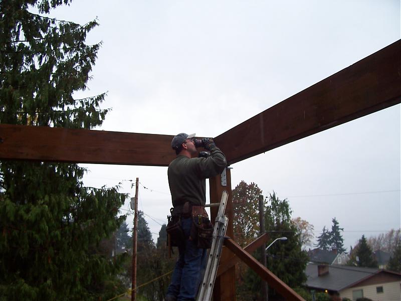

Originally Posted by Powerstrokedlariat
Attachment 11834
This is at the high point, now I'm just being cocky... Having coffee 25' up on a ladder in the mud. I was trying to show my employees that stuff has got to get done, one way or the other.
Dude... No need to get cocky with your deck!! We can see for ourselves.
