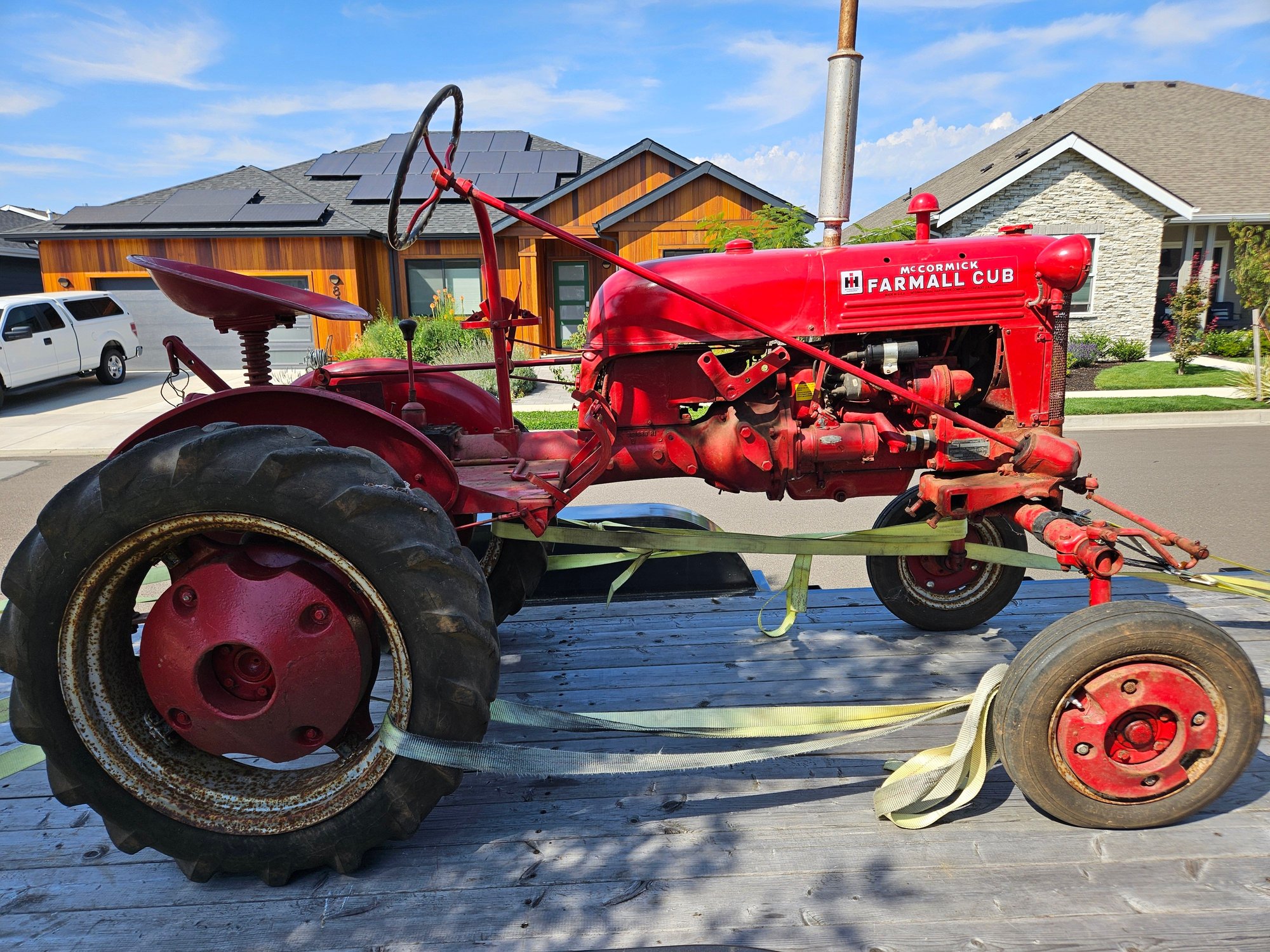

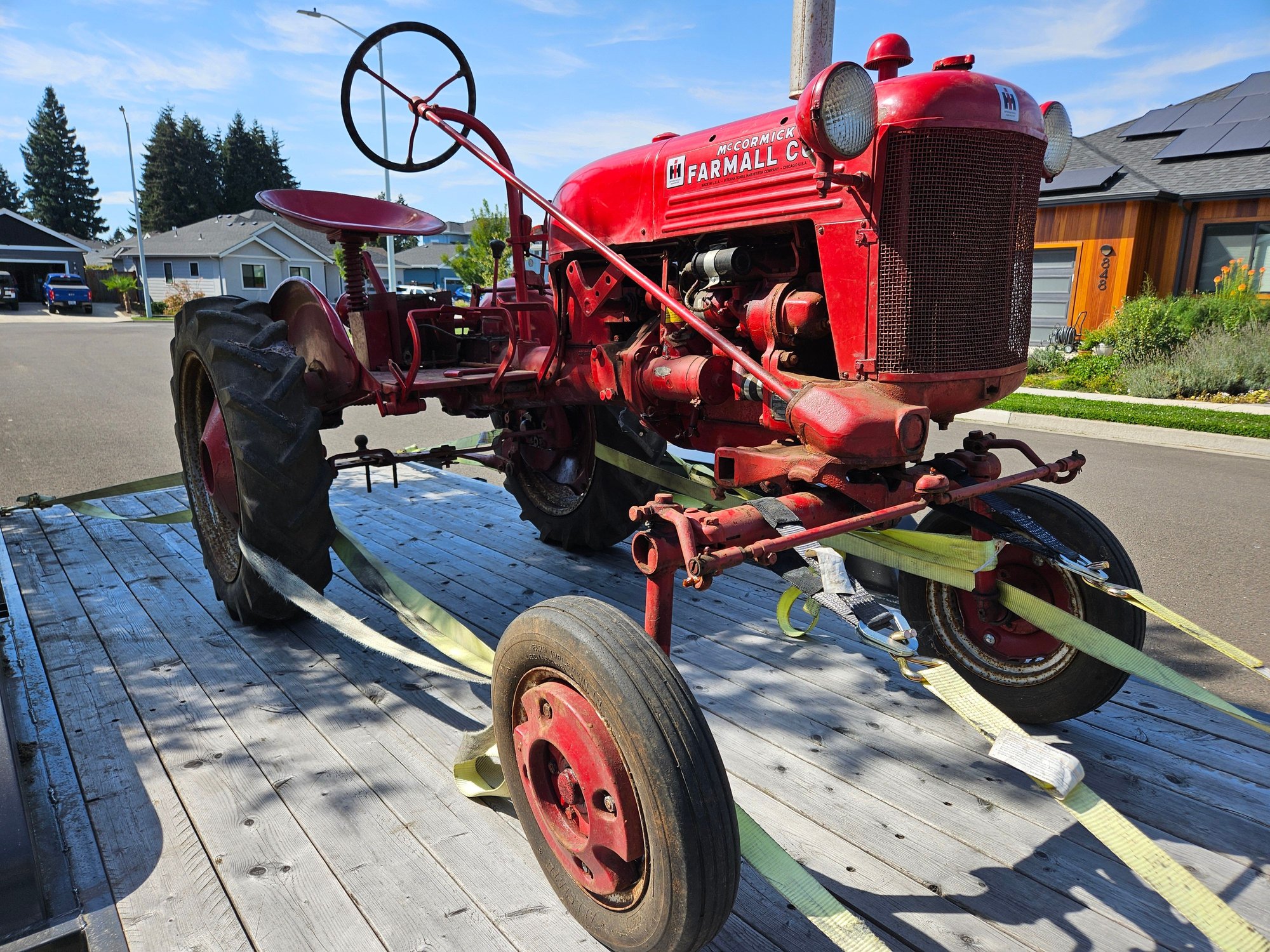

Here's the Cub I'm bringing home.

Trustin, Cool tractor, looks like it is in great shape. Thanks for the photo.

Trustin, nice looking Tractor and a fun project.
