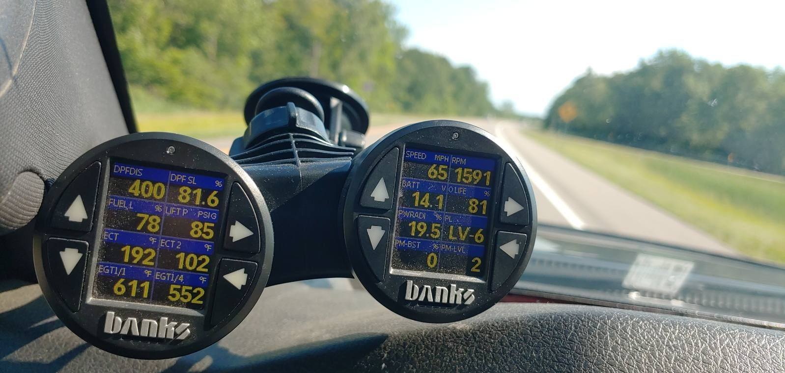

On the earlier 11 to 16s, with the LCD gauge display, it briefly displays "CLEANING EXHAUST FILTER" but it's easy to miss... the newer trucks ceased to do that. But the earlier years it did not display on XL gauge display... I like to complete my active regens on the expressway that runs south from the city has long hills to climb... gets the EGTs hot.
I use a Banks Power iDash, actually two of them now. Stand by and I'll post a few pics from phone.
EDIT
Seems the forum is having an issue... on my work computer now and having problems like I did on my phone. I'll post later.
These are the screens I monitor everyday... iDash Left #1 average distance between regens #2 DPF soot load % which normally does not match truck
#3 fuel tank level % #4 the primary fuel pump pressure before the HPFP
#5 primary cooling system temp #6 secondary cooling system temp
#7 EGT #1 sensor after turbo #8 EGT #4 sensor at the exit of the DPF
iDash Right #1 speedometer as mine is off by two mph #2 tachometer
#3 battery voltage #4 OLM (oil life monitor)
#5 Banks Derringer tuner reading of % of power added #6 Derringer in level 6, but now have had it in Level 3 for quite sometime now
#7 Banks Pedal Monster added response % #8 in Level 2 in Track Mode, the highest mode of throttle response... levels are 1 through 10 in each mode; there's stock, City, Sport, and Track.
Green screen on left iDash is my active regen screen I put it when she goes live. #1 Status is ACT/ON #2 soot load percentage which starts to drop, burn off, when hot
#3 EGR#1 sensor temp (exhaust gas coming in from passenger side exhaust manifold)
#4 EGR#2 sensor temp (cooled exhaust gas going to the intake manifold)
#5 EGT#1 sensor temp #6 EGT#2 sensor temp
#7 EGT#3 sensor temp #8 EGT#4 sensor temp
Any other questions., let me know...
