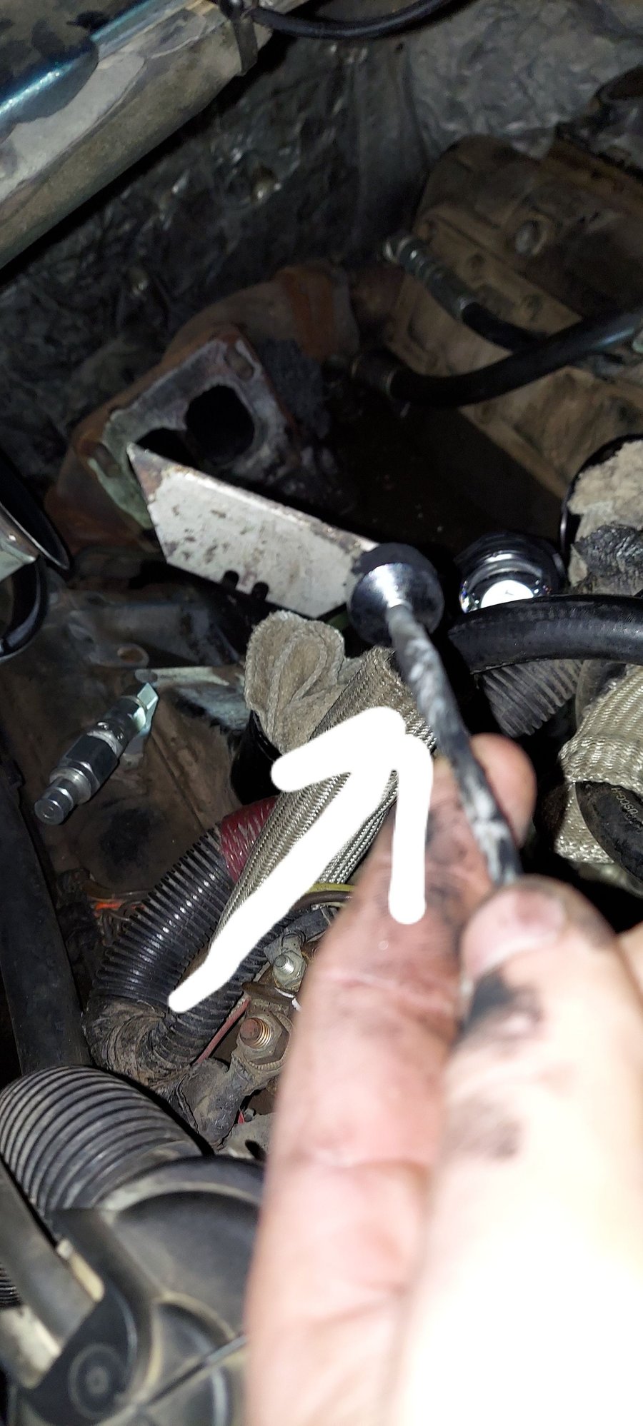

So far I've gotten as far as removing the spider, but after I removed the sensor plugs, I noticed a 10mm bolt at the bottom with what to me at the time appeared to be a flat grounding cable (it was covered in grease so, I didn't know what I was looking at). It was the only thing holding back the spider so I decided to take it out. Once I got it out the cable that the strap was hooked to pulled and the bolt disappeared into the ether. My plenums were open and I don't have the mesh on the inside of mine, so I have no idea where the bolt went. I am scouring every inch of my garage floor with a sweeper magnet and I'm getting ready to do one more expedition into the engine bay before I start removing parts. I did read the thread of the guy with the van and I very much feel his pain. Thanks for posting that.
I stuck a camera down the plenums and didn't see anything, but I feel like I need to take them off to know for sure. What I don't know yet is what I'll do if I don't find anything...roll the dice and start it up or dig deeper and pull the heads? uggg.

I just removed the passenger side and I don't see anything down there. But the camera I have has too large of an end on it to get all the way in there. I'm getting a different camera tomorrow so I will try it then. I also tried the ol' shop vac hooked to a small hose trick and I didn't catch anything. On to the drivers side...If I don't find anything I'm going to roll the dice and put it back together.
Anybody have experience replacing the plenum? Should I remove the wiring harness to make more room?
