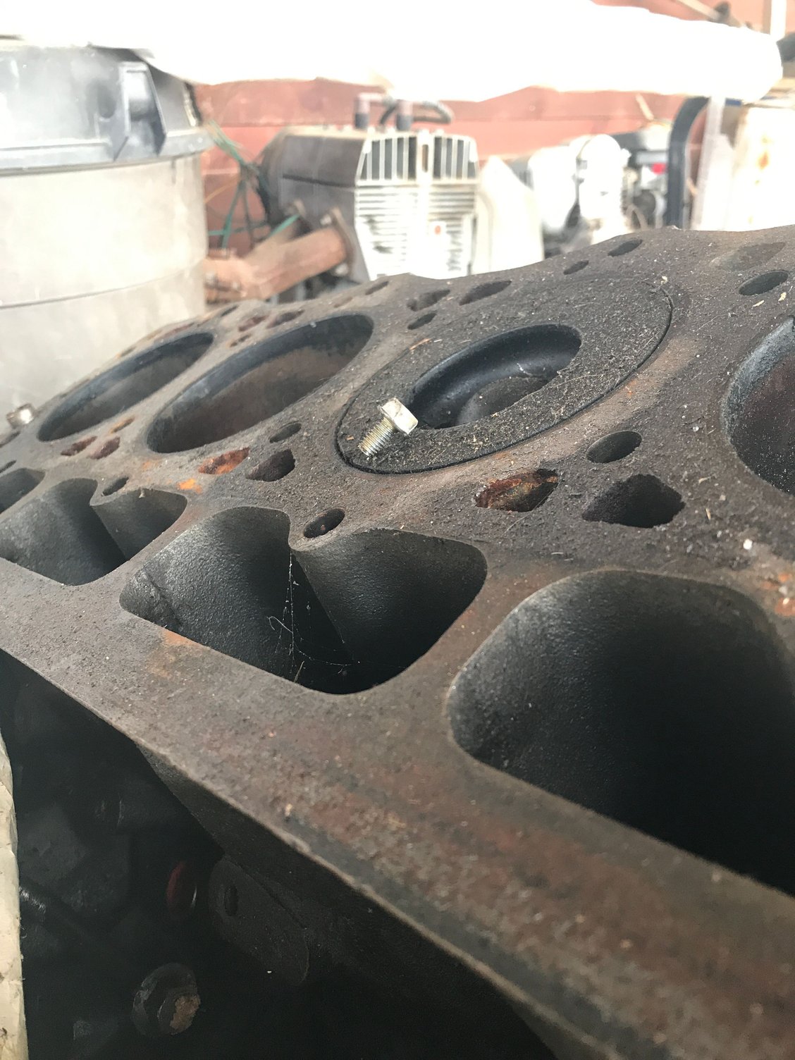

Pretty sure valve doesn’t open enough to let this bolt pass through. Even if this happened the bolt would be ejected from bowl and there is NOT room between piston and head for the bolt.
Ive seen broken GP cause CARNAGE and it is a fraction of the size of this bolt.
The worst case scenario here is likely bolt holds valve open and piston hits valve. Even if bolt made it to combustion chamber, these options would be more than a ‘ticking’ noise.
Im going to put these parts together (head/bolt) so we can see what it looks like.
Meanwhile, I hope we can find a reason for the noise on the rotating parts on front of engine.

Gooogle-fu says cam lift is 0.43 inches.
Which is good because bolt easily hides in the piston bowl.

I don’t have an easy way to measure lift, but from here I could not push the bolt through the opening. More importantly, I could easily fish it out with a magnet even after messing with it using a heavy copper wire trying to fish it through the valve.
