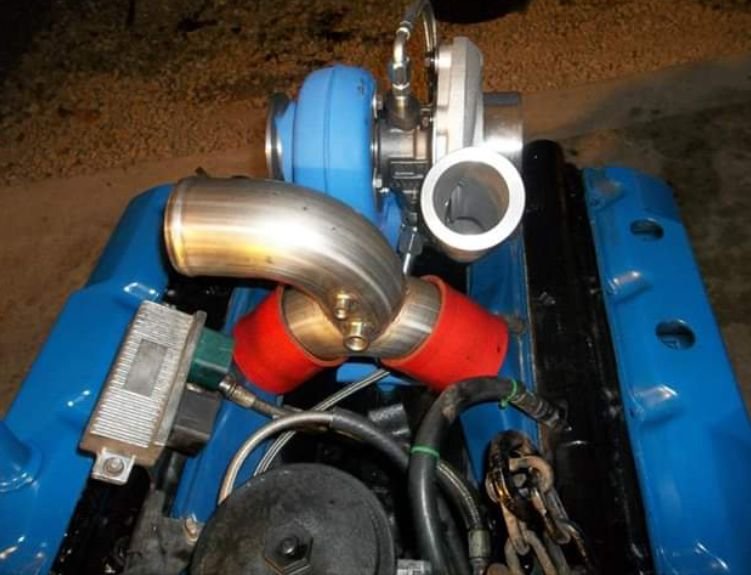

I usually tape the opening up with green or blue painters tape immediately after the intake is removed. This time though I think I will use the rubber glove method that Wes444 suggested. I think it would be funny to look into the valley and have the gloves and maybe the fingers sticking up a bit. Might bring a laugh or two from the pictures of the new T4 turbo going in.
Thats my method as well. Here’s a link to a post in my turbo install thread for a chuckle. Rubber Glove high tech port protector You can see the blue rubber glove covering the turbo inlet. I use normal gloves and socks to cover the turbo ports during storage as well. I’d say Dmco could attest to receiving a 364.5 in such condition.
edit: I hope the OP enjoys random off topic banter. Well mostly off topic anyhow, we are discussing covering the plenums...

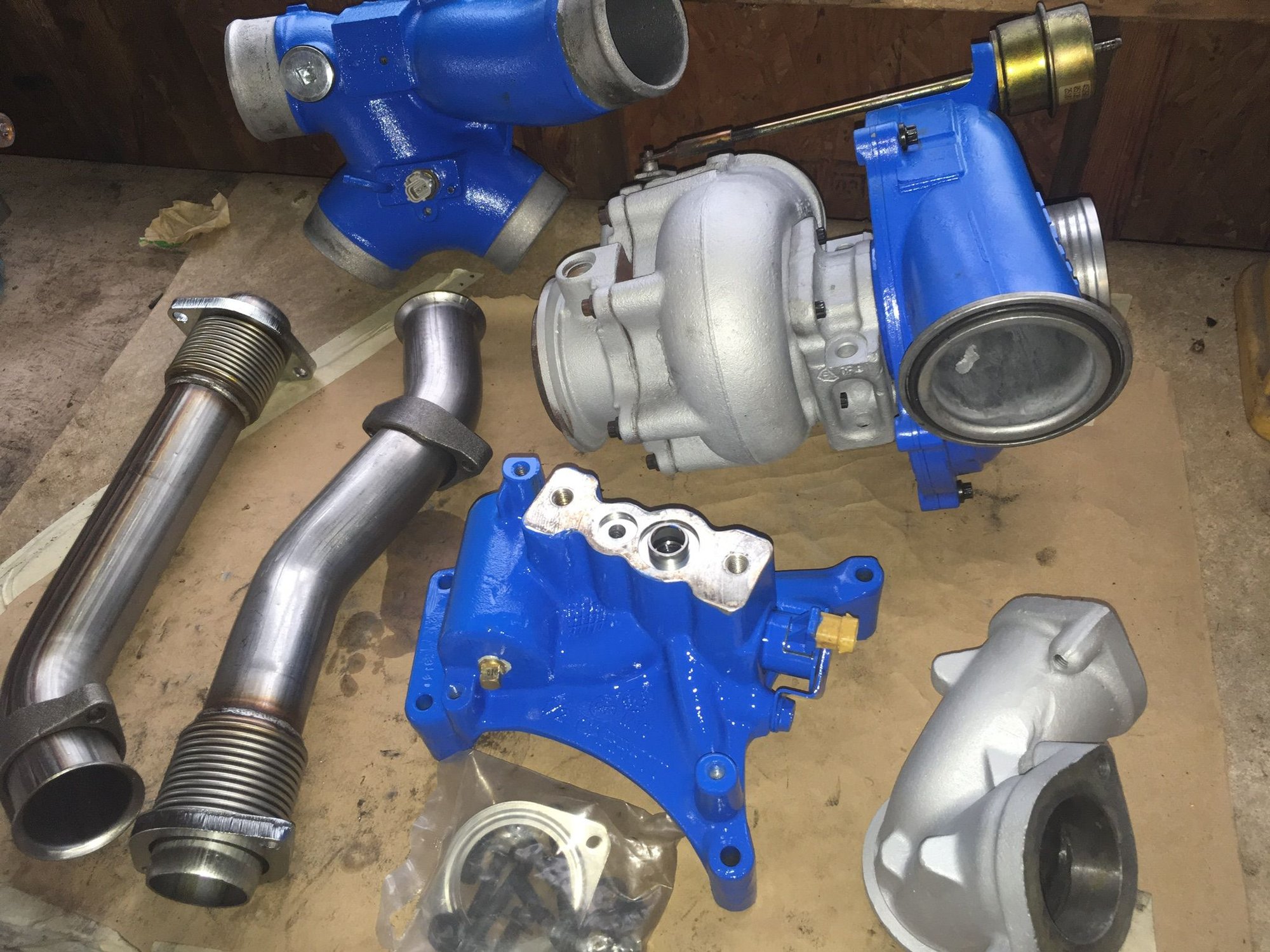

Answering. Yes, definitely clean and paint everything you take off!!!
Yeah, I delete the red and green hoses and crank the adjustment all the way down on WG actuator. You can’t hurt the turbo with stock injectors.

If the bolts didn’t break, you’re fine. No loctite. You really need an inch pounds tq wrench for that low (18ft lbs) and I don’t trust anything but a really expensive and well cared for tq wrench at that.
What colors of paint did you choose? Lol.
