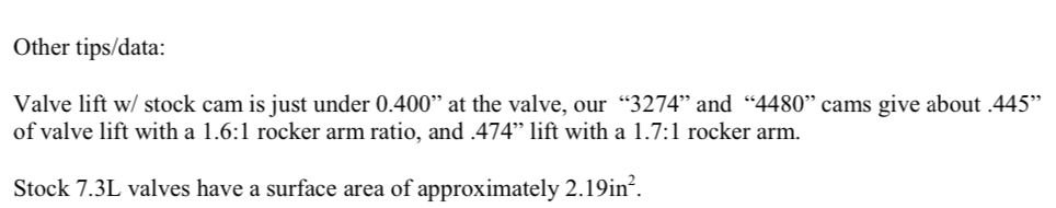

Gooogle-fu says cam lift is 0.43 inches.
@SkySkiJason but what is the valve lift? I have no idea of the rocker arm ratio on these monsters but can do some googling in a bit.
As url mentioned, your truck looks awesome in the video. I meant to mention this earlier and got distracted.
edit: no luck with google... I guess rocker arm ratios isn’t something commonly discussed on the 7.3. Or my google skills are lacking.
I did find this but it goes against what SSJ found and would point more towards 0.4 as being a valve lift.

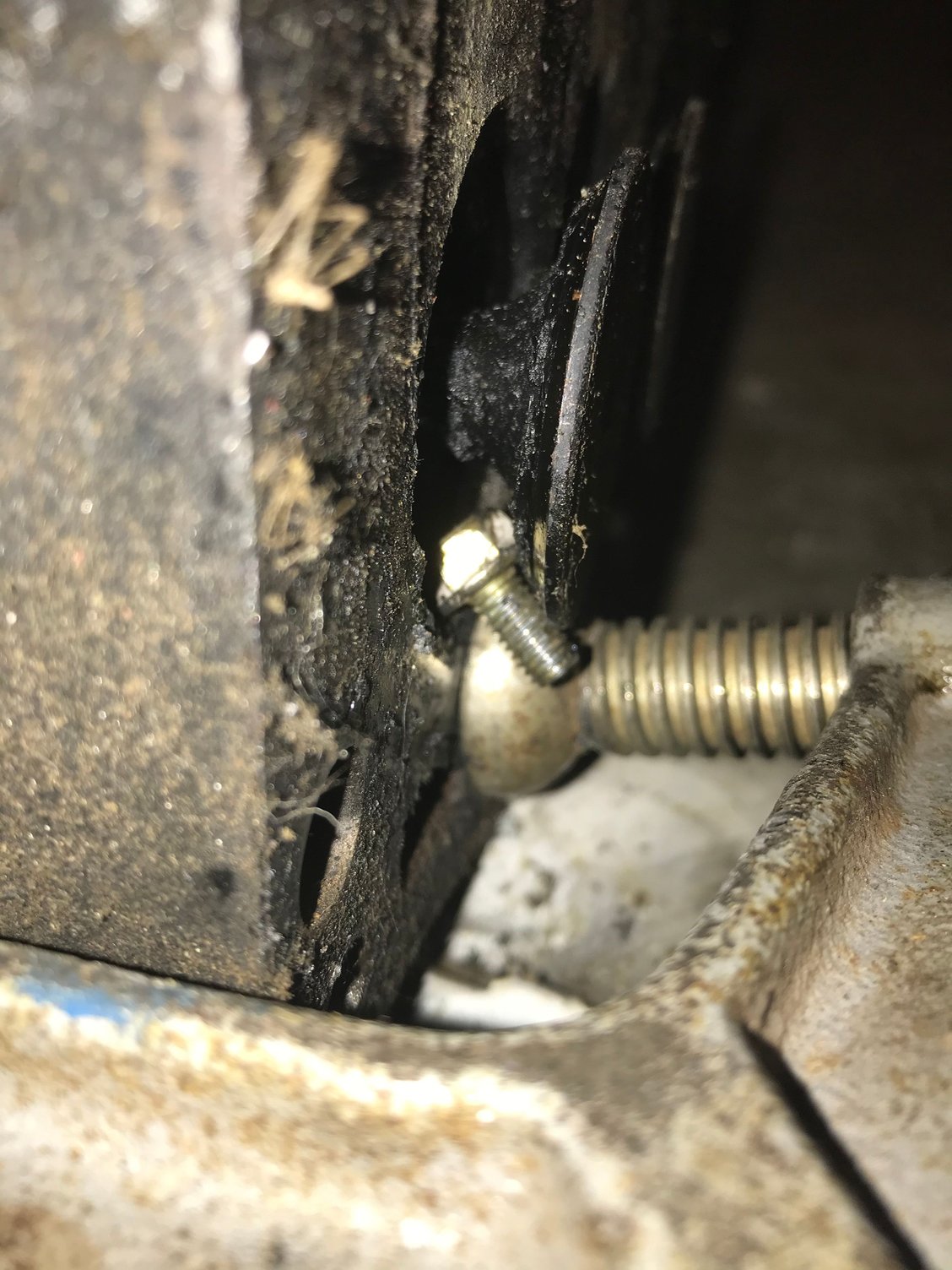

I opened valves to ‘about’ 1/2” using my fat max tape measure...
I was able to get bolt way down in valve, but not through it.
This pic is like a kick in the gut.

@SkySkiJason but what is the valve lift? I have no idea of the rocket arm ratio on these monsters but can do some googling in a bit.
I asssssumed 1:1 rockers because they look like that (pivot in the center)... But, you are correct - actual lift could be more or less.
My last pic looks like a LOT of lift!!

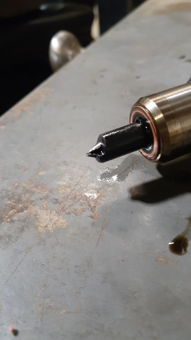

Here is the damage from nothing but a piece of injector nozzle tip:
If THIS is the case, the piston would hit the valve and instantly F-it up making it lose a seal on its seat. You'd have a misfire and popping through the intake tract. I hope NONE of this happened.
It was not easy to get the bolt there and I feel that the valve does not open that far - so the scenario in picture is probably not possible. But, in the unlikely event the bolt was in there I could see it holding the valve open.
Until I literally pushed the bolt into the position in the pic, I easily fished it out with a magnet.
