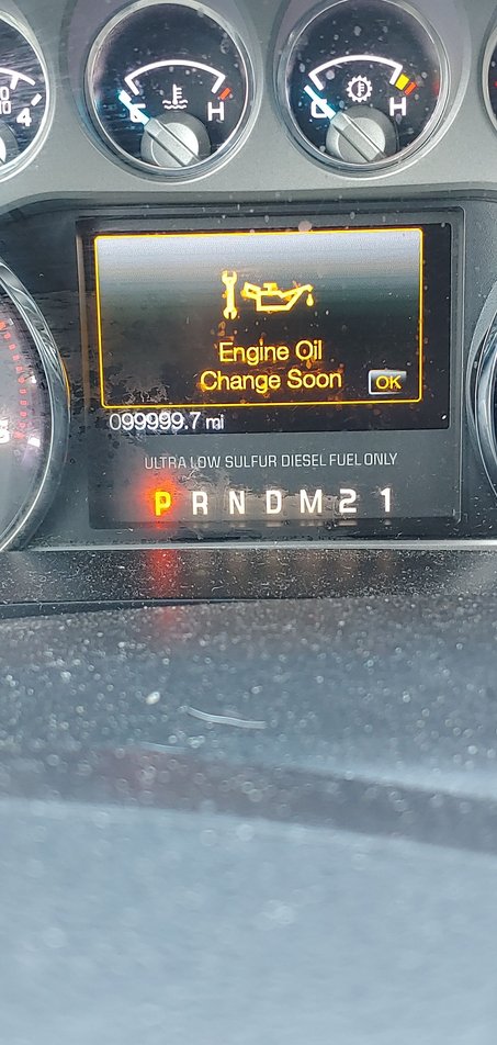

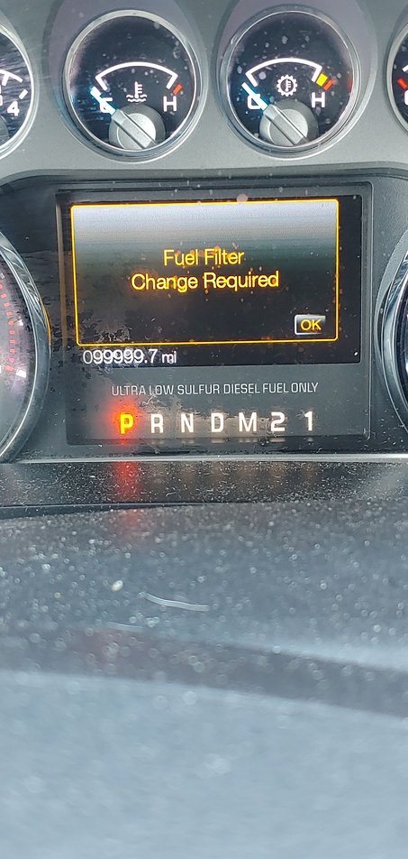

Oil change/fuel filter change>> how many priming cycles do you use?
I changed my oil this past Monday...

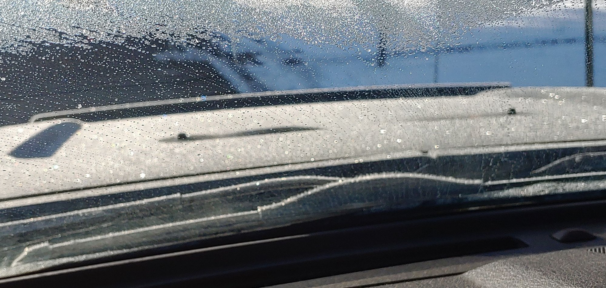

Took her for a ride to get it hot... Perfect day to change it... Sunny and in the 20s. Not bad at all. Warmed up in the 30s.

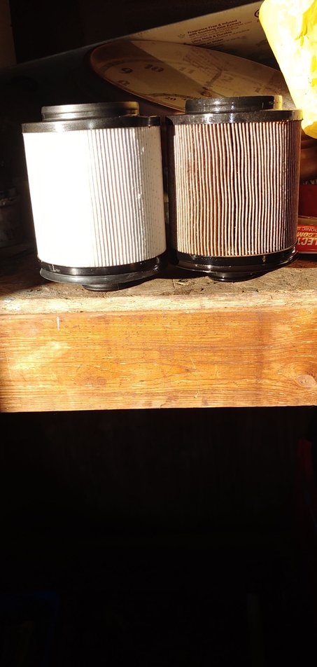

Just over 22k miles... Filter didn't look bad.
Next to the new filter.
Genuine Motorcraft set only.
I went with about 20 priming cycles... At least 18.
I used to do just 12 to 15... And the engine would crank a little on restart... Not immediately fire up. This time she did. So I will do this from now on... 18 to 20 priming cycles for the fuel system after replacement.
How do you guys make out with yours? How many cycles do you do?

Good job waiting for the truck to say when the filter needed to be changed. I don't know how many cycles because I let the dealer do it. I don't have anyplaced to get rid of the fuel. Also noce to see you waited for the truck on the oil as well. I think these trucks are smart.

That's what I've done, but have had at two changes at 5k miles I think at the dealer where I bought but would have to check my notes...
In the past, I've just drained my fuel in my used oil containers because my buddy's shop uses an old school shop heater with used oil...
Now I have smaller containers that i use for the fuel... the fuel that was drained, there was very little stuff that came out with it.. looked pretty clean at the bottom of the cap. The DFCM filter looked good too...
I've been getting my oil analyzed for awhile now and it always comes out good at the truck dictated OCIs.
