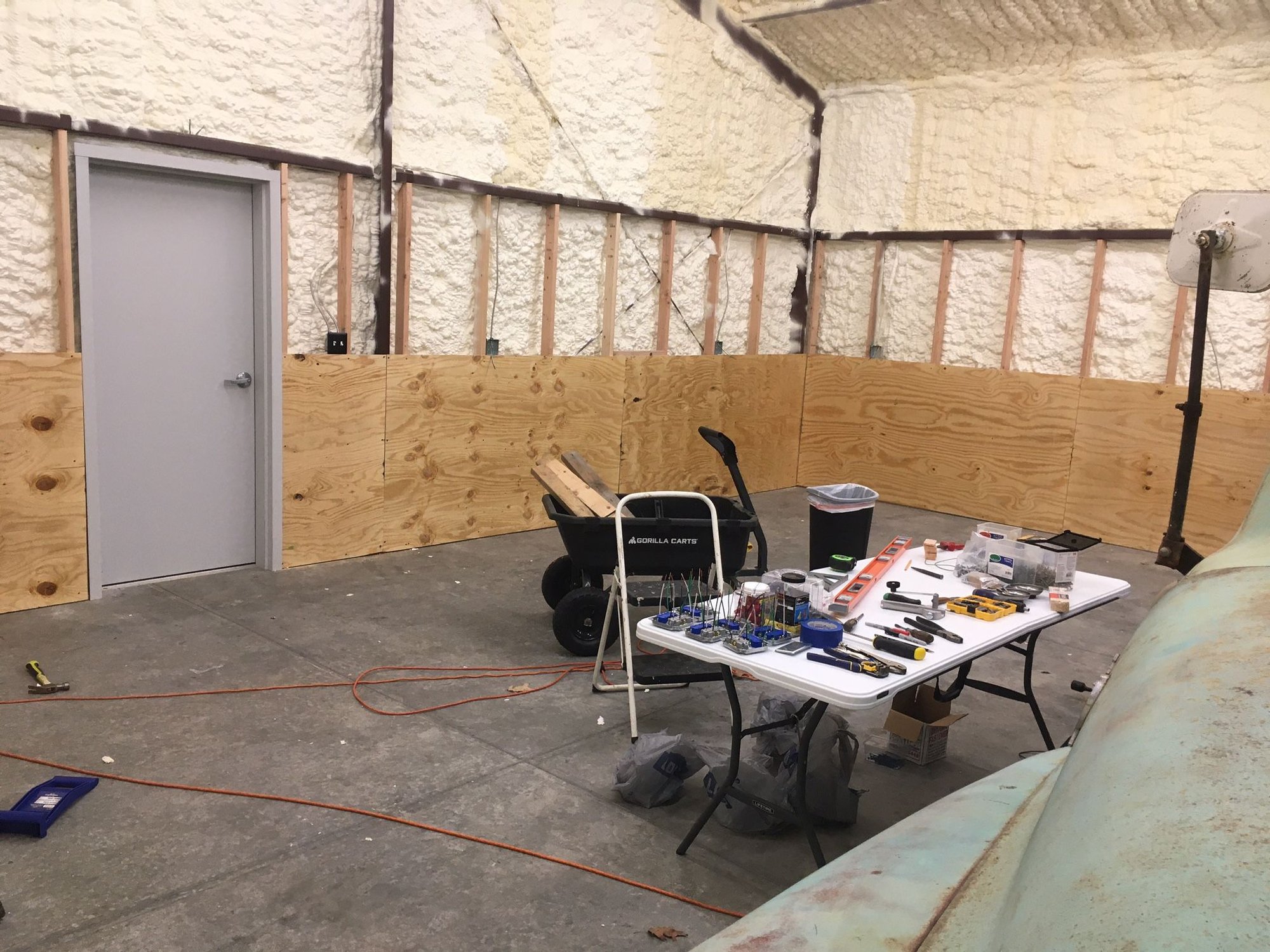

I made some progress today. I need more studs before I can put any more plywood up. Well I also only have one sheet of plywood left I need to plan a trip to get more.
Definitely novice work, but it's not too bad.

Originally Posted by Harrier
Dang Abe, that's a bit too warm.
Peg board all the way around above the plywood or just where your workbench will be? Is pegboard cheaper than plywood? Beware the pegboard hooks are not cheap!
I won't do pegboard all the way around. The section in this picture will be plywood. I was staring at the walls earlier this evening pondering where the pegboard will go. I'm thinking probably 3-4 sheets in the back wall and corner at the side of the shop that has the garage doors.
It looks like a 4X8 sheet of pegboard is about a dollar more than 3/8 inch plywood.
My wife stopped in this evening briefly. She didn't seem too impressed. She asked if I was going to cover all the insulation. She mentioned putting steel panels on the ceiling. I'm wondering if she is having plans for my shop. Covering the ceiling would be a pain!
