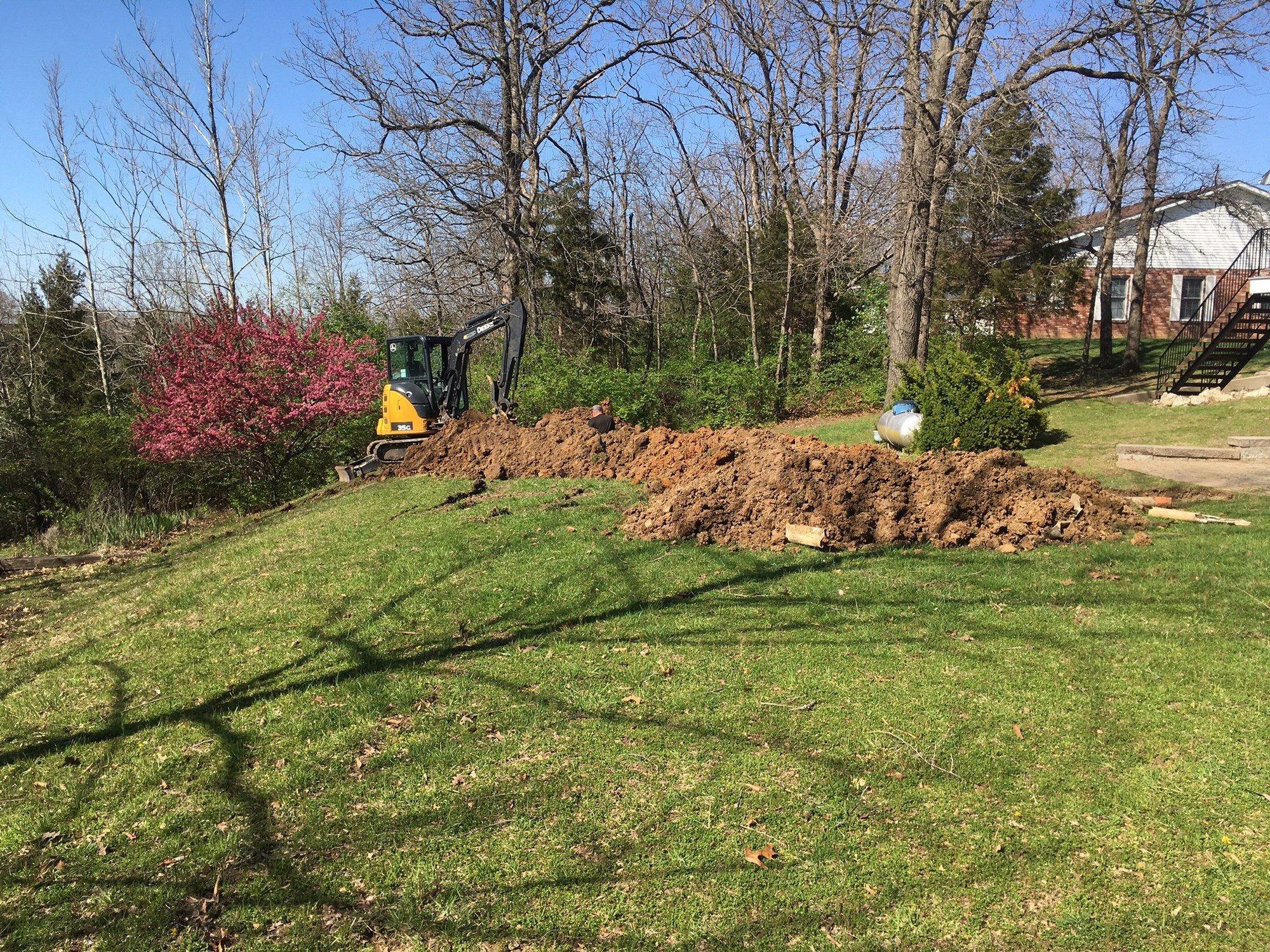

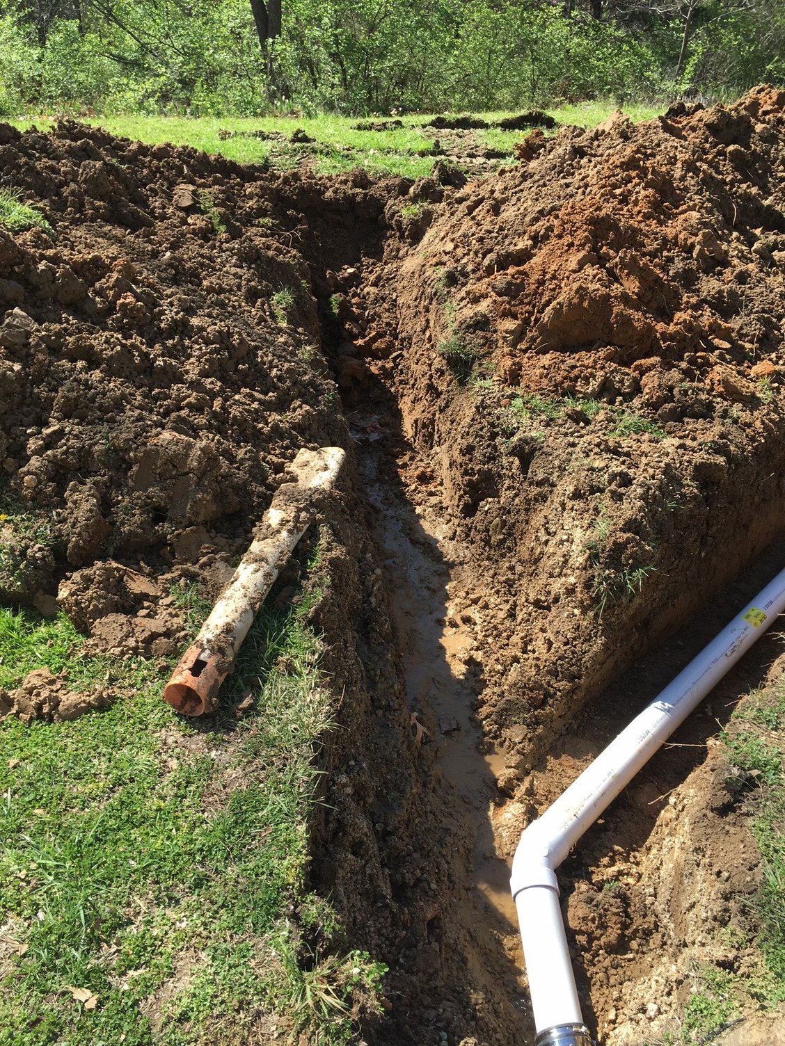

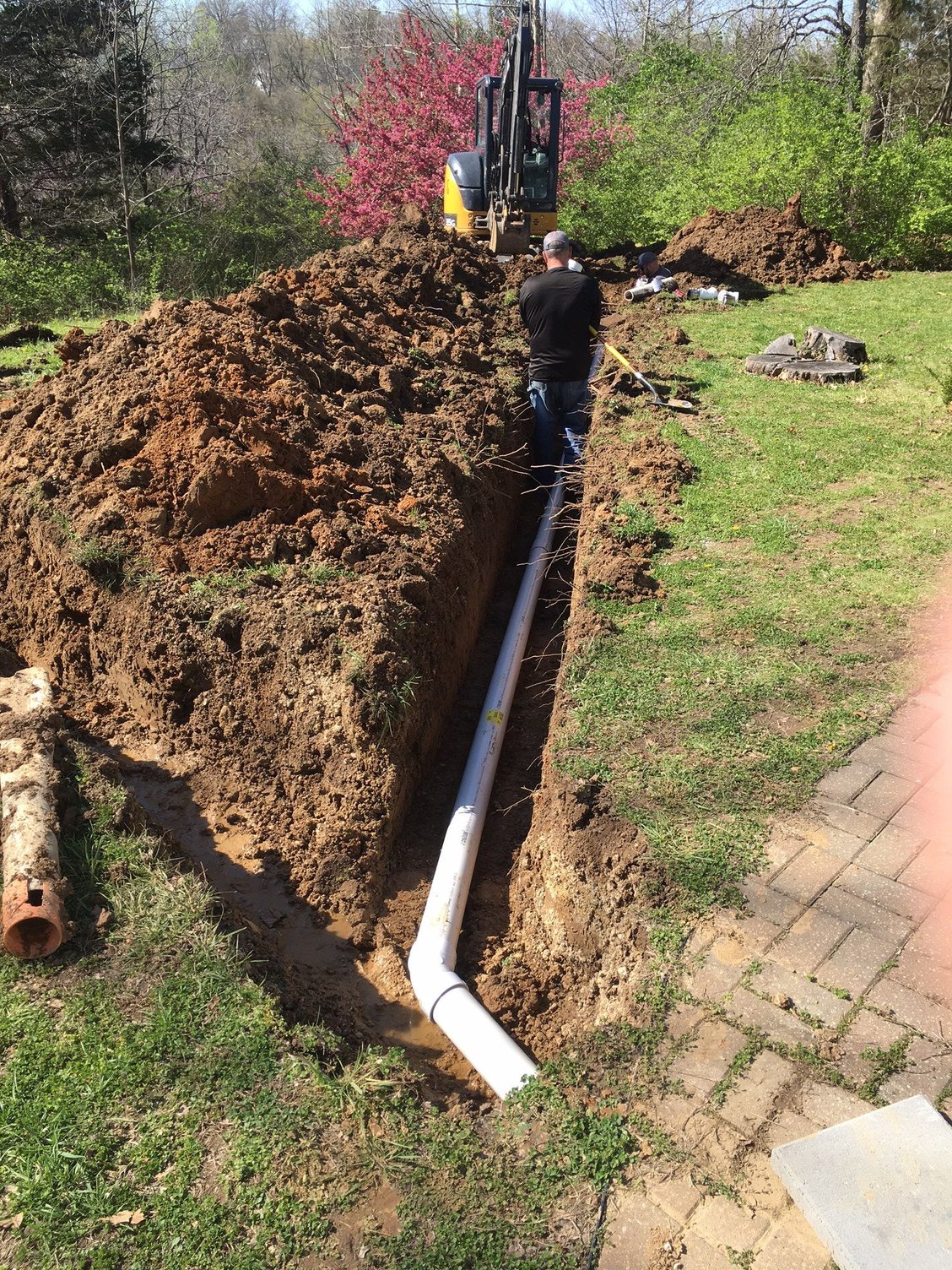

Some bad news on my future lift. Below are pictures of where that money is going.
We had a backup in our sewer. Fortunately it didn't back up into the house, the cleanouts popped their caps. I still have a mess to clean up though.
Now the crazy part. The guy that came out to hydrojet the lines to go stopped. So he dug a hole to find the pipe and it was caved in. That guy doesn't do dig work so I had another guy come out. He found a second cleanout. So our house is divided with two lines leaving the house. Well the line that was clogged (our master bathroom) actually just went straight out to ground in the woods behind our house. Highly illegal. I can't believe a plumber would even think of doing that. My plumber wondered if my master bath was an addition, but it wasn't. This plumber did this on a new build. It would have been just as easy to run the line to the other line that does go to the sewer. I'm tempted to report it to the city. I have no idea who the plumber was and not sure if I can find out. That's just wrong on all accounts. But, I'm fixed now.
Another note, get quotes from more than one company. One company just looked at the hole that was dug and said $3000 if it is just to fix the broken section.$8000-$10000 if they had to dig to the sewer line (about 50-75 feet). The guy that did the work said $1200 to the sewer unless there are problems. I'm sure it will be more than that since he dug out the broken part and found the illegal dumping and had to dig sideways to the true line. But it will still be $5000 cheaper at least than the other company.

Ouch!!! To bad you didn't know this before hand. You could have tapped into it for your shop? Stay positive Joe!

That hurts. I would definitely be down at the planning and inspection department asking how this got by them.

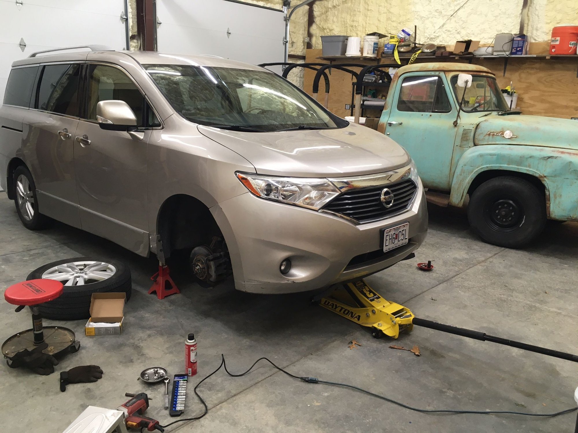

Good news though. I have been wondering how my brake pads were on my van. It was parked in the shop so I decided to take a look. They were due for replacement on the front.
It was so easy to get this done having my tools and room. I know people do a lot of great work in cramped spaces, but man it's nice to have the room.
My goal is to keep the two bays uncluttered so it remains easy to get around the vehicles as well as have space for entertainment. We will be having 20+ family over for Easter tomorrow and both vehicles will be pulled out to make room for....well whatever my wife has planned.
Joe, some governing bodies maintain the list of permits pulled for all properties. I found all of mine with very little on line research at the county level. Surprised the inspector did not catch it during the build. Glad you got it fixed.

Joe, are you saying the sewer pipe just ended to the ground surface in the woods? No septic tank or drain field? I’ve been in houses where one sewer line went to city sewer, and the other line went to a septic tank. The houses were built before common usage of sewer pumps.
