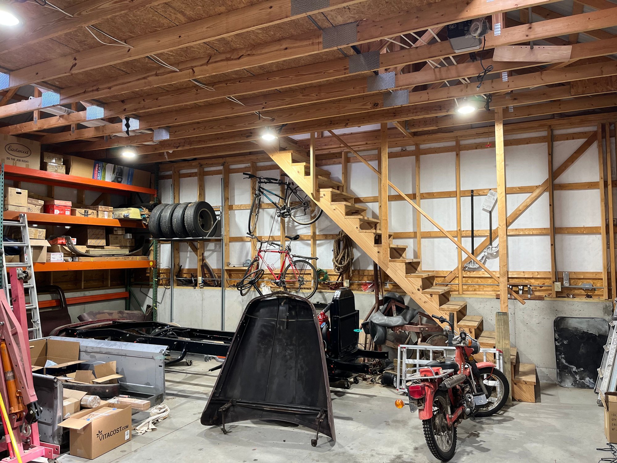

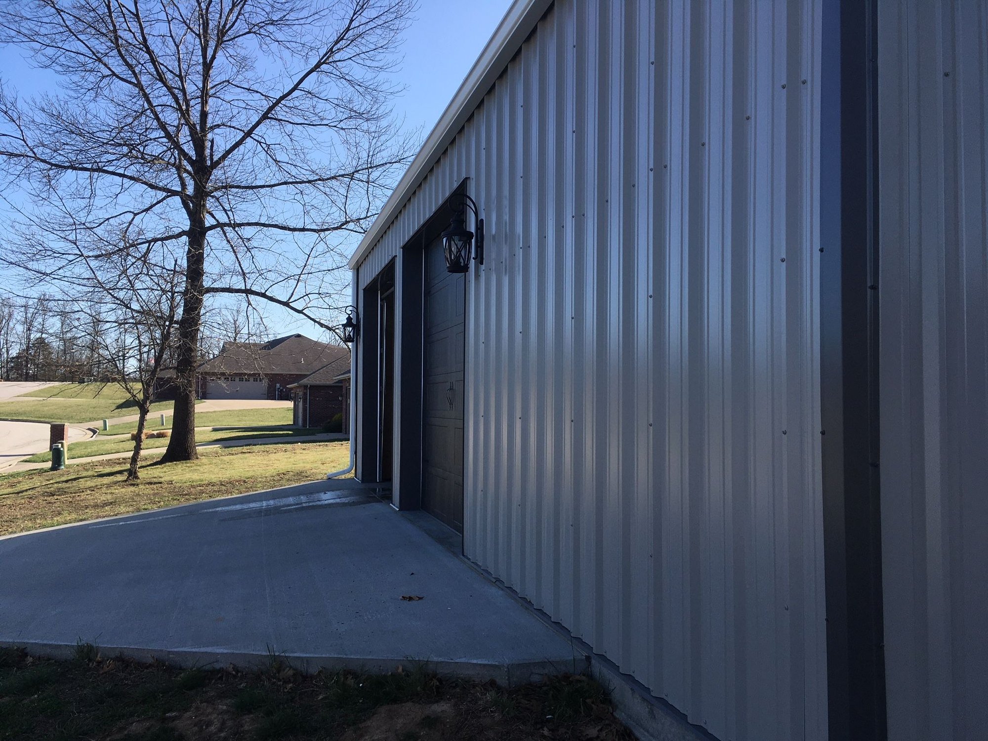

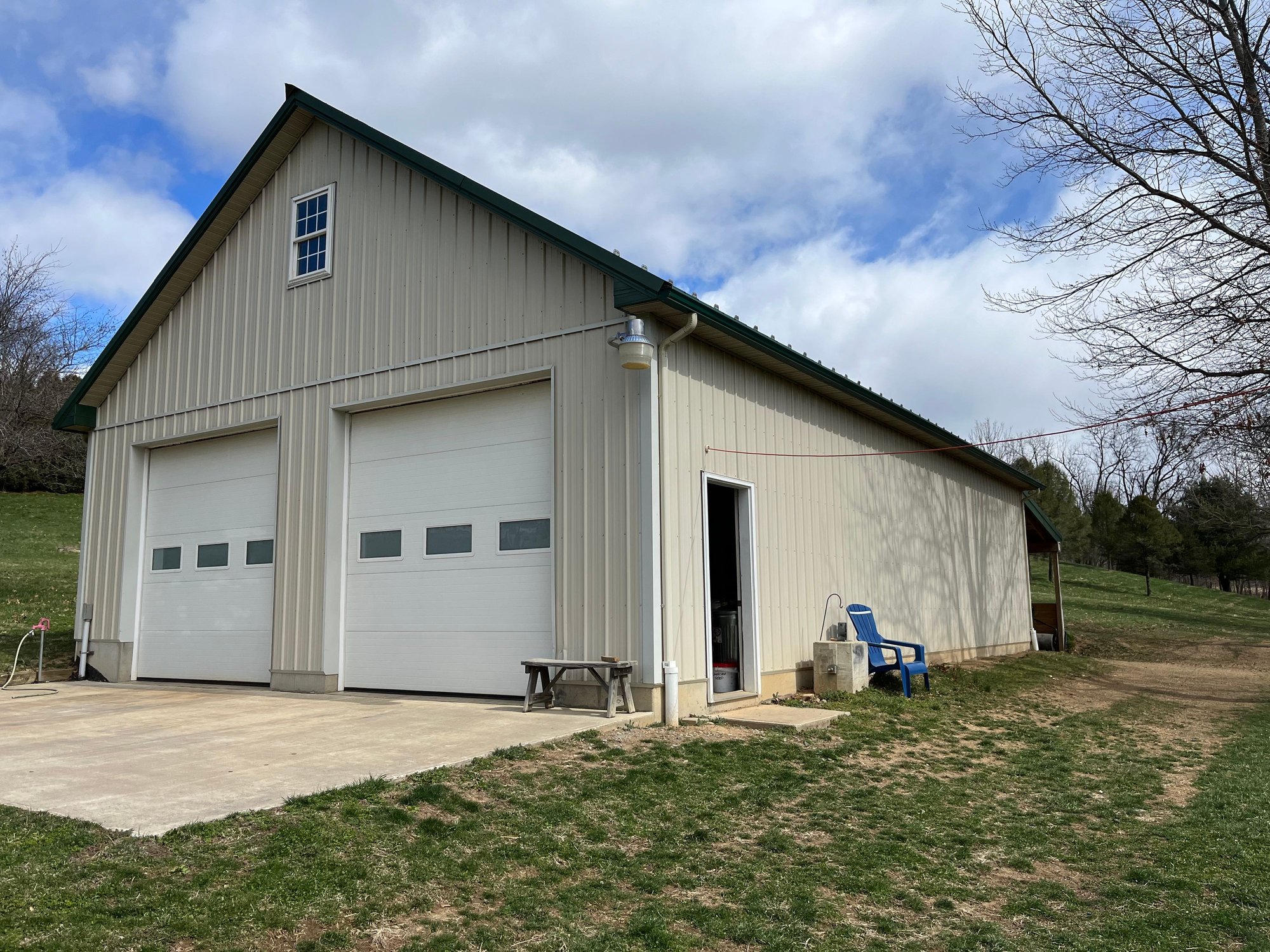

I finally got my lights up. I think that finishes up all wiring until I get a lift. I just need to caulk around the lights to seal them up.
We have had quite a bit of rain lately and I have a leak in the shop. I'm not sure where it starts. I think it might be on the roof line and coming down the wall from there. I cold never tell before because I had so much water coming in through my open garage doors. The tarps only kept out so much. Time to climb up and see what I can find...On a dry, sunny, warm day.
Here are a couple of pictures. The over the door light seems small with that large expanse around the doors. The wire run between the two garage door lights is long just in case Gwen decides there needs to be a light between the doors. I should have enough spare wire to break it for a junction.

Hope you're able to track down the leak. Might be hard with the blow in insulation.
The lights look terrific!

Shouldn't the company that put the building up he responsible for finding the leak?
Well, it wasn't a company that did the work. they all work for the same construction company, but they did the work on their own.
But, they did say if there are leaks they will come back and find them. I will get with them and have them come out.

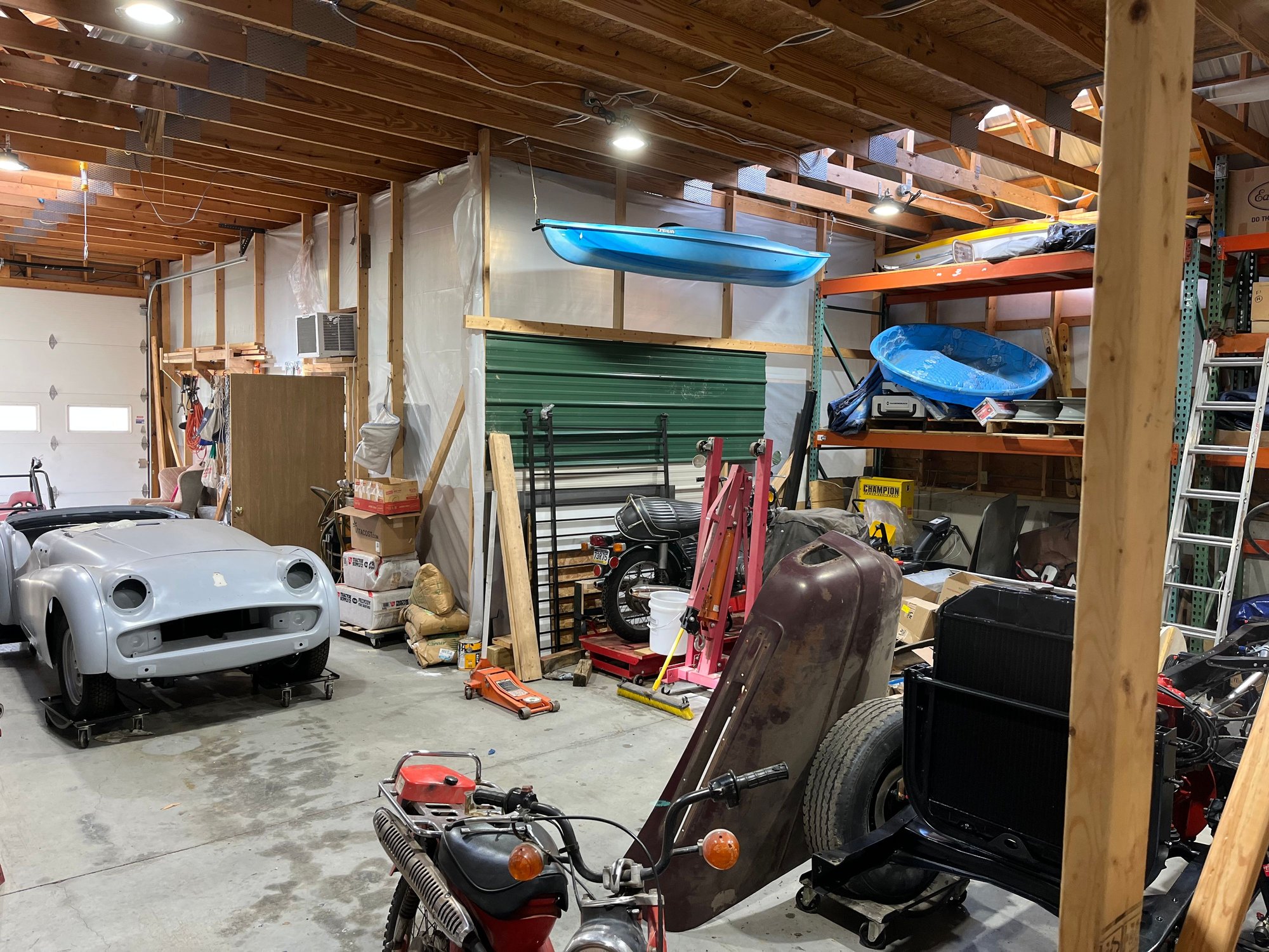

bigwin- keen eye! It's a 1959 TR3A that is my project car. The F1 truck is my wife's and I've been focused on that the past few months so the TR sits and waits patiently. It ain't easy having two project vehicles underway and It's tough keeping the parts separated. Occasionally there's a benefit (TR fuel pump and F1 pump are very similar so rebuilding one after the other was easy). Another positive is that aside from a few whitworth & british standard fasteners, the nuts and bolts on the Triumph and F1 all UNF so I was able to buy boxes of them from Bolt Depot in standard sizes.

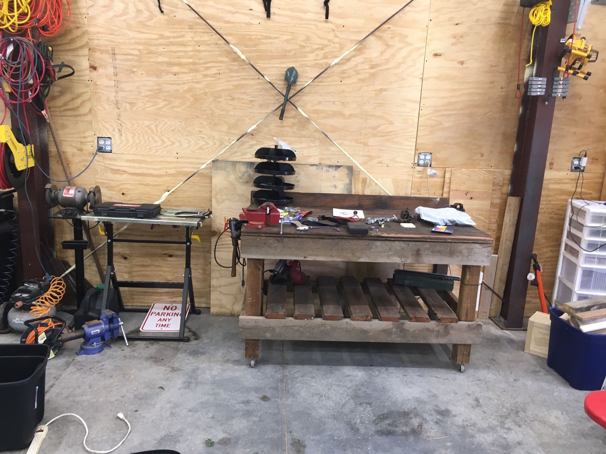

Here is my workbench in it's home. I made this out of the bed wood from the original flatbed. If I had known what I know now, that flatbed would still be on the truck. Oh well, since my son built my current one, I'm very happy with what I have.
The bench is on wheels. So, if I keep it somewhat clean, it will be great to pull over to the truck when I'm working.
