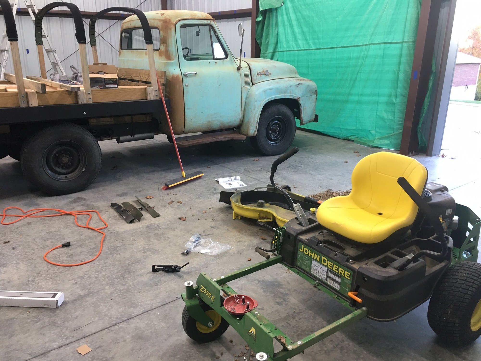

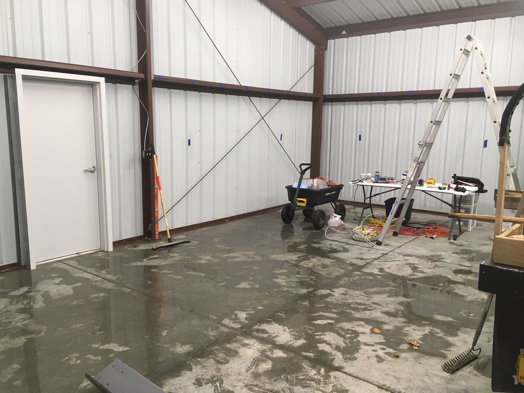

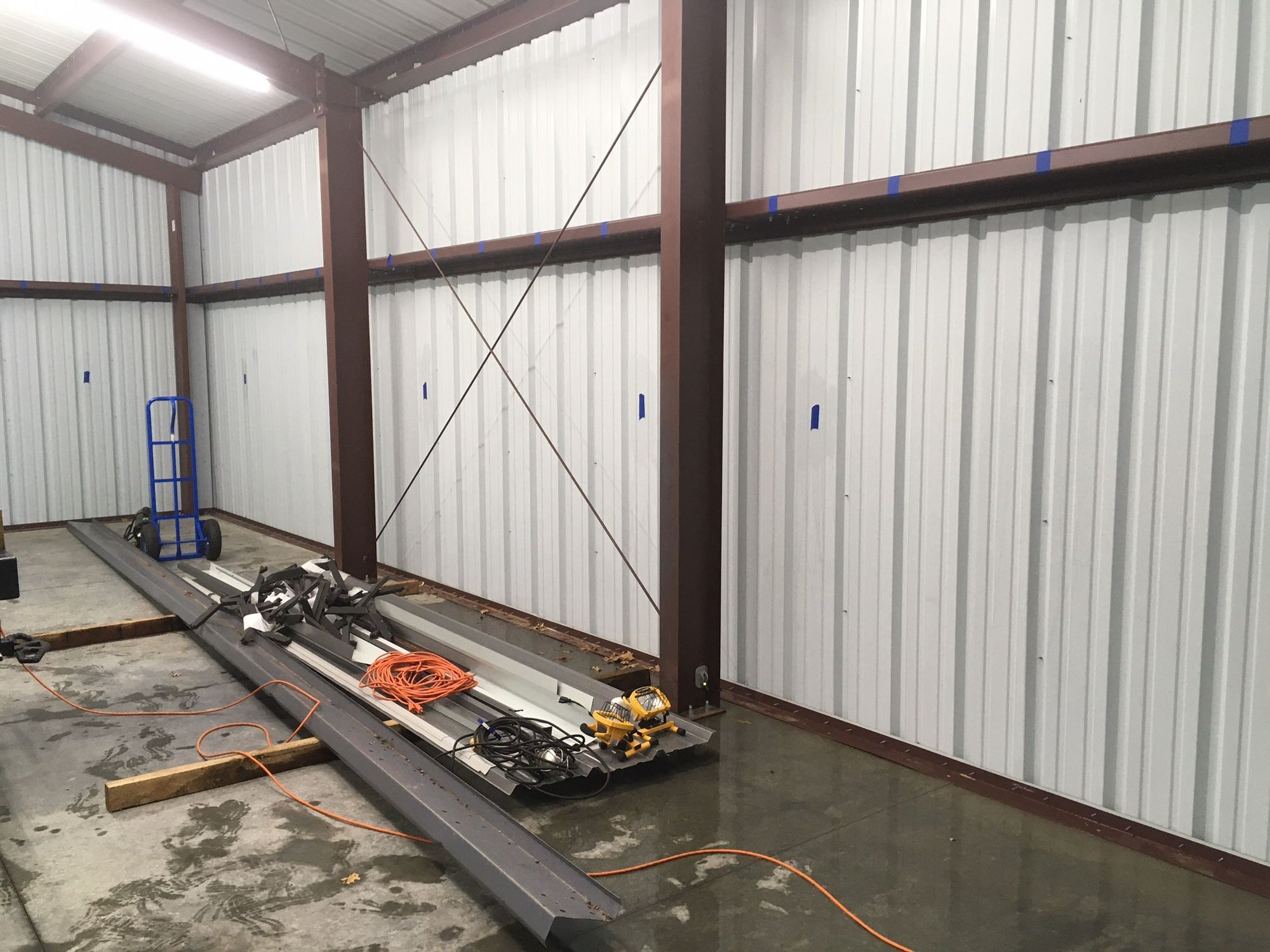

Not a lot of progress. Slowly getting wiring laid out. I marked places for studs then where I want outlets. I'm putting two in each section. My gutter guy got sick. Hopefully he will be out next week. I will call the insulation guy on Monday to see if he has an idea of the date he will come out. I will wait for framing until that is done. No telling on my garage doors. I will call them probably next week to check up on that.

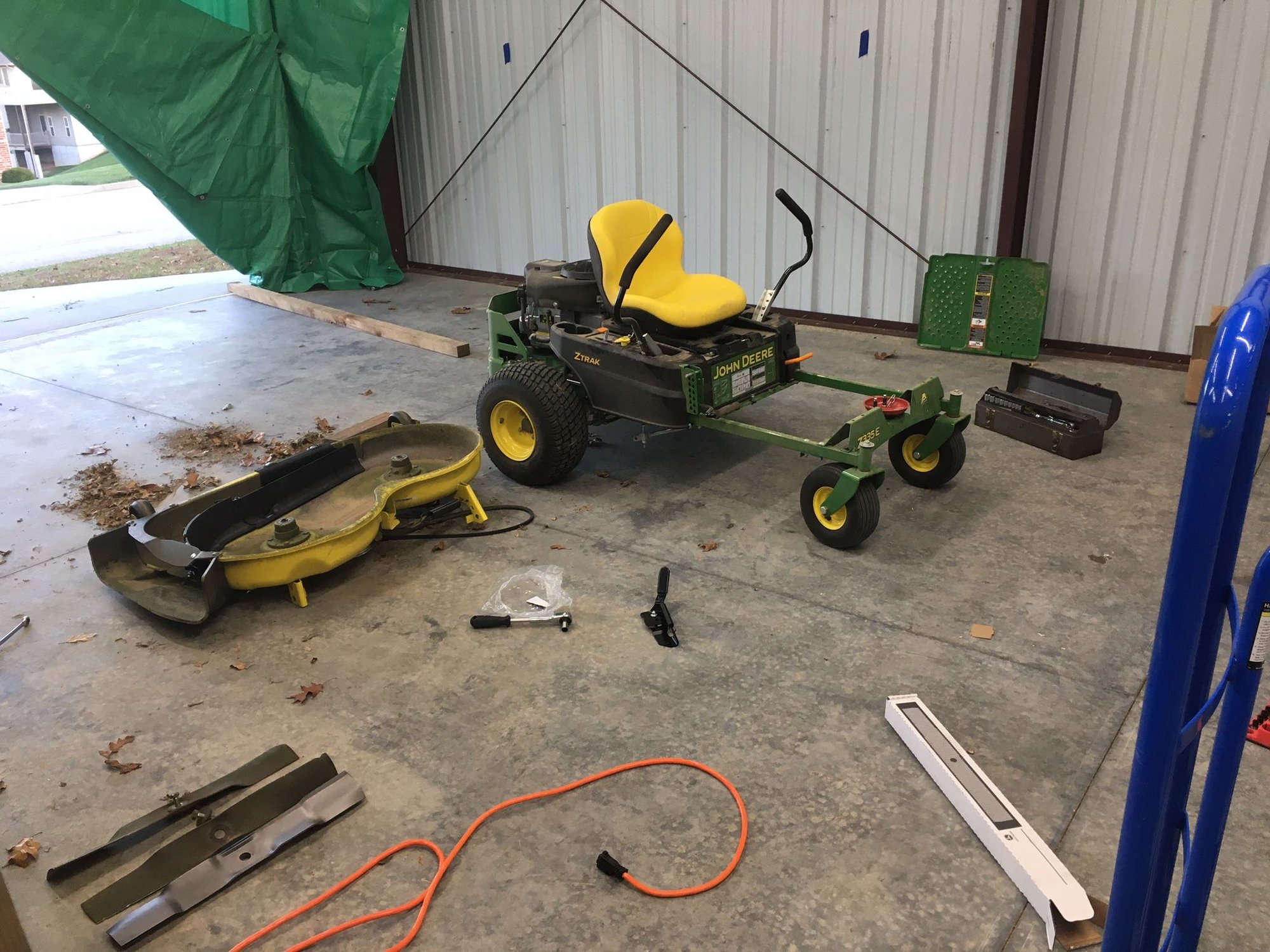

I also used my shop for work. I added a mulching kit to my mower to take care of all the leaves that will be dropping soon.
Blue tap on the girts is approximate location of studs, tape on walls is approximate location of outlets.
I was surprised at how much condensation there was on the roof and walls when we had the cold rain. At first I wondered if I had leaks, but I don't think I do. Rain blowing in from the garage doors doesn't help. The tarps only keep out so much.

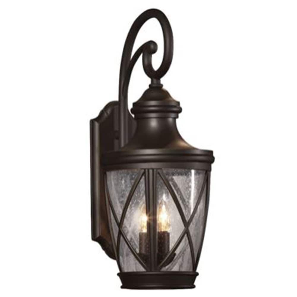

The boss has decided on the outside lights. We were debating carriage lights on the side of the garage doors or a barn light above each garage door. We are going with the carriage lights. So I will start running the cable for those lights soon. We will install the lights after the insulation is up.

Did you show her the Photoshop pic that Bob made with my light?
Yep, sure did. She is thinking they need to be pretty large like the ones in Bob's photoshop. She is looking around and thinking on them.

59 bucks at Lowes.
https://www.lowes.com/pd/Secure-Home...-Light/3421322

We were at Lowes the other day. She was looking at these. A big part of liking these are the size. With a 40 foot front, she things we need big.
