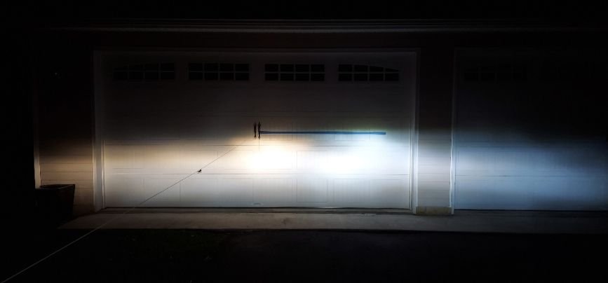

Interesting timing on this subject. I have been running the BeamTechs and just wasn't truly satisfied with them. I did like the 'modern' look of the LED light but still wasn't sold on performance. I saw another thread where a member had installed the Sylvania Ultras. I found a new set of four on ebay for ~$55 so figured I'd try them out. Below are my results.
Surprising to me, the Sylvania put out more Lux (Max 763 vs BT's 596 and Average 535 vs BT's 425) and definitely have a more controlled pattern. The LEDs were scattered/spotty.
(My BeamTech's were properly installed with the low beam up and LEDs at 9 and 3 o'clock.)
In the pictures, you'll see I verified my alignment. I had a string line with level and followed the adjustment specs from the OEM Service Manual. I centered myself at the truck's grill to capture the photos.
End results, the Sylvania Ultra's put out more light with better control. The other advantage is the warmer kelvin light of the Ultra's will performed better in fog/rain conditions.

BeamTechs
Sylvania Ultras
Low Beam - Sylvania's on left, BeamTech on right (Note the BeamTech's high intensity spot is a little low but if I adjusted up, it would blind on coming drivers.)
High Beam - Sylvania's on left, BeamTech on right
Sylvania's across the yard (Low Beam. No scatter like the BeamTechs had.)

Thank you very much! My thought process had come full circle from being convinced I wanted LEDs back to halogens. I'm not dropping $1k on all new LED headlights right now and if I'm sticking with factory housings I don't want to use the wrong tool for the job... even though in 2020 it pains me to buy incandescent. The Sylvania Ultras have been in my amazon shopping cart for 2 days while I waffled. There were just too many opinions to sort through. Thanks for the testing, pictures, and data.
