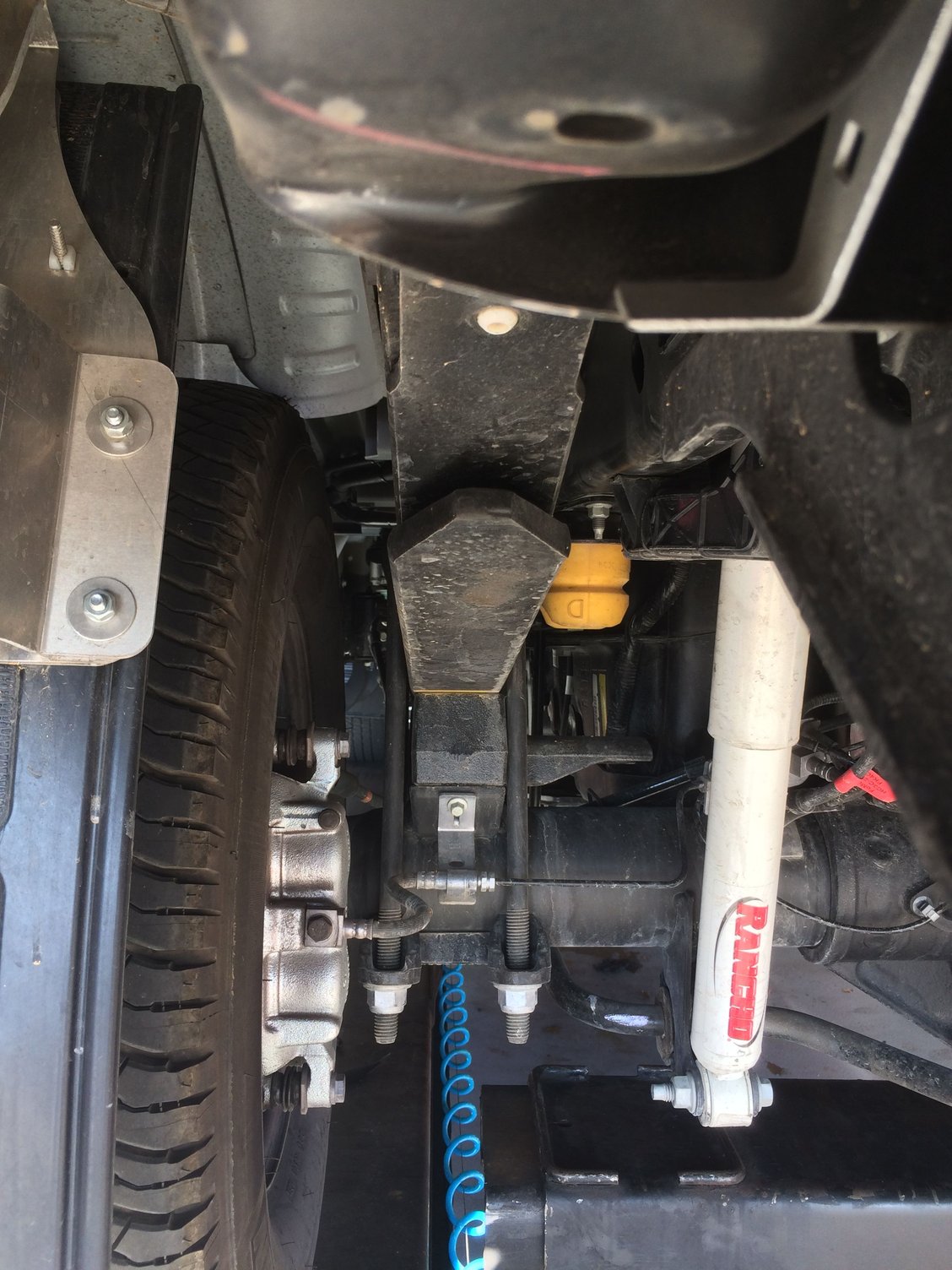

Dropped the rear of my F350 4x4 DRW down by 2" today, from the stock 3 1/2" to 1 1/2" blocks using blocks from PMF. Needed those extra couple of inches for a little more rail clearance while towing my 5th wheel full time now. I ended up re-using the same factory u-bolts since I had close to 2" inches of new thread exposed.
Precision Metal Fab link:
2017 Ford Superduty Fabricated Lift Blocks
Before:
After:
Old blocks:

Nice post/pics b-foster!
Do you sense the shocks bottoming out at all or any difference in ride quality?
Old Dec 12, 2017 | 10:49 PM
  #195
b-foster's Avatar
b-foster
Joined: Aug 2017
Posts: 119
I only put about 70 miles on it today after the switch and noticed no difference in ride at all, it still has a very slight rake to it, and overall just looks more "level" in back. Tomorrow will be a better judge of everything since I am towing around 200 miles
