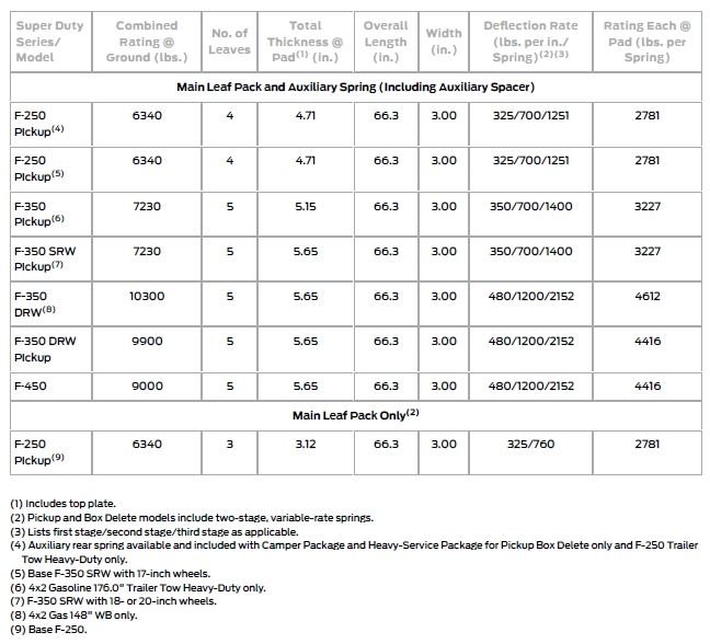

Here’s some info to help clarify. 250 has 3 leafs unless camper or HCTP then it’s 4 leafs. 350 with 17” wheels is 4 leafs others are 5 leafs. This has the difference in thickness. Now just have to figure out U bolt part numbers for the different versions.

Originally Posted by cficare
If it's any help, U-bolt PN: BC3Z-5705-K is the shorter one in this photo. The longer one is the OEM U-bolt from my 2017 F250 4WD with no additional leaf springs other than base 4WD diesel.
How long is the original bottom u bolt in your picture. Could be the size for the F 350 switch.
