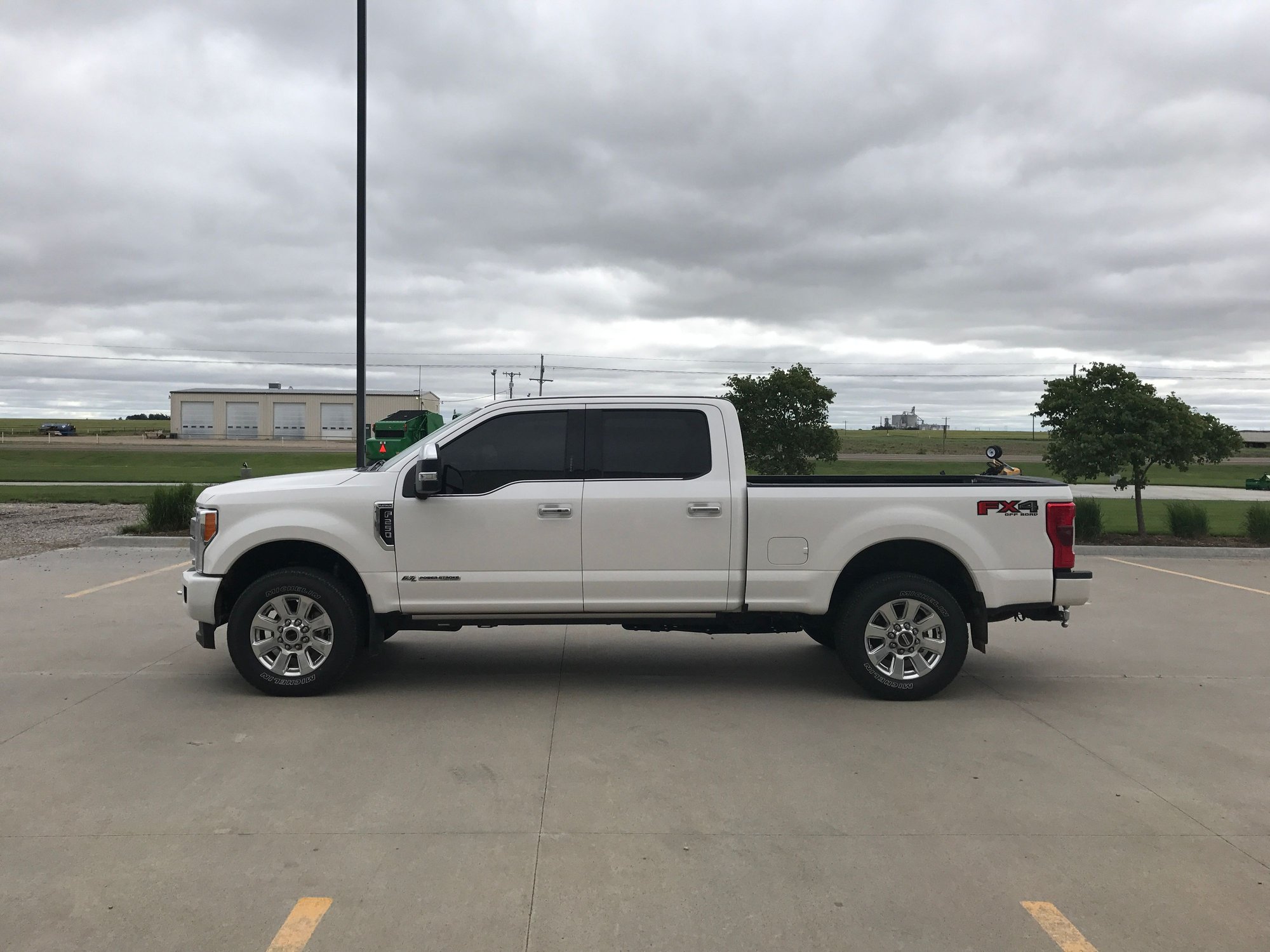

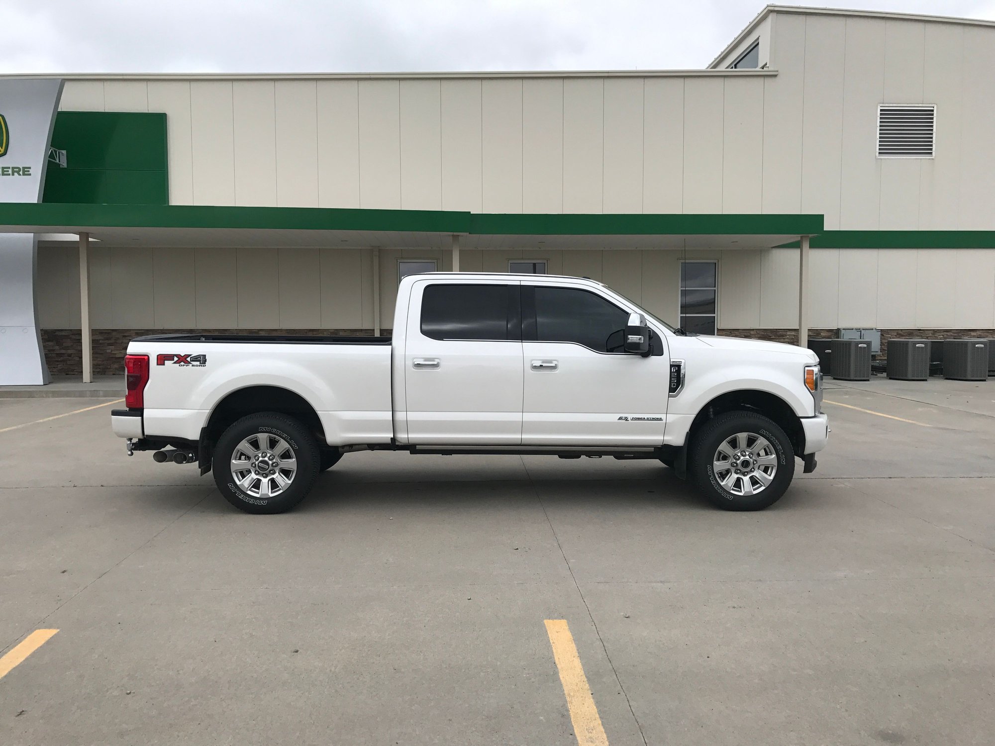

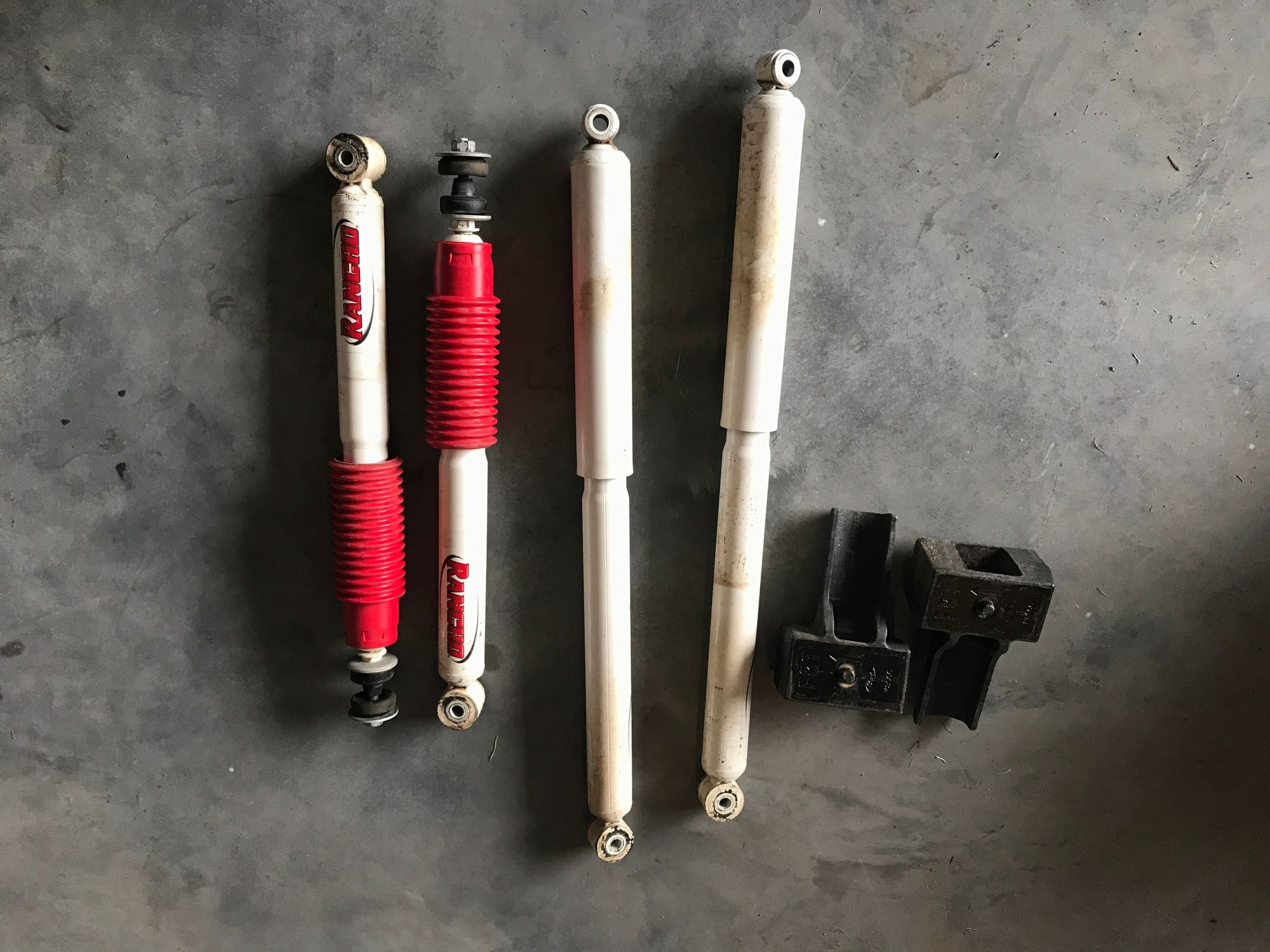

I used the Ford blocks P/N:6C3Z-5598-A. The shocks made the biggest difference on country roads and rough streets. Dropping the air pressures to 50 psi made the biggest difference on the highway, but I'm sure they helped as well there.
The remnants...
The u-bolts before I cut them off.
