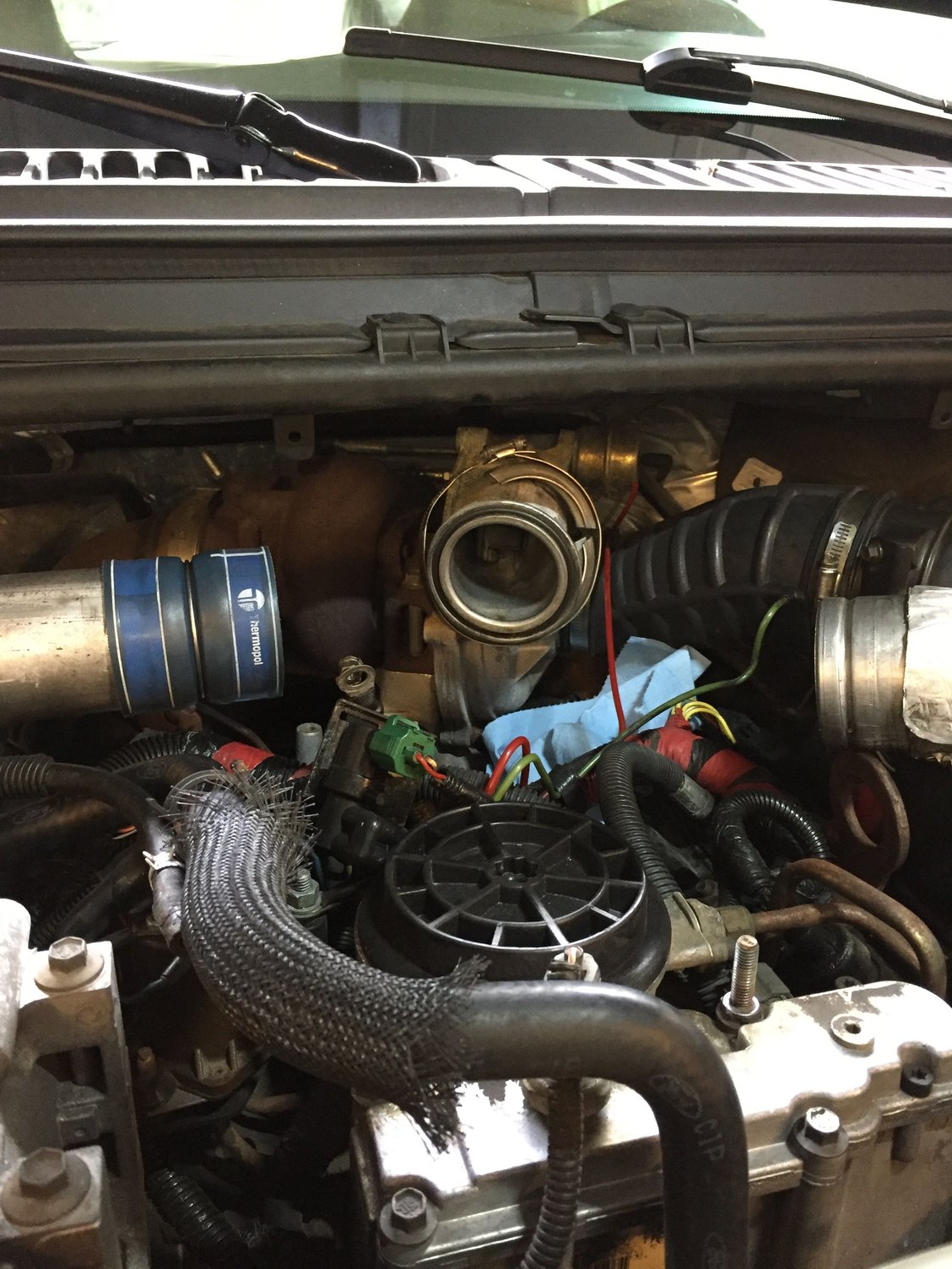

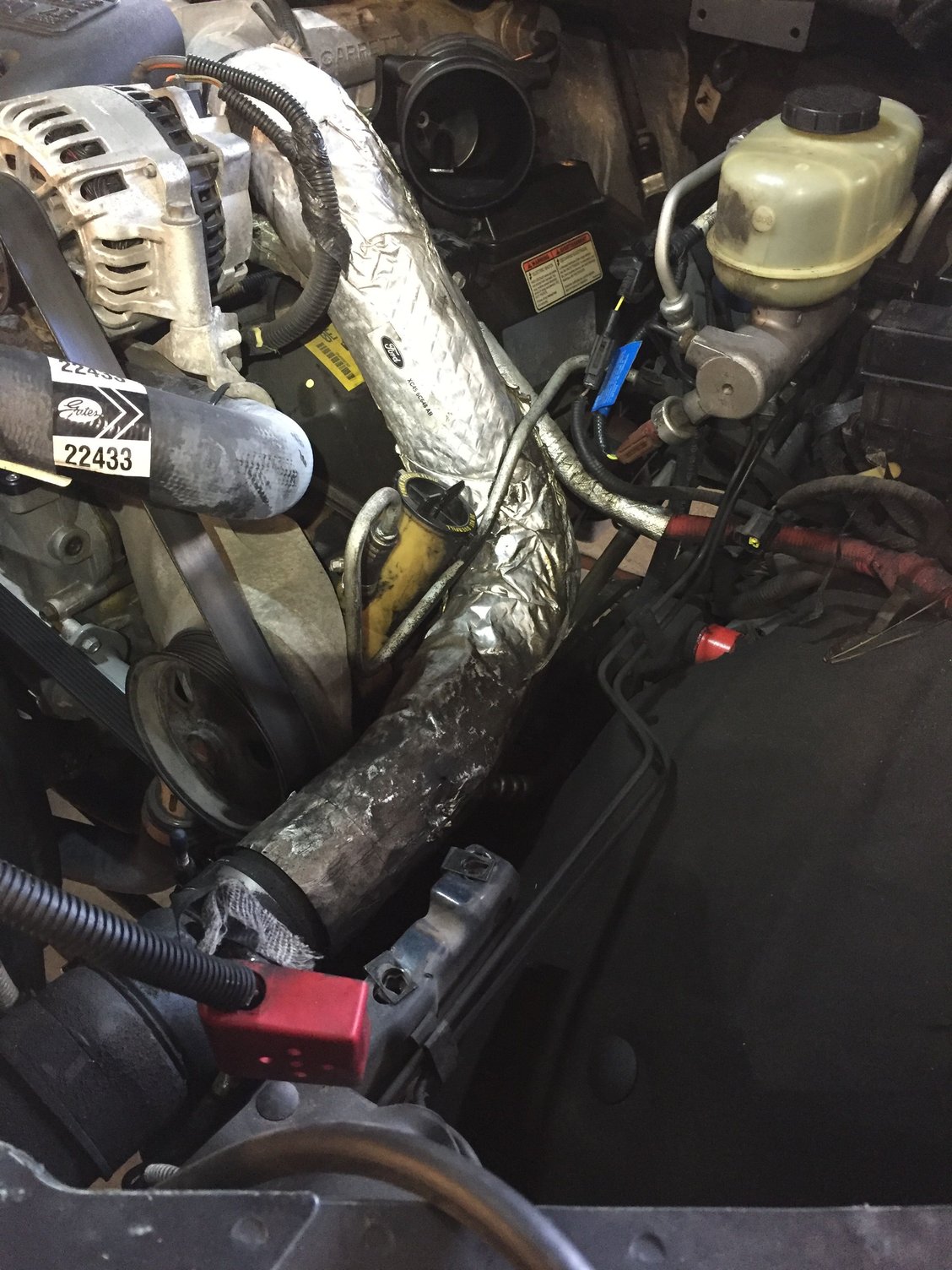

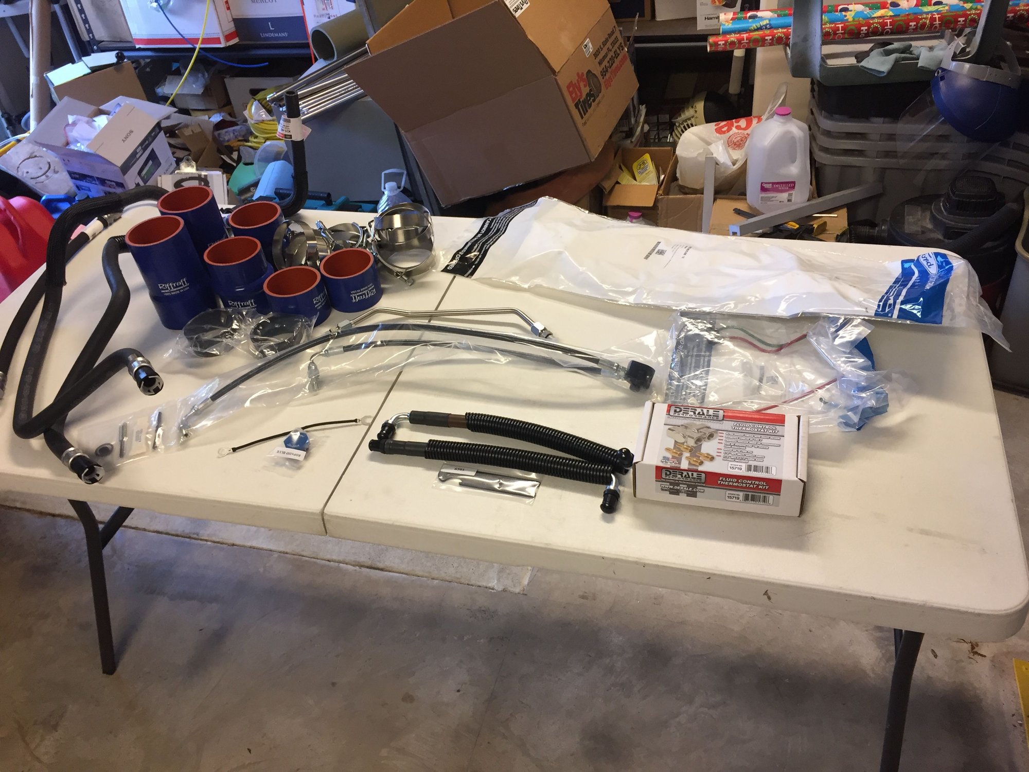

Started working on this table’s worth of parts Saturday morning. Finished everything except the transmission thermostat and one of the heater hoses in 13.5 hours. That was straight time...no food or bathroom breaks. Did get some liquid, but obviously not enough if I didn’t go to the bathroom.

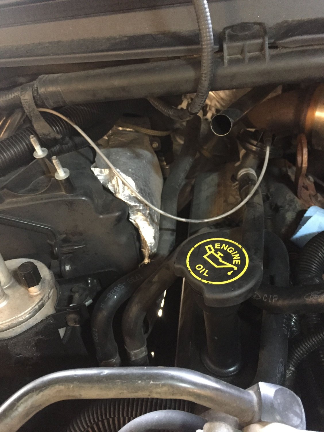

Removed air cleaner box and battery tray for better access.
Spider out.
Replaced Power Steering Pressure Hose. Was pretty painless with the battery box/air cleaner and CAC tube out of the way.
I couldn’t replace one of the heater hoses as the one I got was not the same as what was in my truck. Maybe because mine is an excursion with rear heat/AC, not a truck? It had some kind of sensor spliced into the line and a bunch of other small pieces of hose.

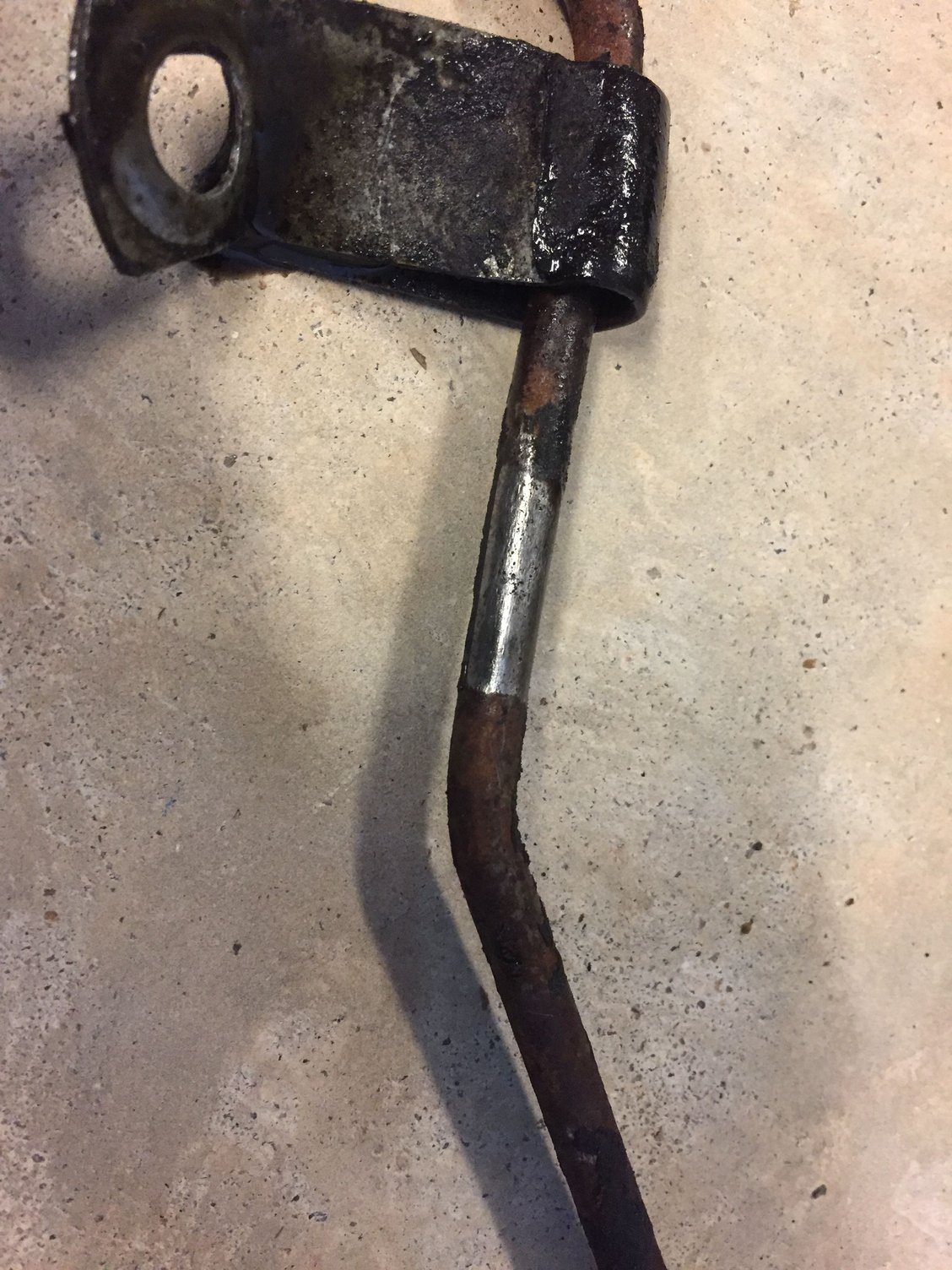

There was some wear on the passenger side fuel line. Not too bad though.
You can kind of see the new fuel line. Putting on the back fitting was a bit of a pain as you could only move the wrench about 1/8 turn, flip it over and do another 1/8 turn.

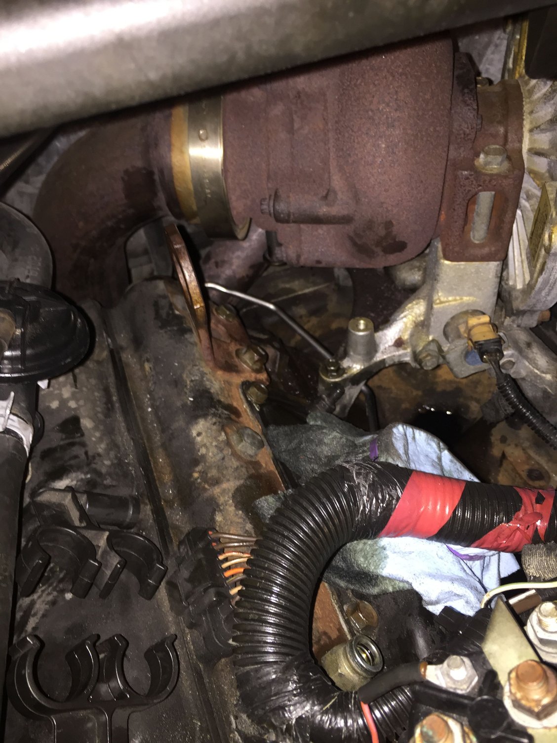

This little bitch was the bane of my existence yesterday. The passenger side fuel port for the FRx. I must have messed with that thing for two hours trying to get it started. I even unbolted the A/C compressor to give myself a little more room. I eventually found that it's hole isn't parallel to the other head bolts nearby. I was trying to line it up with an incorrect datum and couldn't get the threads to start. By comparison, I got the rear one on the driver side in one try.
FRx and HPx done!
Riffraff Plenum Insert in. Yes, that red piece if tape went into the plenum. I cleaned it out but who knows what else made it into there, the oil system, or the fuel system with all the gunk that was in the engine compartment with all these different mods happening “at the same time”.

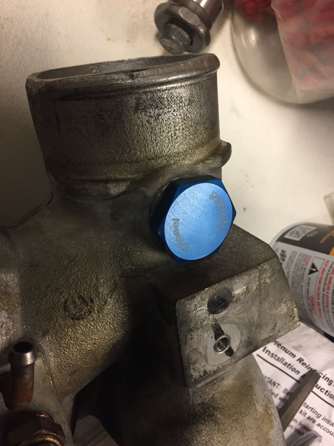

AIH Delete. Very easy to do when the spider is already out.
Spider back in with new boots. Getting the plenum boots onto the spider or vise versa was a pain. Ended up using a plastic trim tool like a tire lever for installing a bike tire. That worked well. Getting the turbo lined up with the spider took some work too. Ended up using a large set of channel locks to get them aligned.
Everything put back together and ready to leak test. Also shows the new Turbo Wastegate Actuator Lines.
I apparently never took a picture of the new HPOP lines. They were a different story. When replacing the o-rings in the head fittings, take them out of the head... Also, my valley was completely dry before starting this project. After the HPOP lines were disconnected, that all changed.

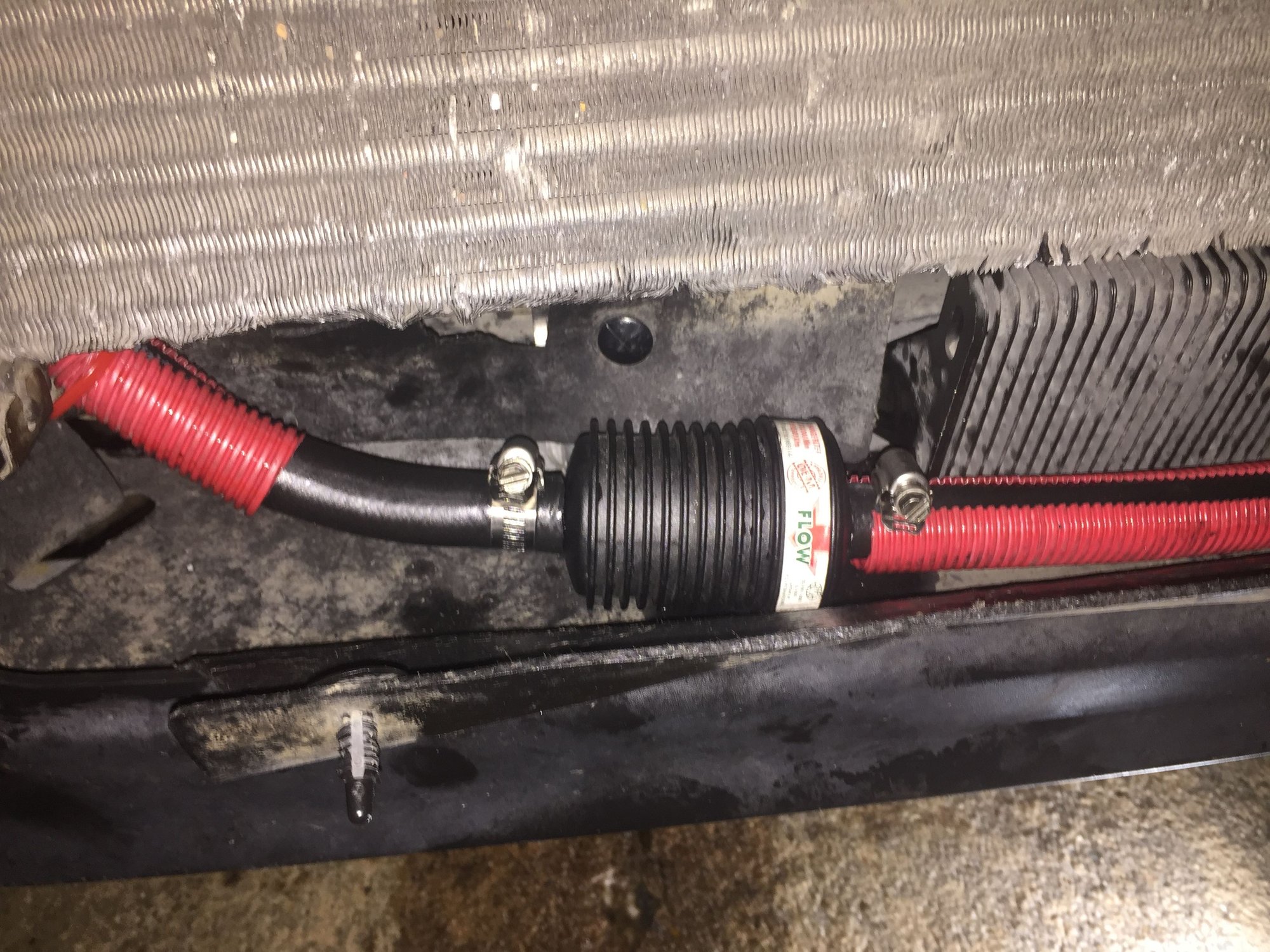

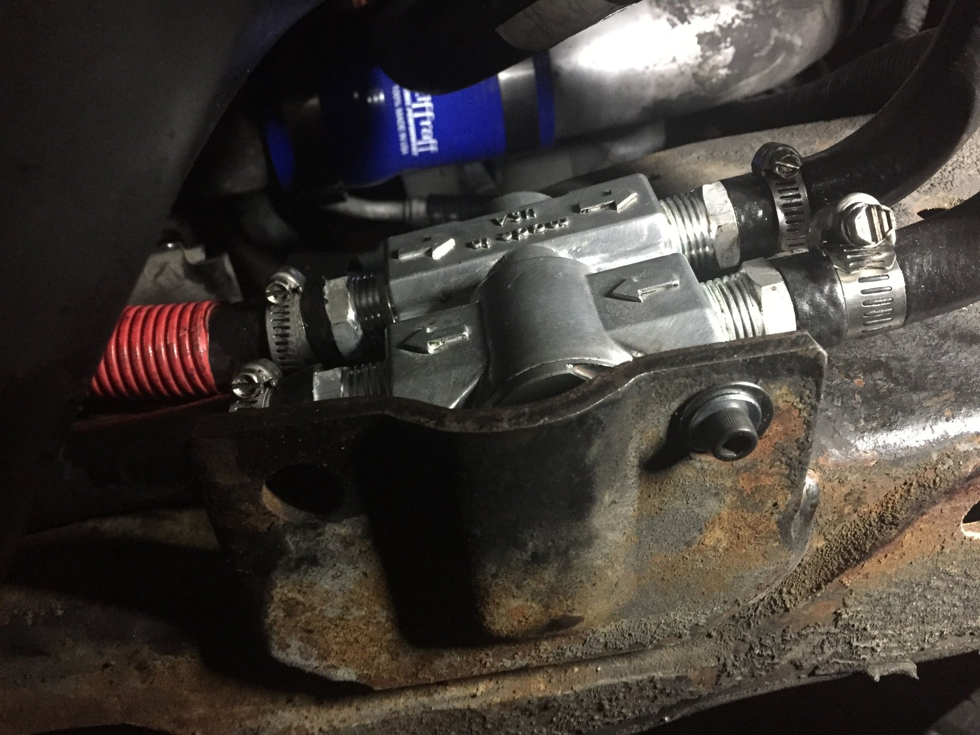

Tackled the transmission thermostat this evening.
Had to move the Magnefine transmission filter up front as it’s previous location was the only logical location for the thermostat.
Mounted the thermostat on the front passenger frame rail. One of the frame holes just happened to line up with one of the threaded holes in the thermostat.

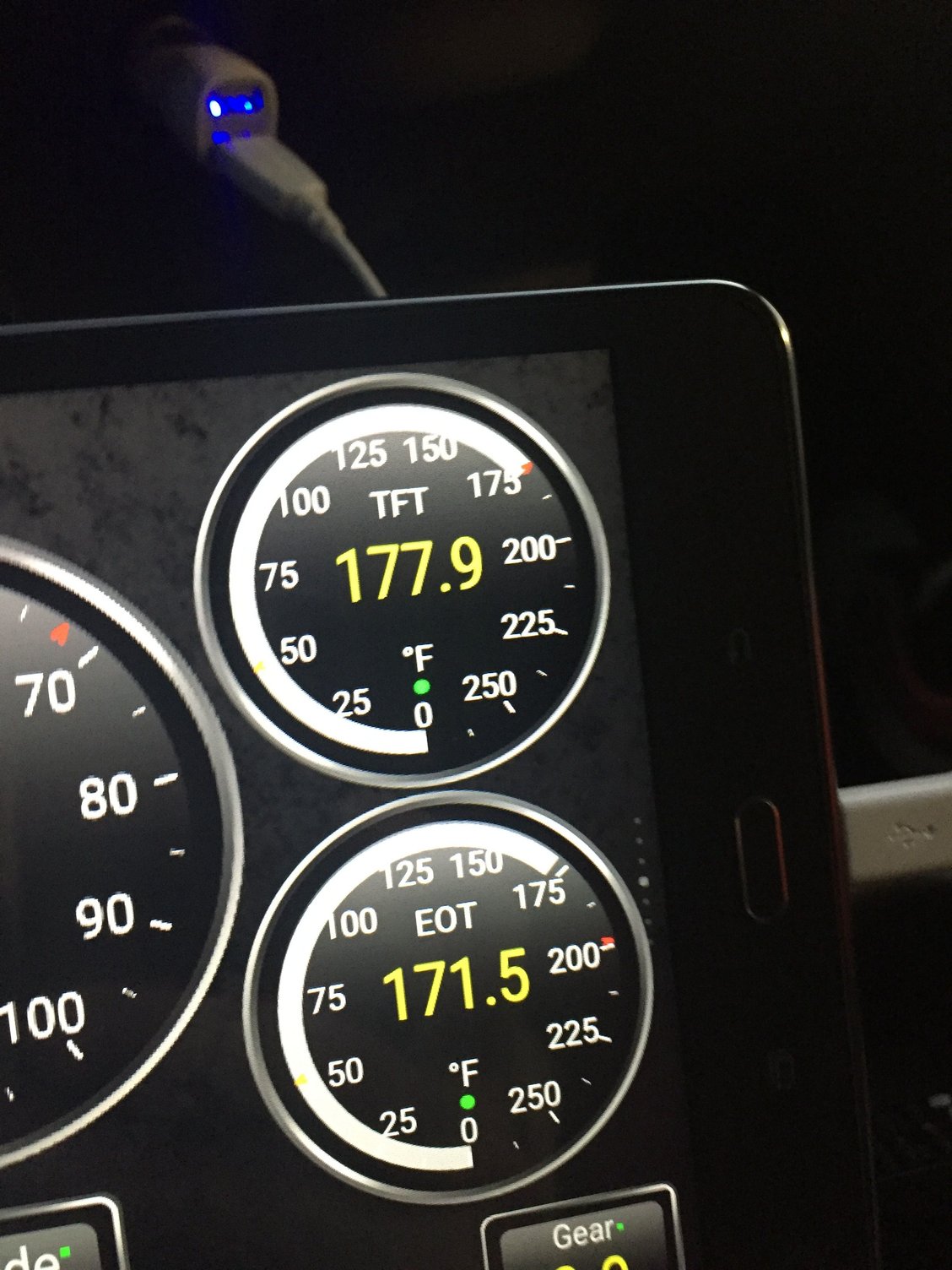

Transmission thermostat works! 42* out this morning. After the 6.0 cooler mod the TFT never got to 170, even in the middle of summer here in the south. On cool days like today the transmission wouldn’t get to 120.
