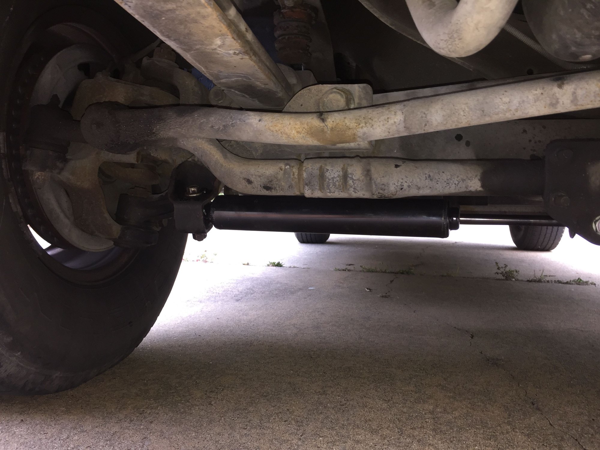

Existing steering damper looked a bit long in the tooth so I swapped it out too.
Should have read more before getting the Monroe. It bolted in easy enough, but no dust boot...
Also while under there I found aftermarket tie-rod ends and ball joints. All had grease zerks. I'll have to get some grease in there and see if the seals hold anything.

Bilstein makes a very good steering damper for the Excursion. I didn't care for the Monroe when I had it, as the shaft rusted up pretty quick and then started leaking. And that was in South Texas weather/roads.
