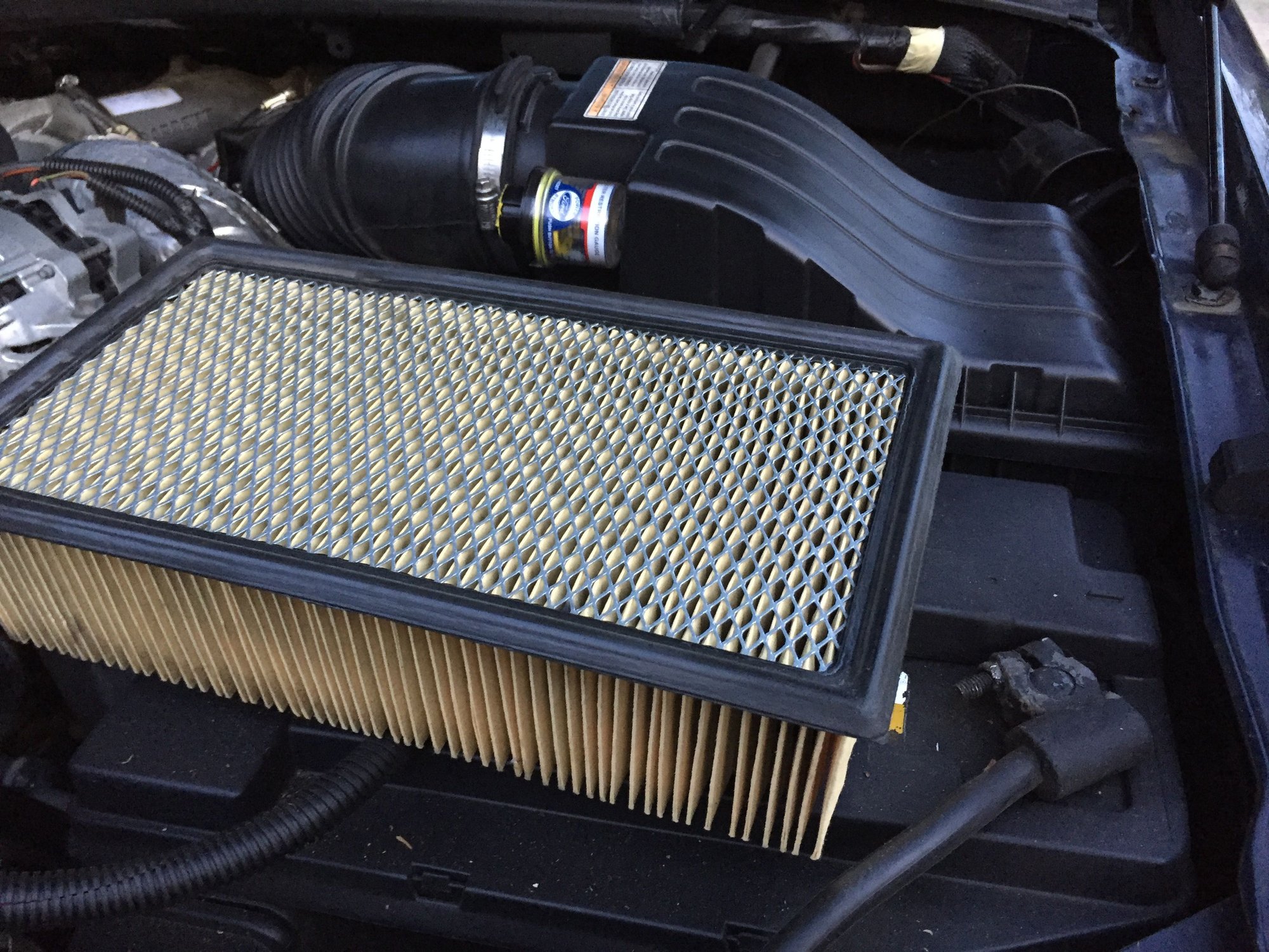

Well, here goes the start of the adventure.
2000 7.3 4x4 Excursion. Completely stock. Flipped over 170,000 miles on the drive home from Texas.
I'm going to list things changed/fixed/upgraded and cost of parts/service. I won't include shipping or taxes. I'm also not including tools purchased to do the fixes.
11 Apr 17
-Changed Air Filter (Motorcraft FA1750, $19.48 Amazon)
