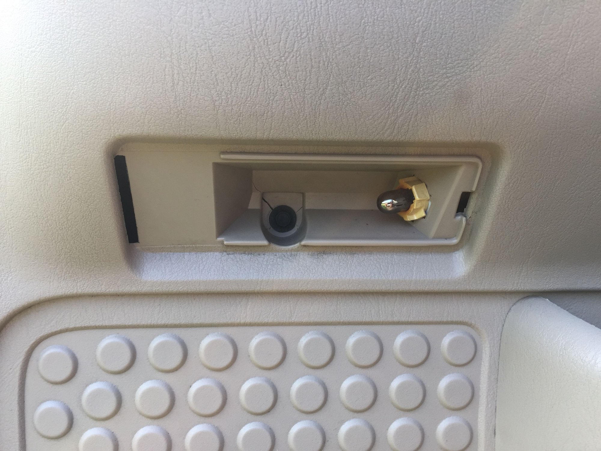

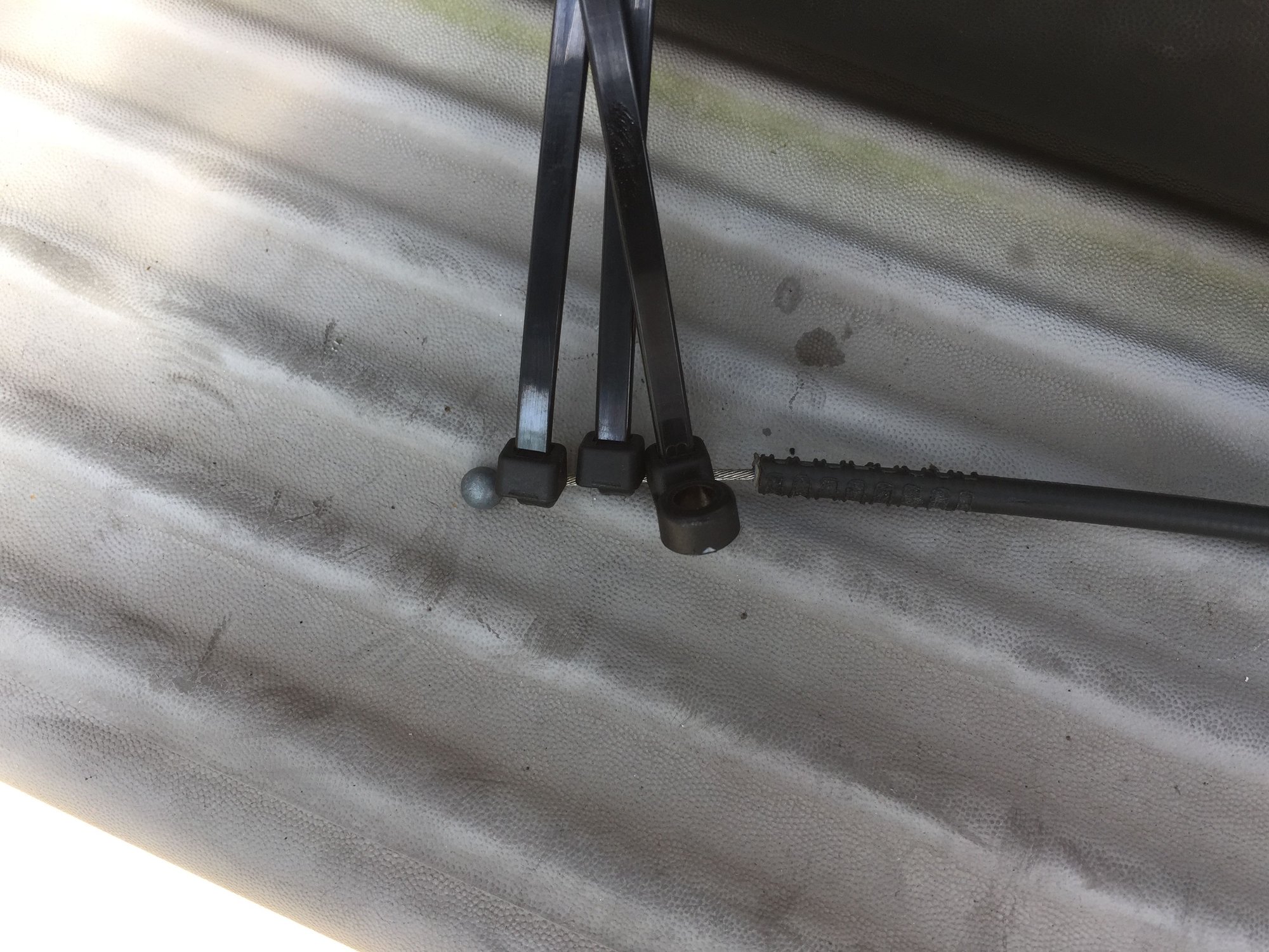

Driver's side barn door with panel off in preparation of fixing the door latch.
The jury rigged setup a previous owner tried to do to make the door work. I wonder if it ever did?
It looks like the factory melted on the plastic end fittings in the beginning. After all that plastic broke off, there were some serious ridges left over that kept the sheath from fitting into the replacement aluminum fittings. Some sandpaper fixed that problem right up.
After sanding, the cable sheath fit perfectly into the aluminum fittings found in the tech folder for fixing this latch issue. The inner wire cable just barely fit into the slot. My measurement put the wire at about .062" diameter. The slot was not much bigger, if at all. I ended up drilling the end of the fitting slightly bigger (.070") so the cable wouldn't bind. Squirted some silicon lube in there and put everything back together. Works like a champ now.
Only issue with this fix is I broke about three of the plastic clips that hold the door panel on. Went to my Ford dealer today to try and get some replacements. That was my 2nd trip today to get something that they didn't have in stock. Will pick them up on Monday. Funny thing is, there was a cable assembly on the counter for another customer. Slightly longer than this one. They still have the plastic end fittings on them.
This fix was too easy to not do it right. Hardest part was getting one of the T27 torx screws out. Had to find my impact drill that I probably hadn't used since before my Ex was built.

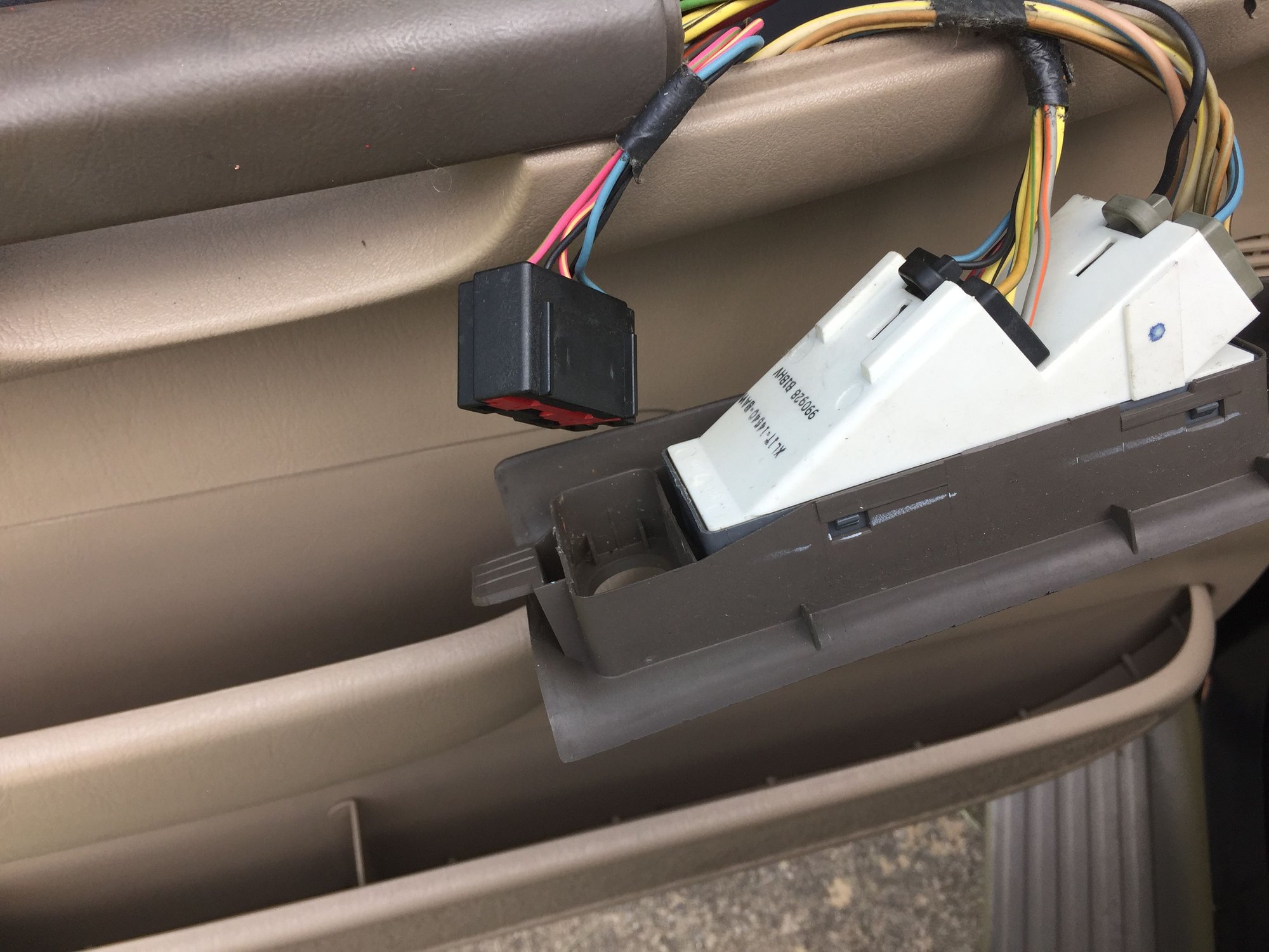

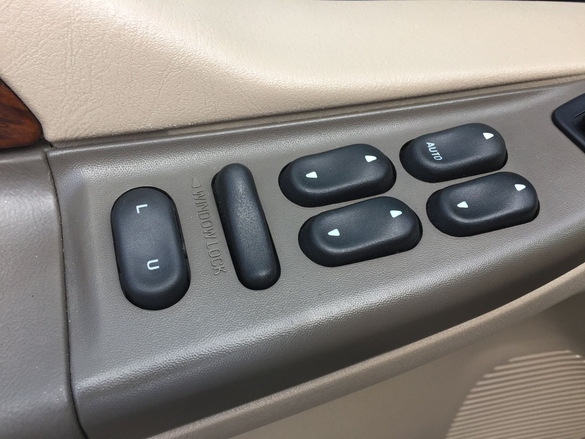

Needed to fix the drivers side door lock switch. Switch panel was easy to pop off. Plug easily removed from lock switch. The switch itself (red) was a pain to remove.
Once out the new switch was simple to install.
Now I can lock/unlock all the doors from the drivers door.

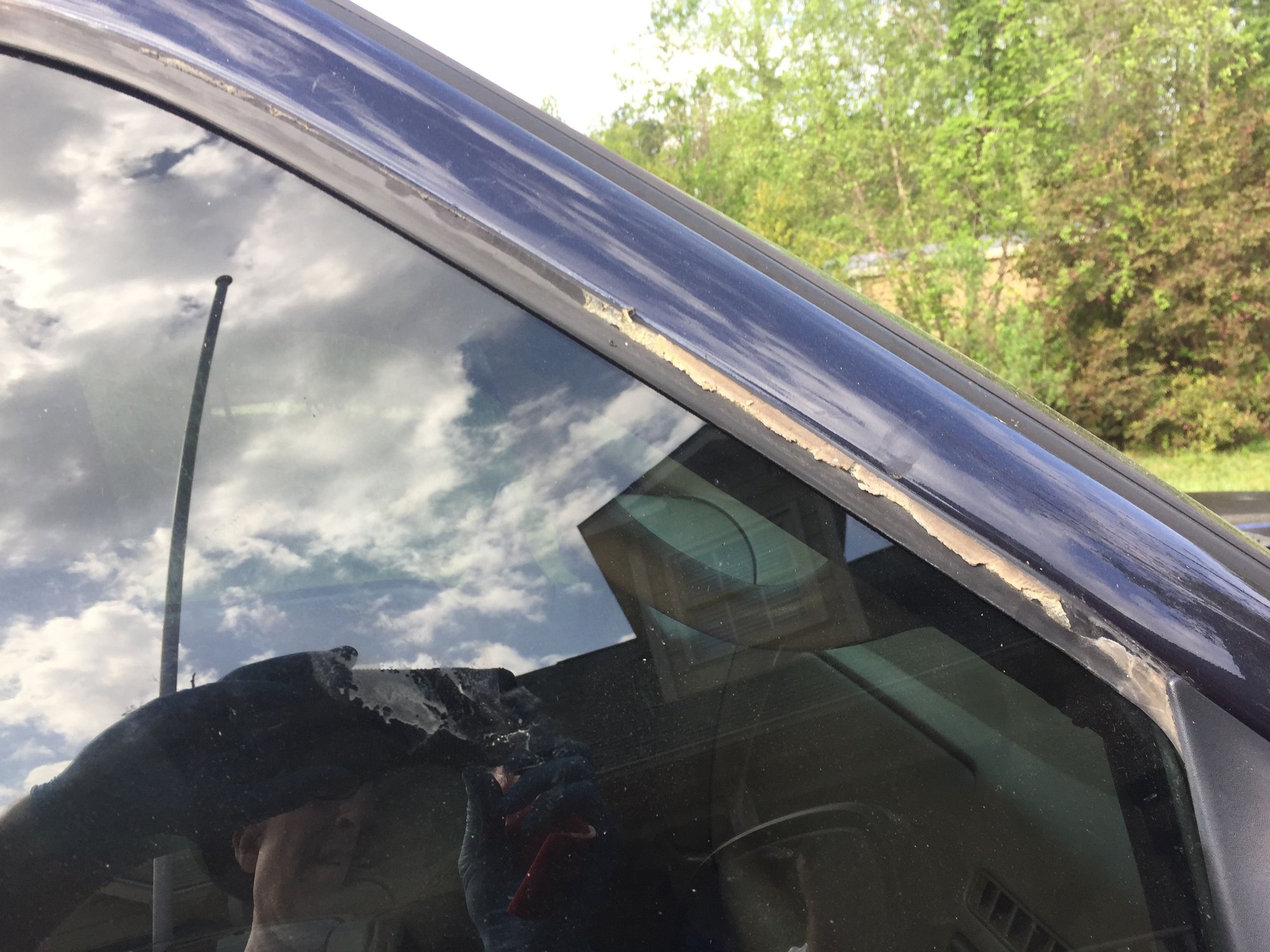

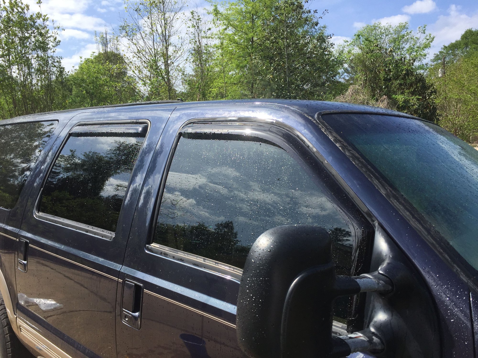

Existing window visor was broken on the driver door. Without a sunroof to vent the vehicle in our hot Georgia summers, I decided to replace the existing ones, and add them to the rear windows.
The existing ones were stick-on visors. Took me quite a while to get the decade old double sided tape off.
New EGR in-channel visors installed.

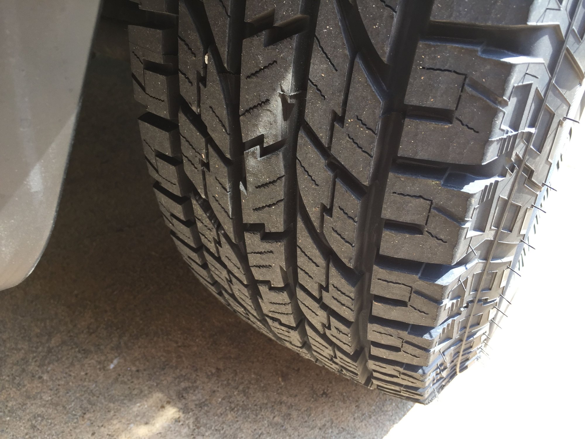

Baby's got new shoes...
Ok, what should have been a simple mount, balance, and alignment turned into much more. The tie-rod end at the Pitman arm was shot, so it needed to be fixed before they could do the alignment. Waited half a day for parts. That was fixed so then on to the balance. They do on-the-vehicle spin balancing. Problem is the rear tires wouldn't spin. The rear calipers were shot. So, a whole rear brake job later and it is now "complete". They said I also needed sway bar bushings and links. I can do those and have them on order.
I used Fowler's here in Phenix City, AL after they were recommended by a FTE member and one of my non-Ford buddies here in town. They seemed pretty squared away and didn't push anything on me. Just gave me the facts and options.

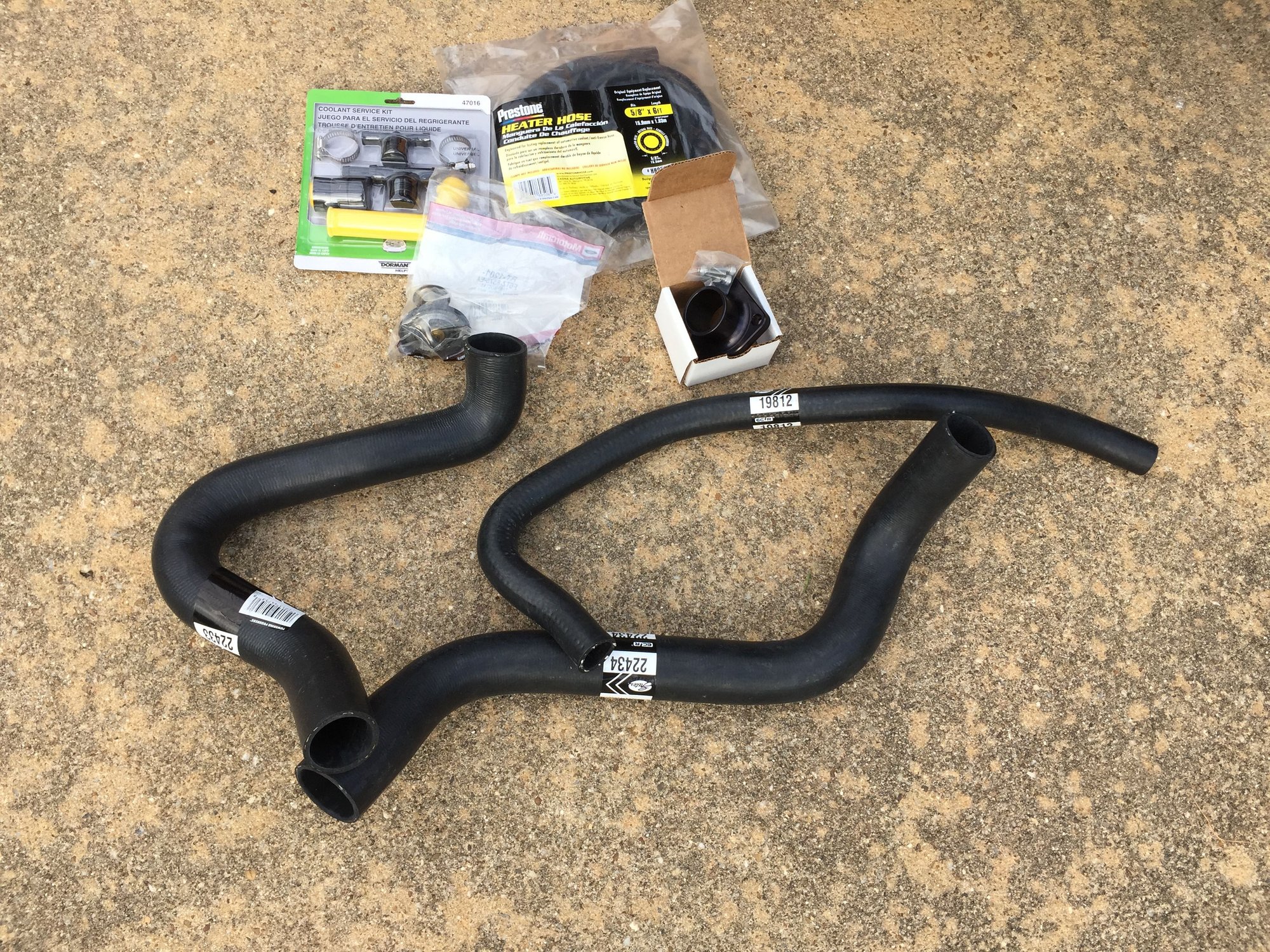

All parts (I thought) to do Gooch's radiator flush and fill...
Snapped off two of the three thermostat housing bolts. Guess I'm in for a water pump replacement now too, unless someone out there has any ideas? I did spray the bolts with PB Blaster but they were rusted solid.
