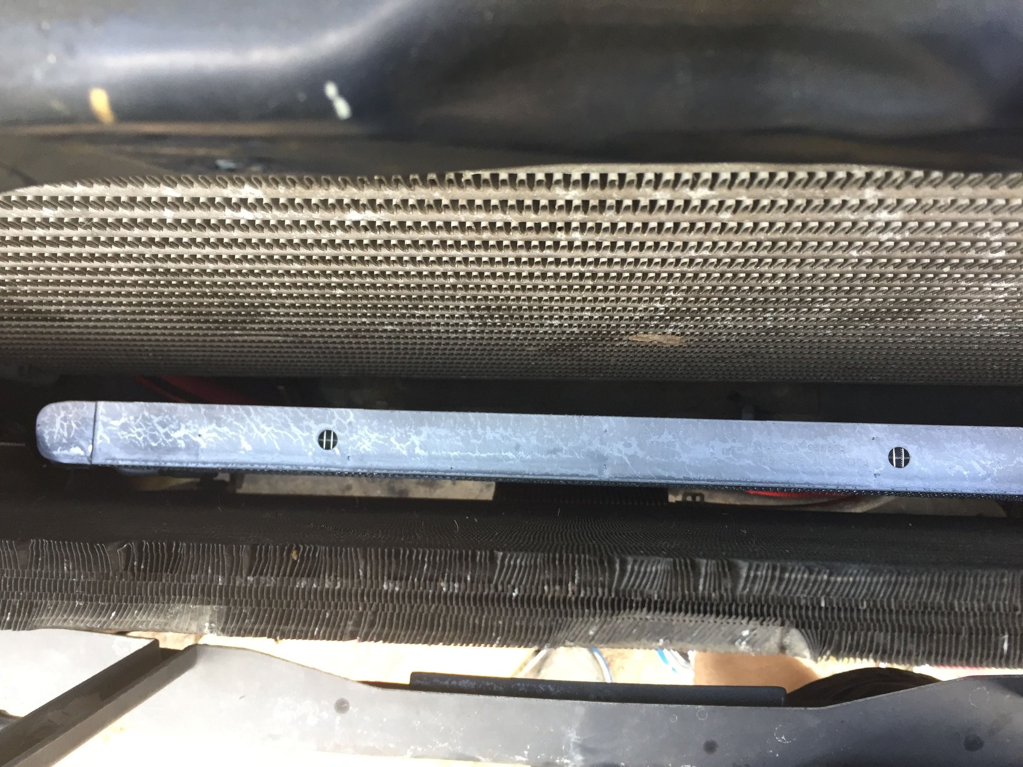

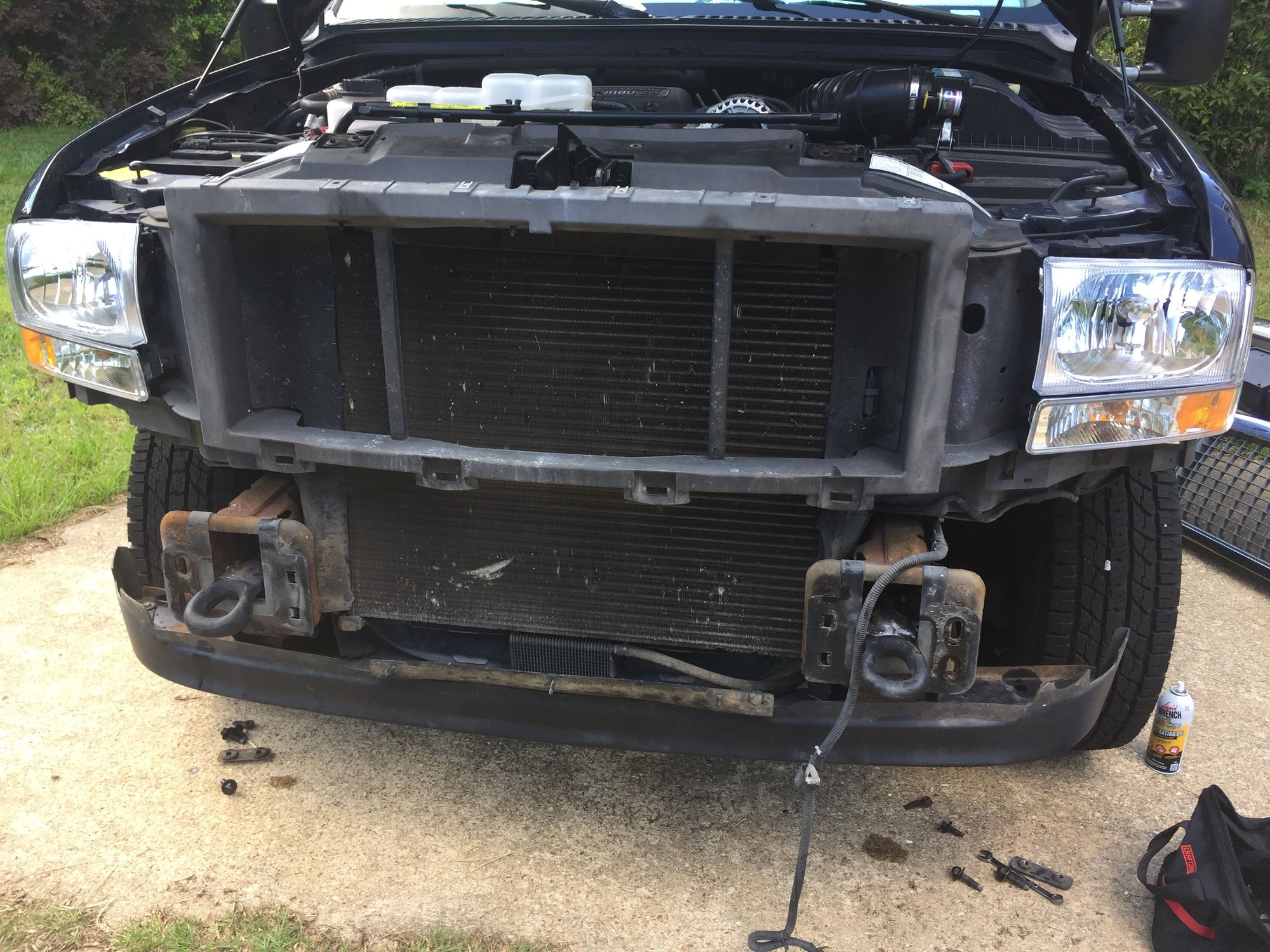

Bumper off in preparation for installing the 6.0 transmission cooler.
Grill off too. Discovered I had a block heater. Probably won't need that much down here in the south.
Out with the old. I can't imagine there is much market for a 7.3 transmission cooler, but if someone needs one PM me.
In with the new. Will do transmission filter and flush tomorrow. Getting too dark to finish today.
