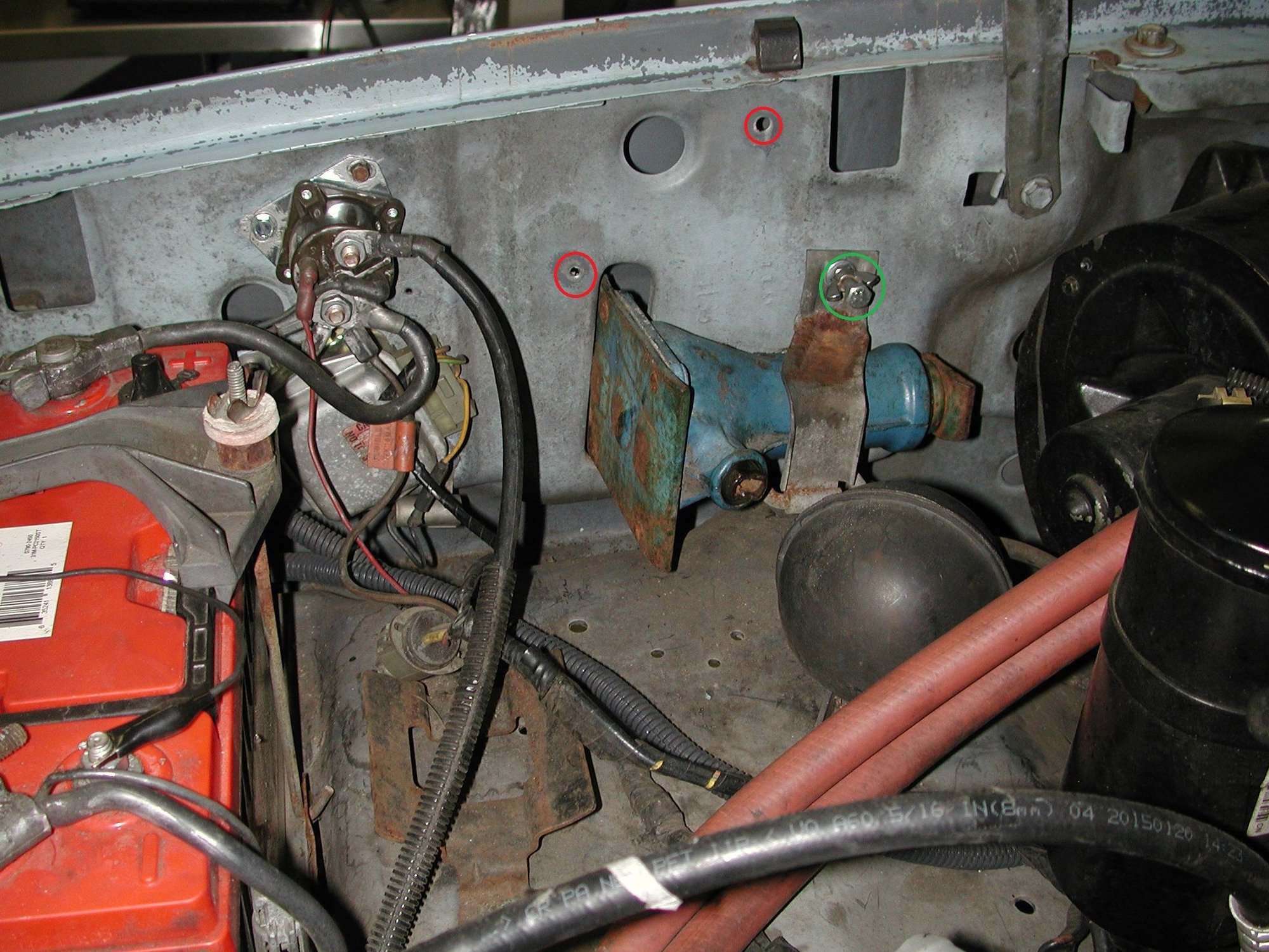

I'm still cogitating about the decal, but I did peel the onion a bit more today. I was looking at the passenger's side fender and my eye fell on the jack, which was up against the regulator's wiring. "Hmmmm, that's not right. In fact, the jack isn't stored correctly."
So I pulled the regulator off and discovered it was mounted in the wrong spot, as shown by the red circles below which were where the screws were. I put it were it is supposed to go, beneath the solenoid, and turned to the jack, which was rusty. In fact, I could hardly get it to move. But, after lubricating it profusely and running it all the way up and down about 10 times it now works easily. Then I tried to store it, but the bolt/wingnut combo that was on there wouldn't tighten up all the way. Apparently that's supposed to be a metric fastener of some kind but someone put a 5/16-18 in about half way so that the nut's threads were toast. I ran a 5/16-18 tap through it, which went reluctantly, and now the jack stows like it should and will no longer rattle. And the jack won't abraid the regulator's wiring.
