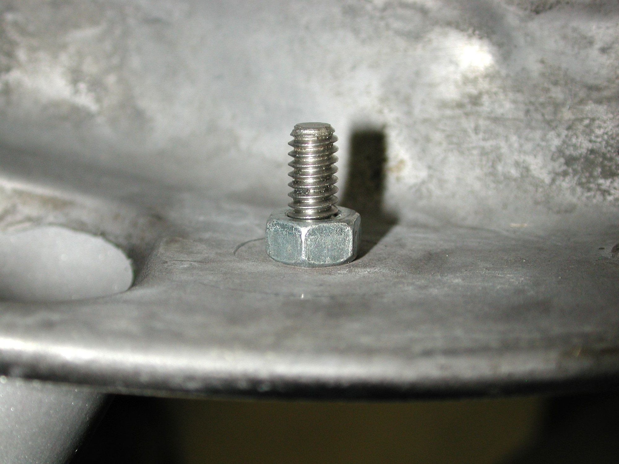

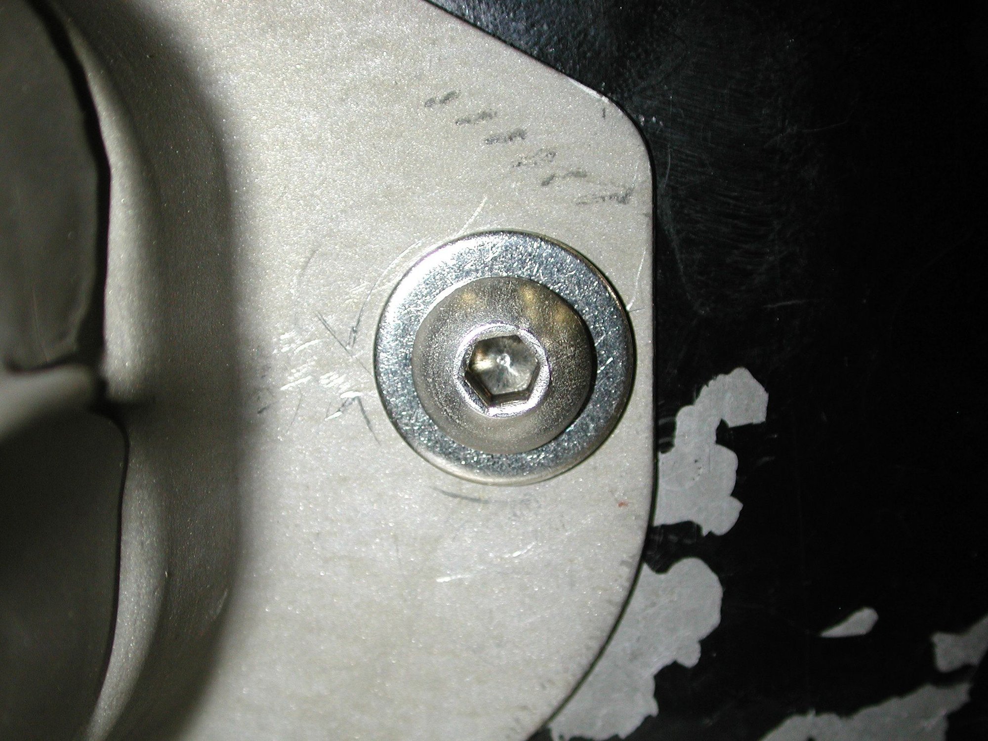

Well guys, I'm finishing things up in the shop before I get really busy on other things for a few days. And I thought I'd simulate the flanged button-head screws to see how they will work with the snorkels. The pictures below show you what it'll sorta look like, but I have to say that going with 1/4-20 hardware and backing the air cleaner base up with a nut is certainly the right decision. I was finally able to cinch the screws down tight enough to make the snorkels solid on the base. Heretofore the snorkels could be moved up or down w/o flexing the base, regardless of how tight I dared make the 5mm screws since they were only tightening into the wall of the base. But, the nut on the 1/4-20 bolt means you can torque things much tighter, and the result is a very solid mount.

Gary, I would either put loctite or self locking nuts inside. Even though the element is in there, I never liked the thought of loose items in my intake tract.
