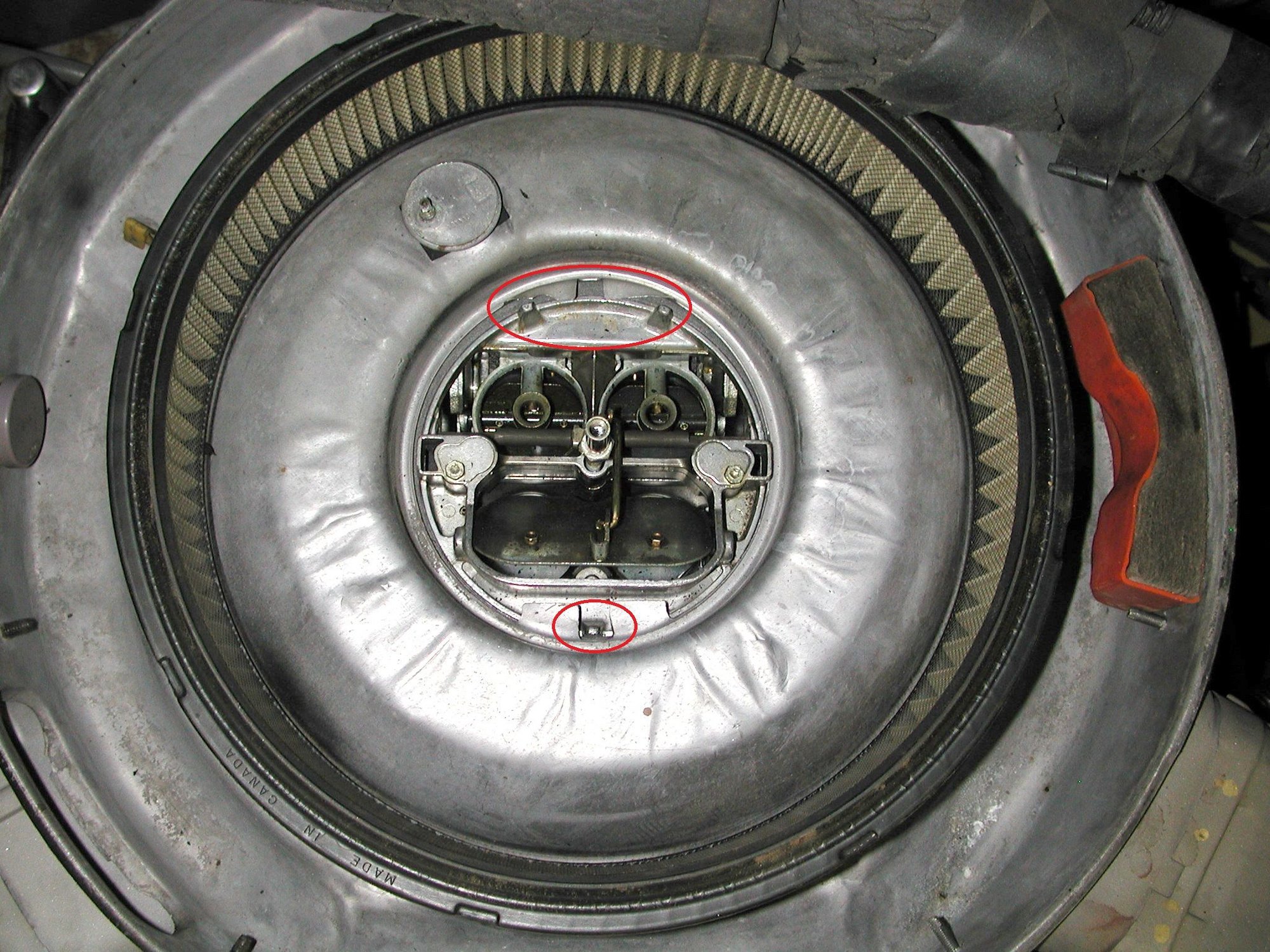

I got to thinking about the snorkels I had on that base, and checked. Sure enough, the passenger's side snorkel wasn't the original one from the HO cleaner. In fact, it was one w/o any angle to it. I suspect it was the one on the bottom from this pic out of Dad's Air Cleaner thread. The top one is the original HO snorkel, and you can see how it would angle the snorkel to the rear on the passenger's side.
So, I made sure this pair was installed on the HO base, with the one on the top on the driver's side. So, what I now have is a mirror-imaged pair of HO snorkels, with the one on the driver's side being modified to have the angled part flipped 180 degrees.
And, with that done I found that I have 1/2" of clearance to both the upper radiator hose on the passenger's side and the back of the A/C compressor on the driver's side. And, here's what I found on the tabs that align the air cleaner to the carb.
Given that, I think the design is done. I've sent a note to my paint/bodyman to see if I can drop the extra HO lid off at his place to get some minor dings taken out. Then, when I get the valve covers, whatever they are, I can powder-coat them and the air cleaner in one go. And right now the plan is for the base of the air cleaner as well as the bulk of the valve covers to be wrinkle black, and the rest to be brushed aluminum and clear-coated.
