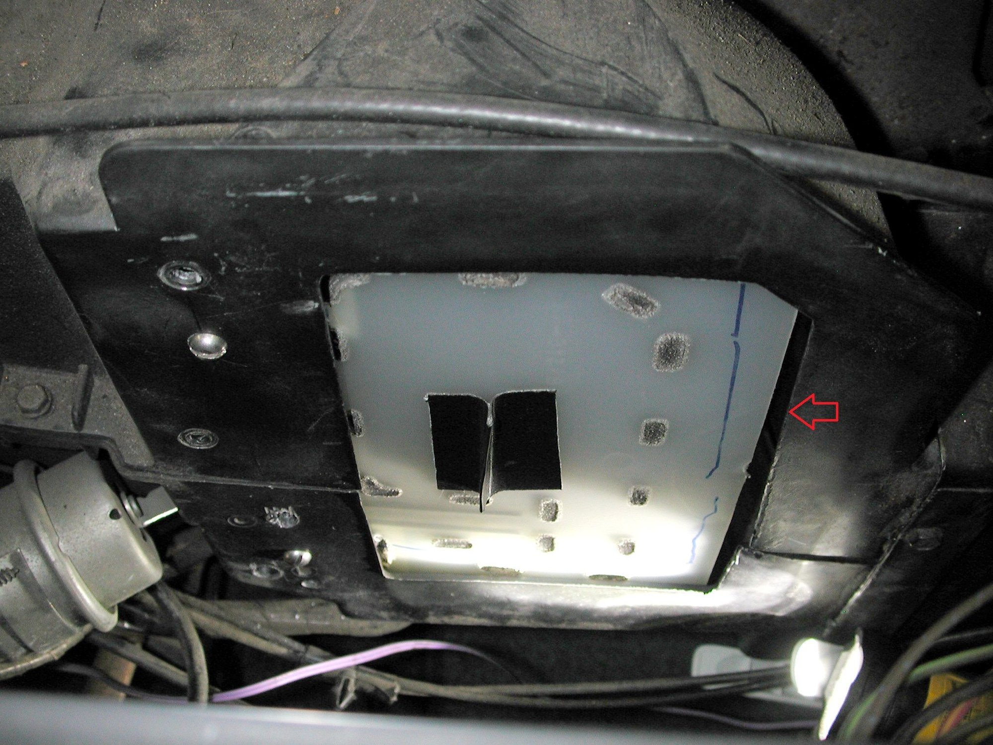

Well, this panel door thing isn't as easy as I'd hoped. But, I think I'm learning quite a bit.
Here's a really poor picture of the door with the hinges installed. Note that the pin on the hinge (red circle) is back, and that is causing the door to be too far to the rear, as shown in the next pic. To compensate for that I had moved the hinge further onto the door, and with that the door doesn't quite block the opening to the front.
Also, from this pic you can see that the door is warped - as shown by the red arrow on the right. I think I'm going to make an aluminum door and put the arm from this one on that door.

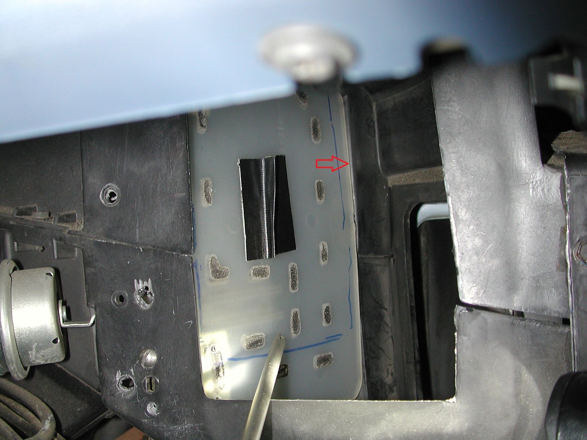

Here's a shot of the door in the rear position, and you can see that it just barely fits in the opening. But, I'm thinking that if I turn the hinge over so that the pin is forward in the above pic the door will move about 1/4" to the left in this pic.
And this shows that the door doesn't quite cover the front opening with where I have the hinge mounted, and that was due to it hitting the back when fully open. Again, I'm thinking the way around this is to move the hinge pin.

I don't think it will be easy to reinforce the hinge. While it is together I would see if you can lay a piano hinge, like Luke did, or a pair of hinges, like I'm doing, in and get them positioned so the thing operates. Then you know that bolting it into the duct will work.
But, I'll bet that you will find what I found - the offset on the hinge pin puts the pivot point at enough of a different place from the plastic hinge that the hinge won't function with both in place. If so, once you get the new hinge(s) positioned where you want them you'll have to cut the plastic hinge.
I didn't, initially, pay enough attention to where the hinge pivot point originally was. I thought I could compensate by moving the hinge and spacing the hinge from the housing. But for the door to cover the front opening and still fit within the housing when swung to the rear it needs to pivot pretty much exactly where it did originally. That's hard to measure on a door with a broken hinge, but with one still intact it will be easier.
And, with the housing out of the truck you can take the top off the housing and try your new door/hinge combo in the top and then the bottom. But with it in the truck it is extremely difficult. So, fix it now!

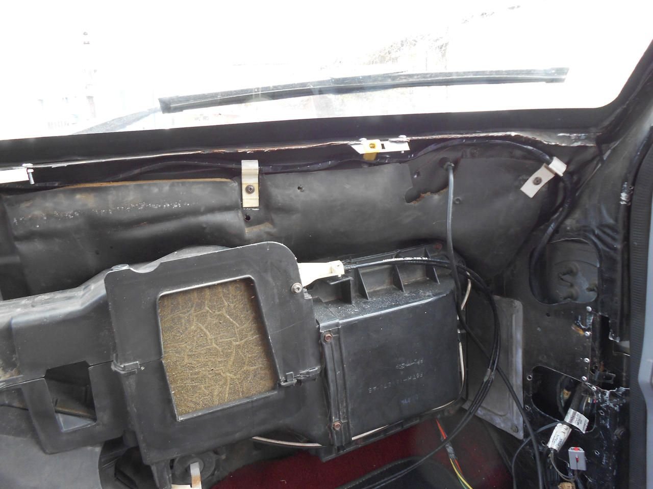

Gary, apparently Ford realized the "hinge" was a weak spot, my 1996 casing appears to have a shaft on the mode door. You can see the actuator attaches to the shaft underneath.
