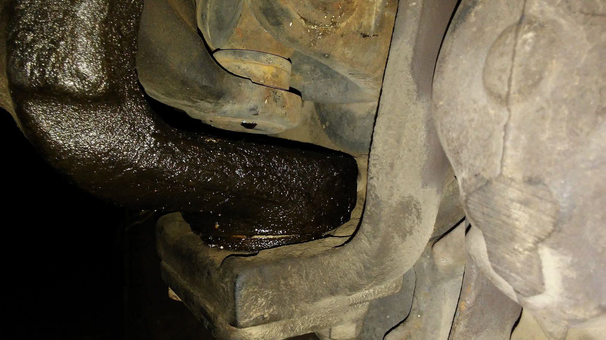

I'm not sure where it's leaking. A couple years ago I did the diesel o-rings re-seal kit and that fixed it for awhile but it's gotten worse.
Oh, and look at what I found tonight. It never ends, does it!
