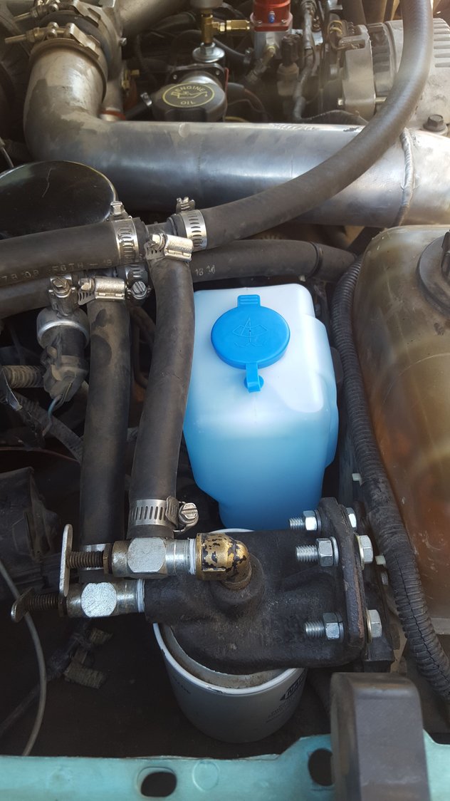

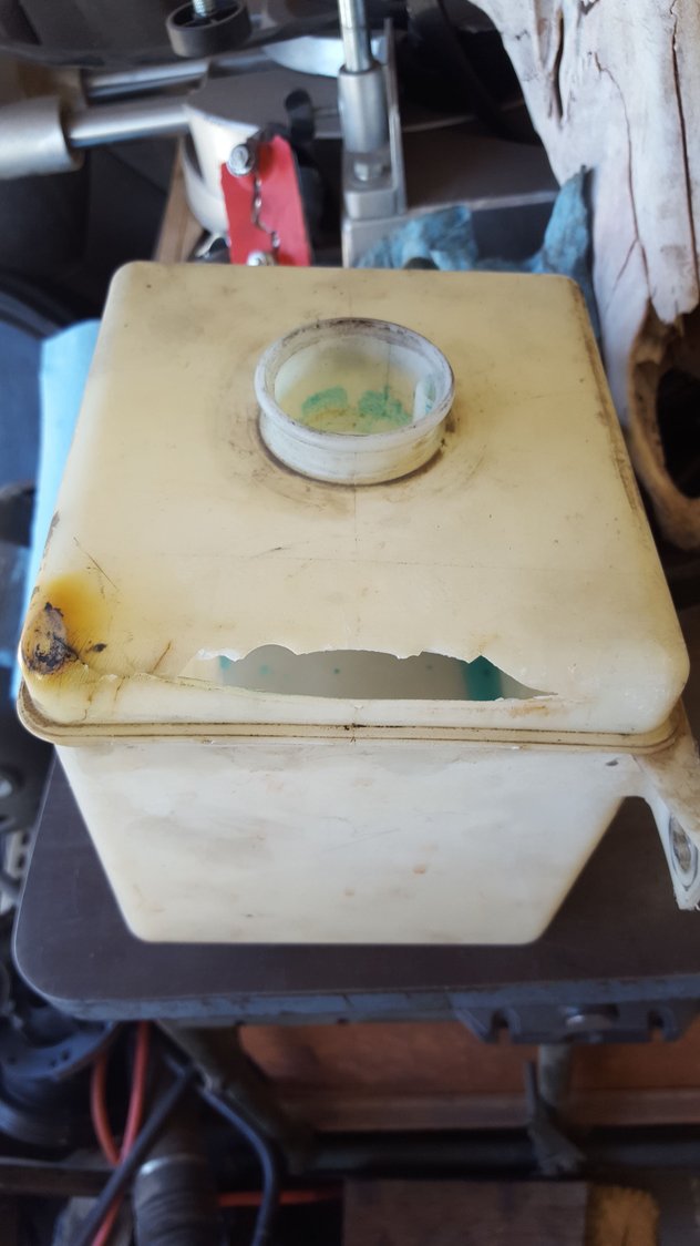

A couple weeks ago I noticed a crack in my washer fluid reservoir. Of course, I had to touch it and sure enough it caved right in. As many of you probably know, no one makes any aftermarket replacement for the diesel, only the gas versions. EBay and junk yards have some used ones available but how long will 20+ year old plastic that's been baking in the sun last. So I really wanted find something that was new. What I found is this
universal kit universal kit

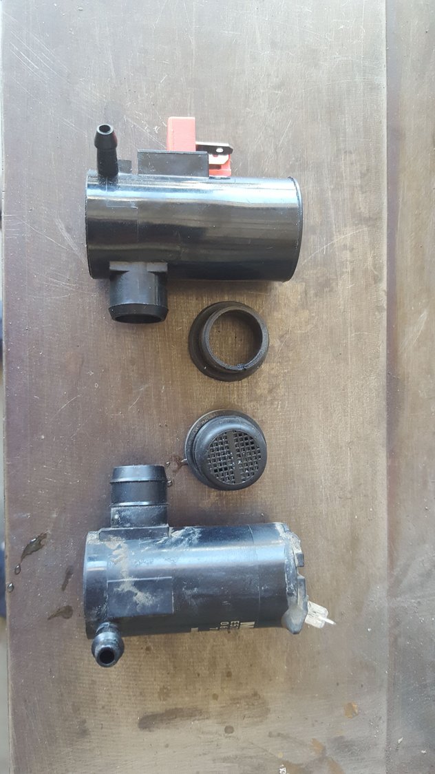

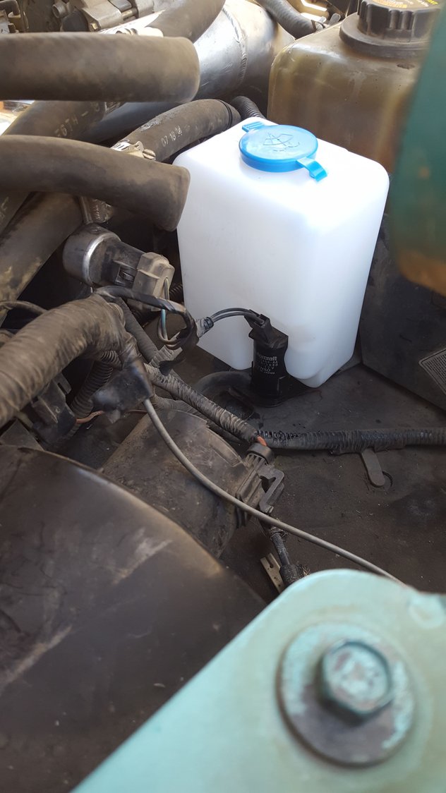

. It's about half the size, but fits perfectly and the pump even had the same plug. And you can even swap your oem pump into this reservoir. The oem pump has a screen over the suction, so I swapped both onto the new reservoir.
The bracket is simple and really only requires one hole drilled. Just be careful to not add a vent to your coolant bottle, if you don't move it.
This actually fits better for me since the coolant filter lines rubbed on the oem reservoir.
