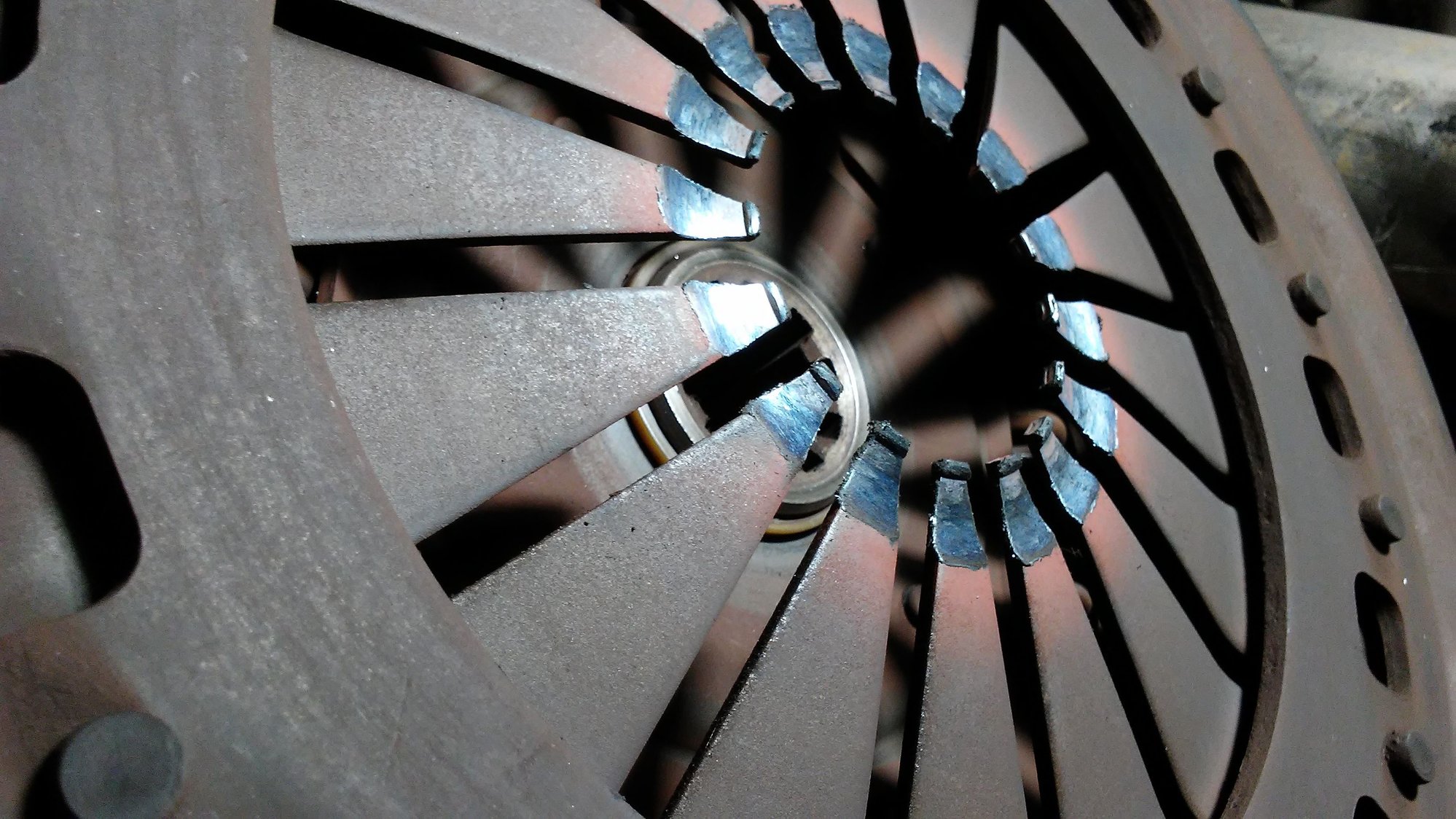

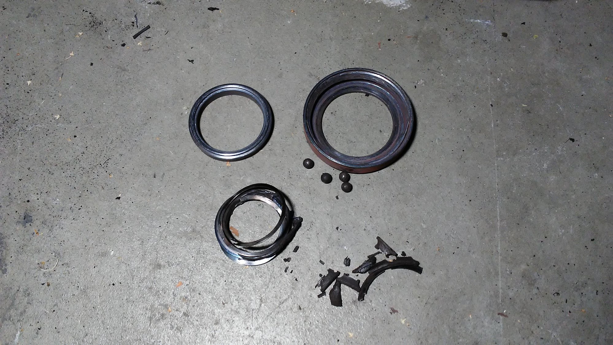

Well, last week my throw out bearing 'threw out'! Finally got the trans out last night and it looks like I have a few other things that will need to be addressed.
Current plans:
DONE - New throw out bearing
DONE - New clutch fork
DONE - New clutch
DONE - New rear main seal
DONE - DIY bellowed up pipes
DONE - Turbo pedestal O-rings
DONE - EBPV delete pedestal
DONE - Replace orange turbo intake boot
DONE - Efuel
DONE - Stage 1 injectors
DONE - Finally finish the IC (just need pipes)
DONE - Replace damaged tailpipe from last months blown tire
DONE - Need to look into new tunes for the Stage 1s
DONE - And any other oil leaks I can find/fix at this time.
Wow! That list is longer than I thought.
The big black spot on the drivers up pipe is a grease spot from my gloves when I was trying to get the upper trans bolts, but there is definitely some leakage on both sides of the collector.

It really didn't sound bad at all until the very end. We were in Hell's Canyon when I noticed the shifting wasn't quite right, then a little chirp like you hear when you have a dry bearing in your accessory drive but coming from the trans. We made it back to camp, let it sit for a couple days, then hooked up the trailer and headed home. As I was parking the trailer was when it really started making awful noises.

Well, the clutch is a definite need. The disc is almost down to the rivets. Clutch and flywheel are off, fuel bowl is out (for good), and I'm working on pulling the up pipes and turbo. Any tricks on getting the bottom nuts on the turbo/collector flange?
