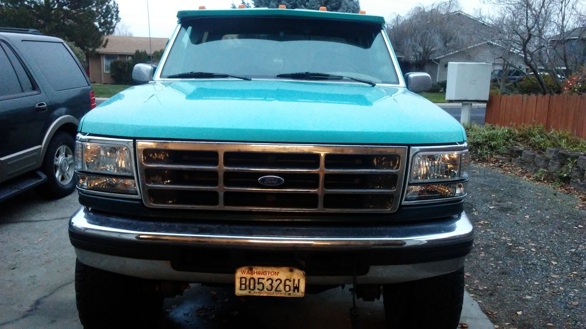

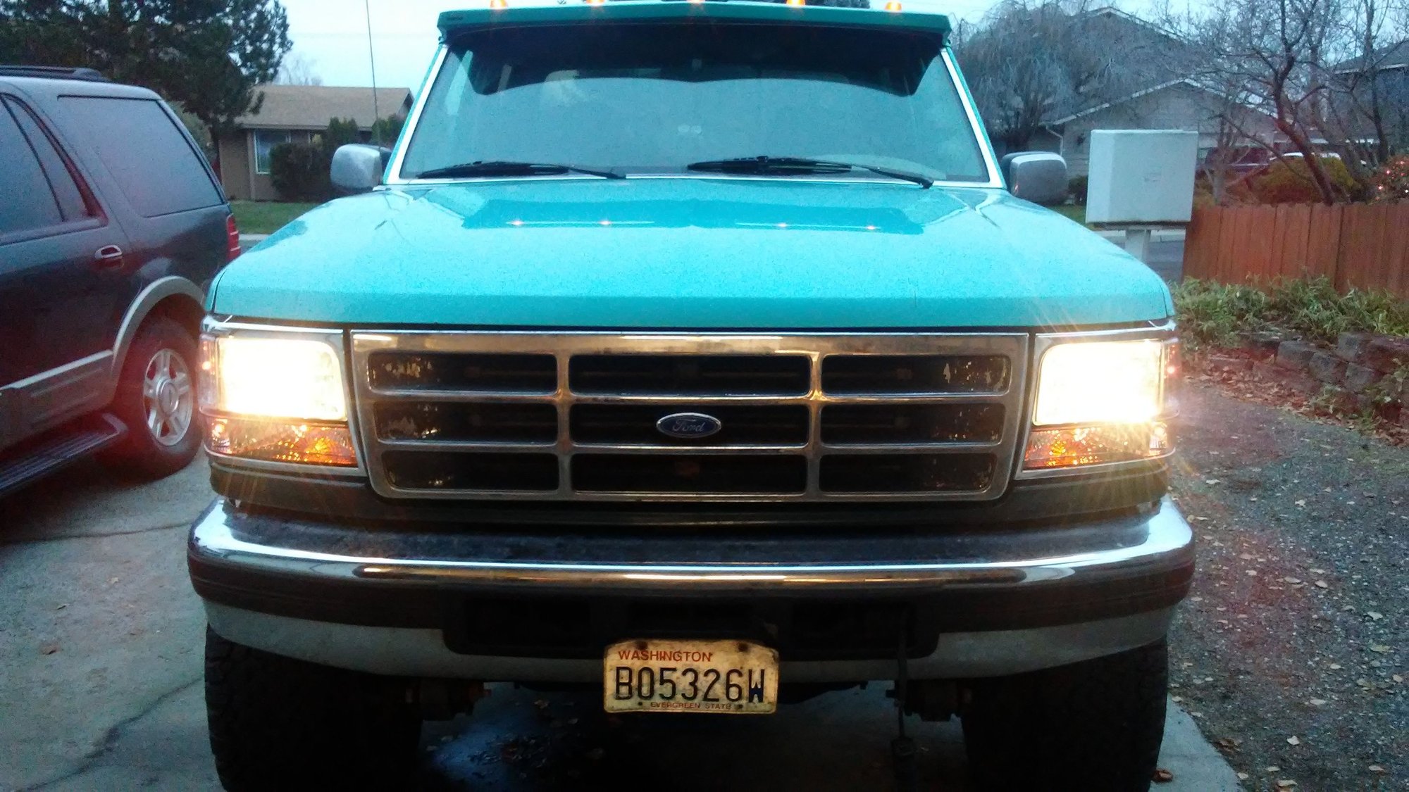

On a more positive note, last month I got new clear headlights. Thankfully they weren't damaged the other day.
