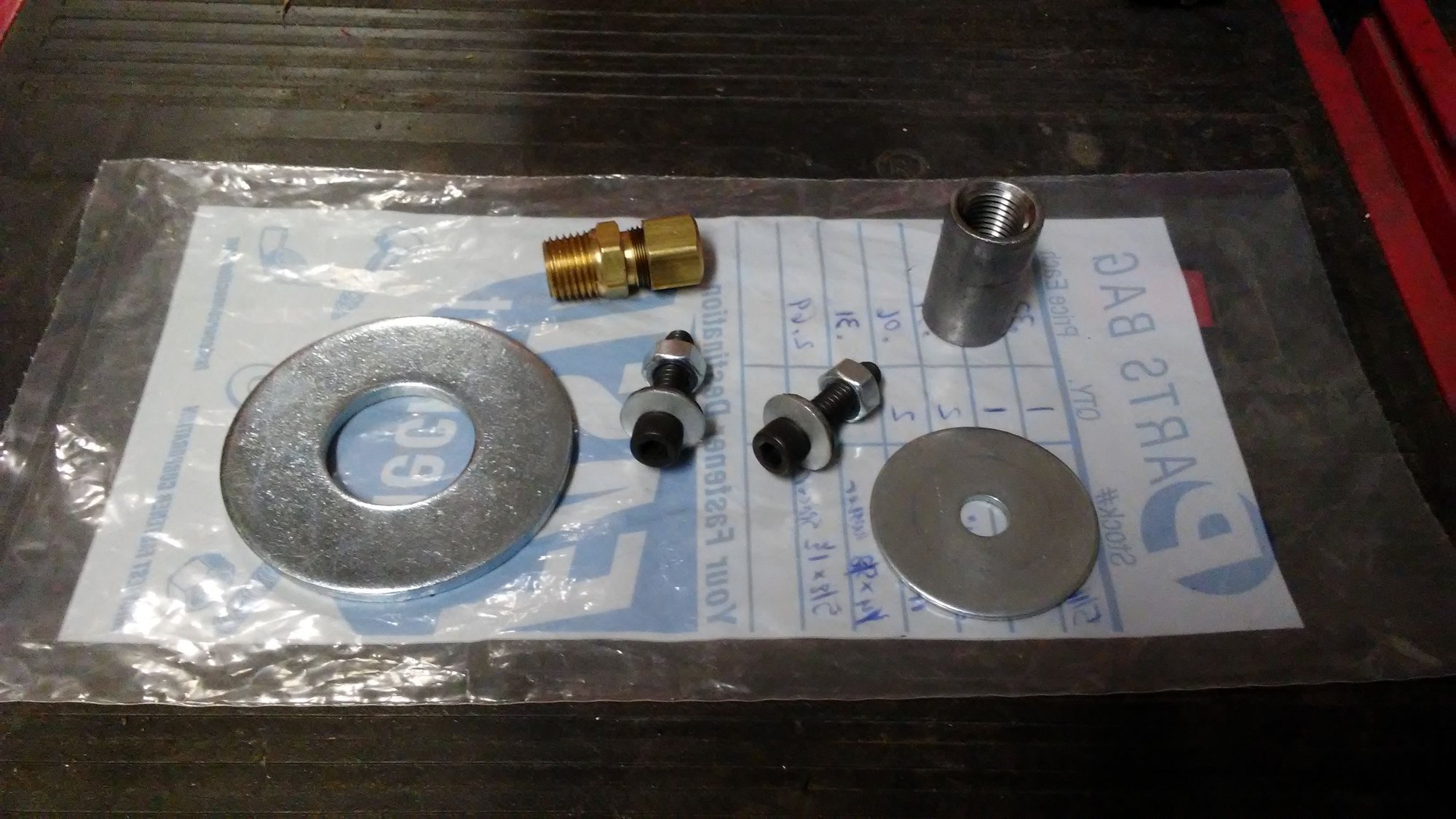

Time to bump this back up; it's been awhile. Apparently you can't edit your posts after a certain amount of days, so here's an edited version of the first post. The only thing I haven't finished from the original plan is replacing the last exhaust bend in the tail pipe. I also haven't finished a couple things that came up during the build such as the getting some kind of filter on the CCV and dumping it back into the intake and the permanently fixing the dipstick adapter. The dipstick adapter is the one I'm working on right now; hopefully I'll be able to tackle the others soon.
I know about the Strictly Diesel adapter, but for that price I just feel like I've got to give DIY a try first. If this utterly fails, then I'll go buy one. So here goes nothing...
Parts List:
1 - 5/16" x 1 5/8" fender washer
1 - 1" flat washer
1 - 1/4" NPT female coupler
1 - 3/8" compression x 1/4" NPT fitting
2 - 1/4"-20 x 1" allen bolts
2 - 1/4"-20 nuts
2 - 1/4" bonded sealing or hard fiber washers
Some felt gasket material
My EBPV valve (or whatever scrap you have for a backing plate)

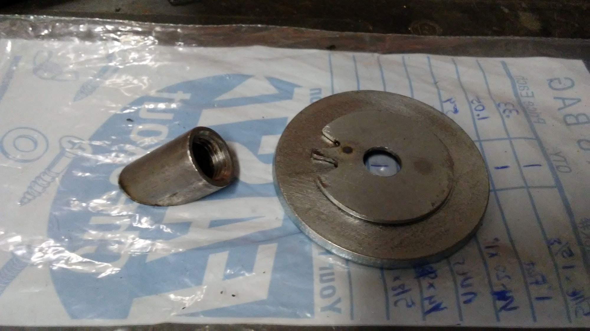

Cut some 'V' notches in the fender washer, tacked it to the larger washer, and cut the coupling for roughly a 35° angle.
Using a drill and dremmel, I opened and elongated the hole in the fender washer and welded it together so the coupler would be about 10° off vertical with the first notch. If ever I decide to use a SD dipstick, I should be able to rotate it to the second notch and have it line up.

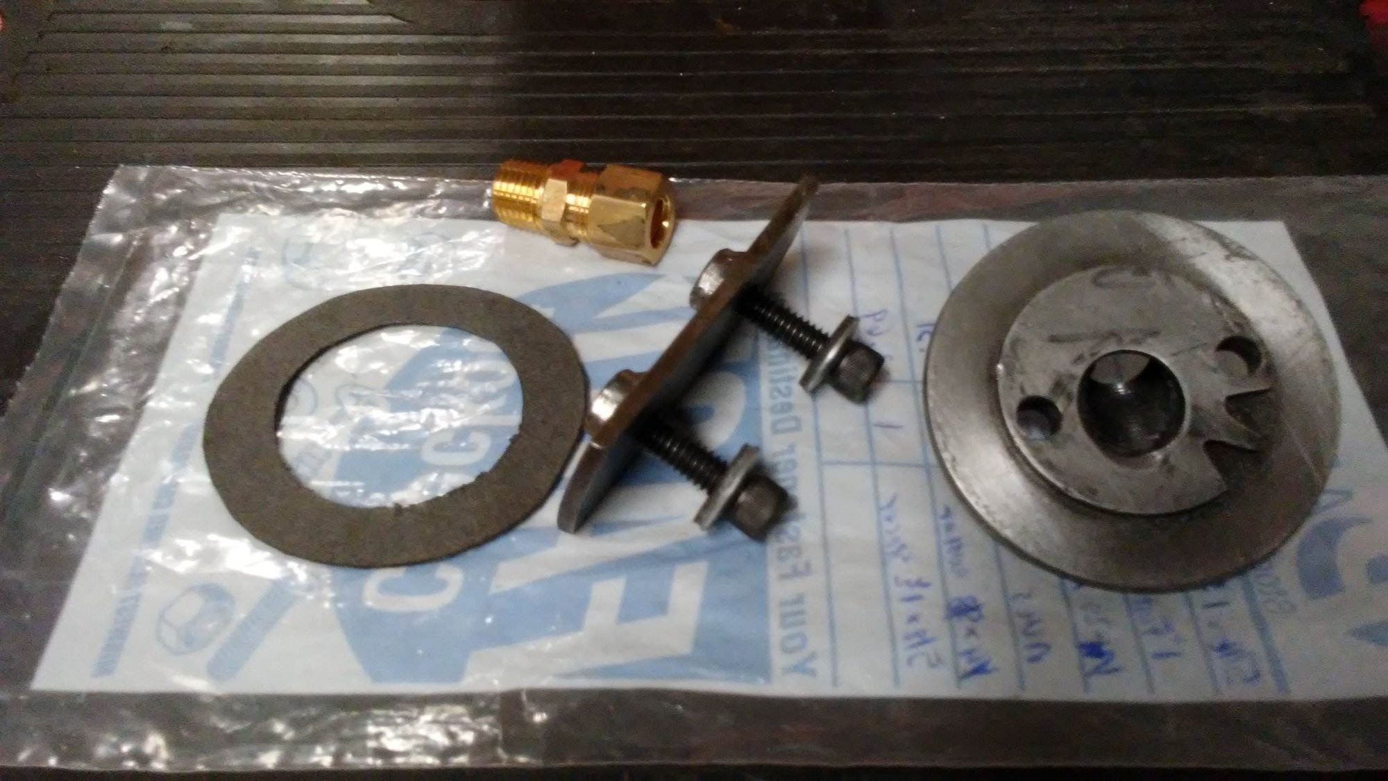

(I realized shortly after taking the above pic that I needed to drill/cut a hole in the backing plate for the dipstick to come through.)
Then I ground some flat spots on the outside for the washers to seal.
I still need to finish the backing plate and get everything painted, but I think it's going to work out fine. Once everything is done, I'll put a tack weld on one of the bolts so that I can't accidentally drop the backing plate in the oil pan. Then I'm going to drill a hole in some sheet metal and dry fit everything. When I do put this in, initially I'm going to use a 1/4" plug in the adapter until I know it's not leaking; then I'll cut my dipstick tube to length and put in the compression fitting. This way if I utterly fail I can buy the Strictly Diesel adapter and still have my dipstick tube with the o-ring crimps.
