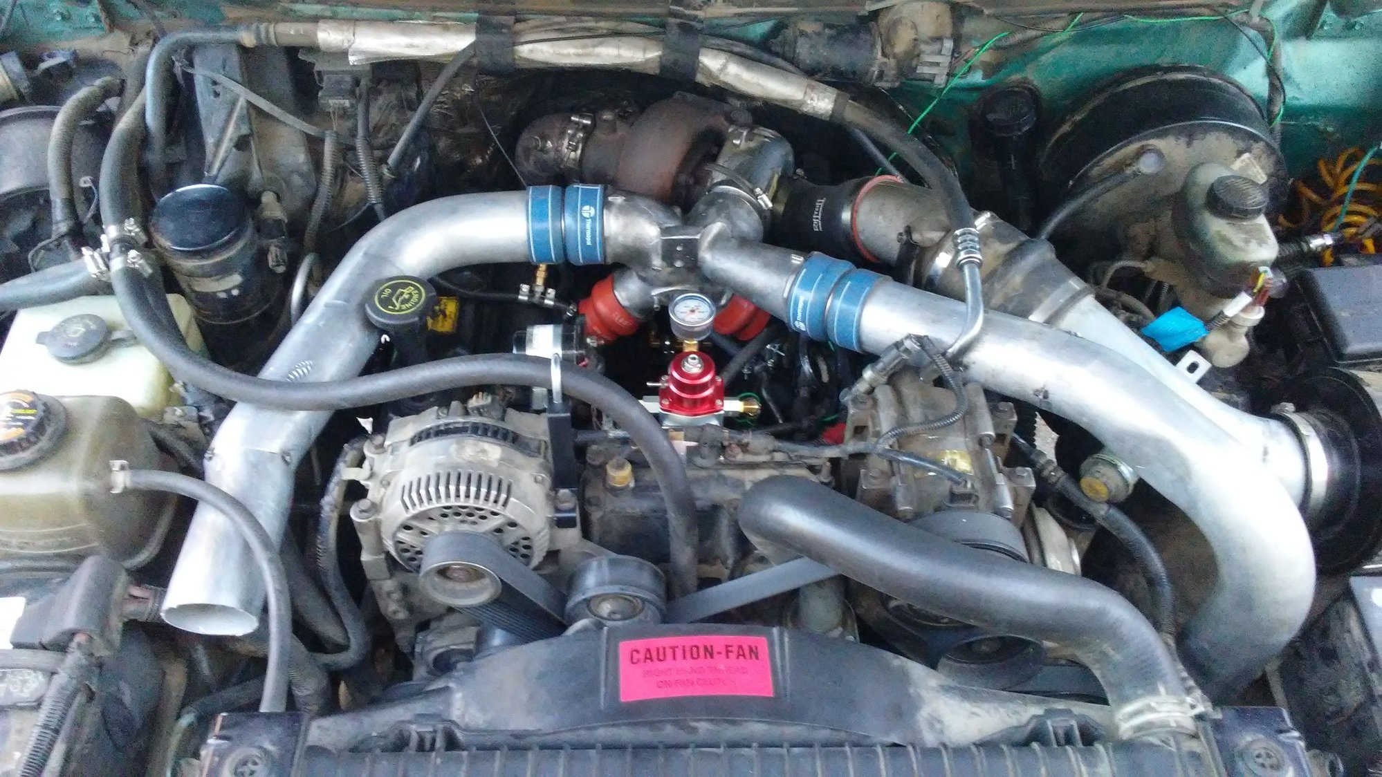

Well, got the clutch bled so I could take it for a drive. Aaaawwwweeesome! Two things I know... 1. I need get the IC pipes done now and 2. I need to get my chip reburned for the new injectors to clean up the smoke.
I forgot to have Jim throw one of his heater hose brackets in with the injectors, so... DIY bracket. It's not as cool, but it will do what it's suppose to.

Started working on the IC pipes today. I'm starting with a set of '99 aluminum pipes. I got the passenger pipe cut up and started, and used a 3 inch piece from it on the drivers pipe. I just ordered a 2' 180° bend to finish the passenger pipe. I'm just getting them tacked together with my mig welder and then I'll take them to a guy at work to tig them up for me.

I'm also going to need to modify the AFE box that goes around the air filter so that the IC pipe will fit. Gonna make some calls in the morning and hopefully have my chip in the mail for a reburn. I originally bought the chip from Power Hungry so I'll give them a call first but I think I'll call Gearhead too.

Thanks. I had the ubolt hanging around from a steering stabilizer kit. I used nylock nuts so that they wouldn't loosen up since you can't tighten them too much without pinching the hose. It does a really good job of keeping the hose away from the idler pulley and off the alternator.

Yep, I've had the intercooler for about 3 years and it has been mounted on the truck for about 2 years, just no pipes. I'm working on the pipes now.
